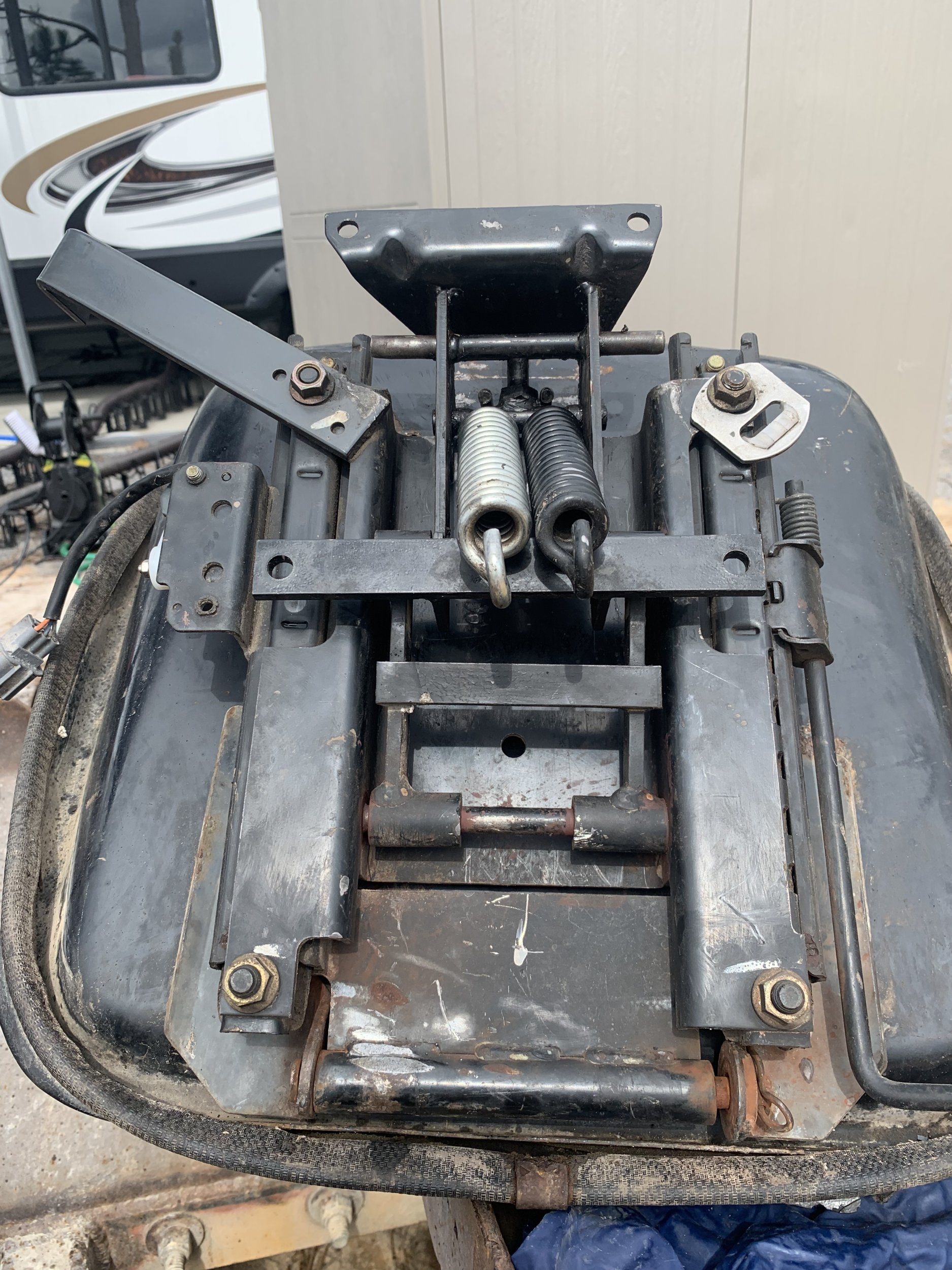

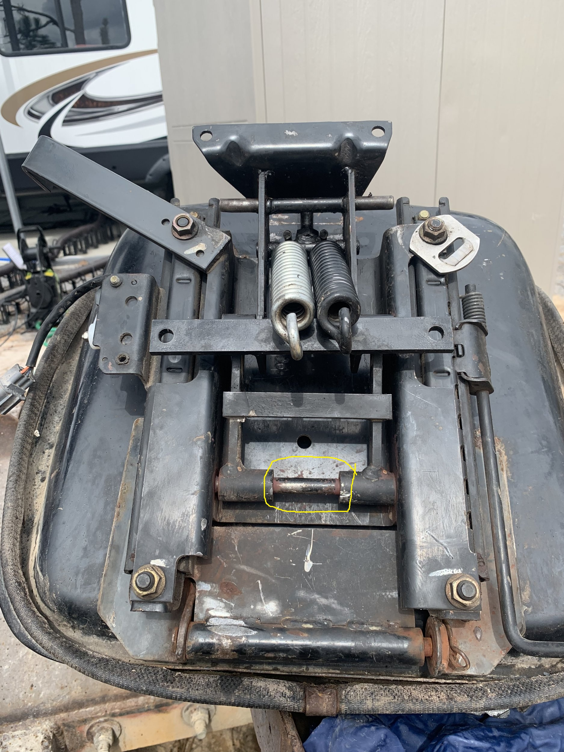

When I bought this tractor a month ago the seat was all floppy and didn’t seem right. So I finally took it off to see what’s wrong and the springs for the bolt are not connected and maybe missing parts? Anyone have a picture how all of this goes so I can tell if I am missing something or not?

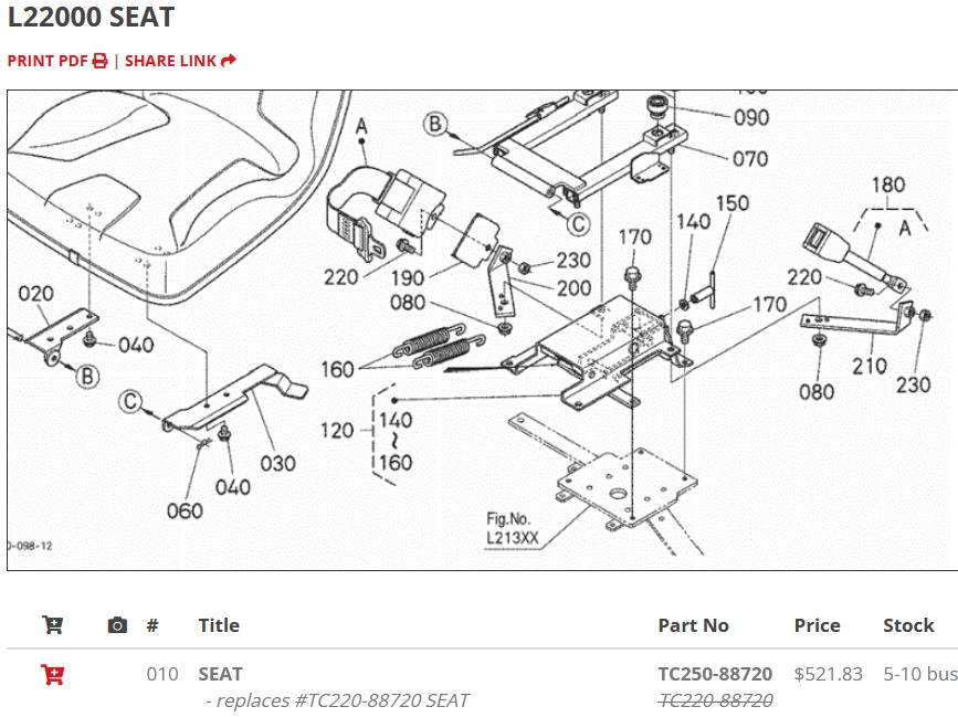

go to Messicks.com and click online parts then Kubota and enter your model number. Click on Parts Catalogue. The exploded diagram for the seat along with a full parts list is under Hood/Bonne.
Messicks tractor site simply has the best online parts access that I've ever seen.

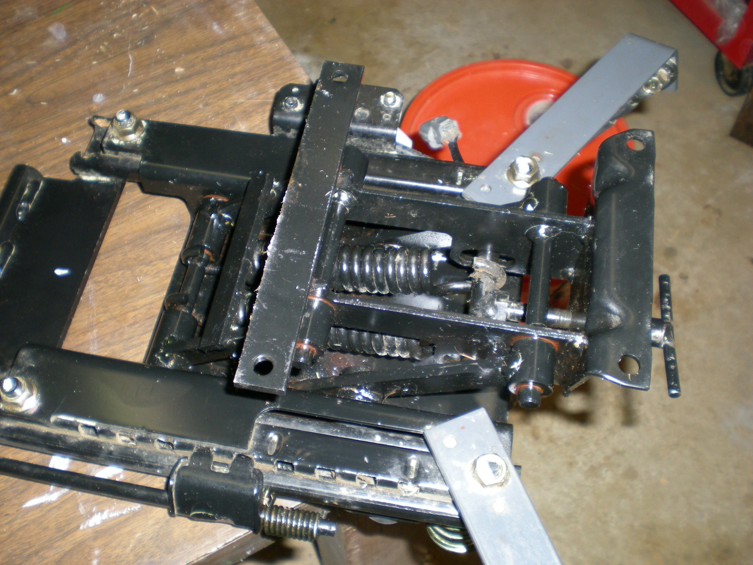

your photo is the second one... mine is on the left. Messick or the parts diagram is of little or not use...
