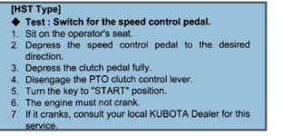

Allright here is what I have been able to dig up by myself about testing the neutral safety switch.. the Tractor will NOT crank if the peddle is not centered, or of course if the switch is defective.. It has nothing to do with the fuel system, it just prevents the tractor from cranking. So your problem with the Neutral safety switch is solved.. now on to fixing the problem of the engine not starting/running.

That is not what the owners manual suggests. It says if you press the treadle pedal any direction but nuetral the tractor will not crank. According to the owners manual. All 3 safety switches Clutch, PTO and Neutral pedal just prevent the tractor from cranking.. NOW the seat safety switch prevents shuts off the fuel solenoid, and would prevent the tractor from running.. Can you wire around it to see if the fuel solenoid can be pulled in? did you perform the fuel solenoid test I spoke of in the last post?
