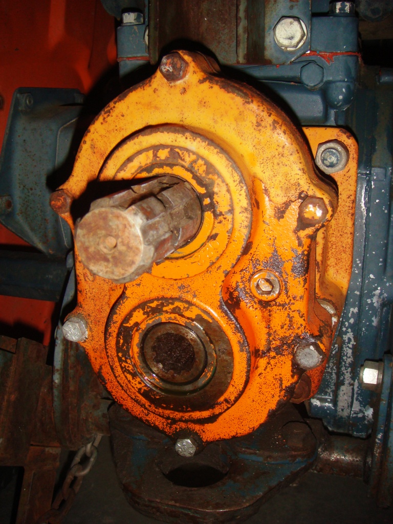

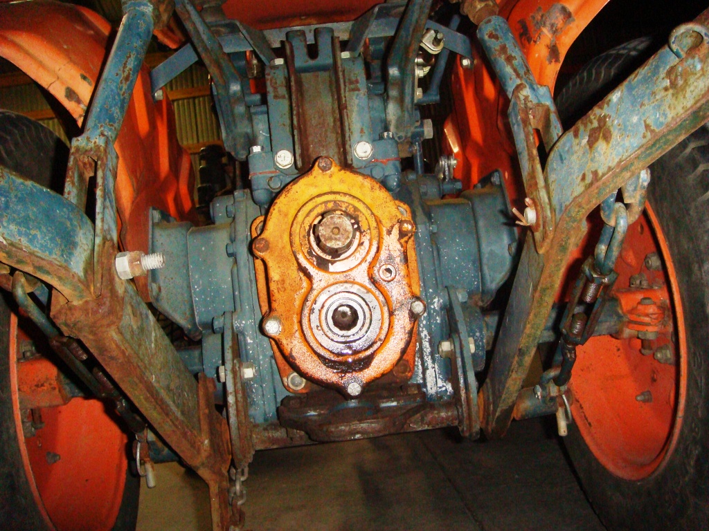

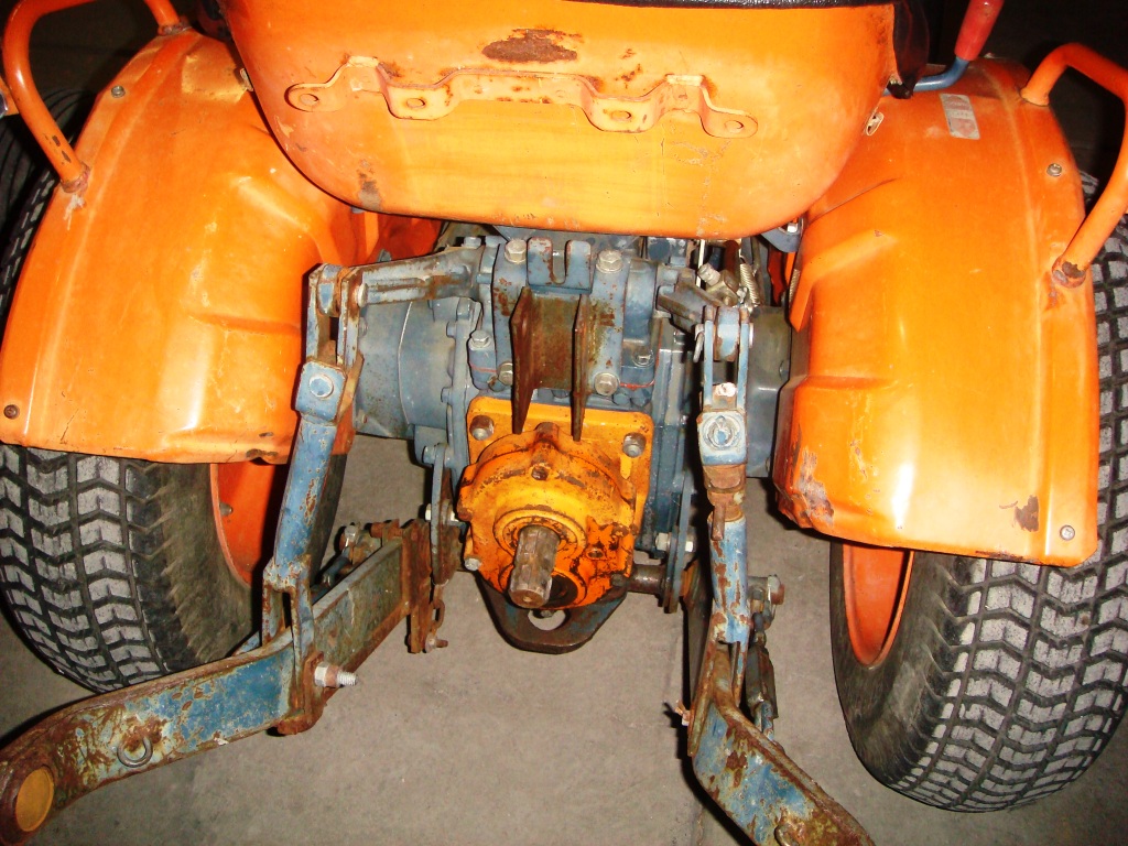

Welcome Cress.
I believe that the gearbox in the attached pictures is what you need. I'm not completely sure of my facts, but I believe that my reverser in the pictures is a factory Kubota part. There was also another common PTO reverser for the B6000 made by a company called Hub City. They appear to have sold for about $500 until they stopped making them in the 80's. Used ones I've seen recently sell for $7-800.
The alternative to finding a PTO reverser is to find implements that were designed specifically for the B6000.
I just picked up this little B6000E. Were it not for the reverser, I probably wouldn't have bought it.
