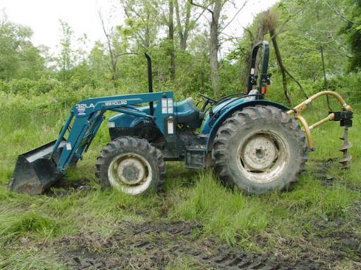

   / jx95-New Holland loader #4
Don't quite understand the price difference. It might be that the NH dealer has an older 32 LA loader that he wants to get rid of. It was a good loader too, but doesn't have the curved arms of the 32 LC. In any case, if the NH dealer is going to install it and make sure everything works, I'd go with the $1K savings. Will look a bit odd, though, red with that bright blue loader. /forums/images/graemlins/smile.gif
   / jx95-New Holland loader #5
There really is not much different between the 32LA and LC loaders. The main difference is the bracket where the loader mounts to the tractor. Here is a pic of my TN w/32LA
   / jx95-New Holland loader #6
And Rowskis TN with 32LC, also the LC has larger supports at the bend and has a tube cross brace while the LA has a square brace. The angle of the arms is almost the same if not the same.
