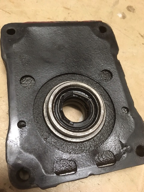

It looks to me like the large oval seals must be leakng. Should be within my capabilities to change them. It looks like all I have to do is remove the radiator shroud, and maybe the radiator inorder to get the 4 bolts that hold the pump inplace out.
   / Jx60 using power steering fliud
Well I have found at least part of the problem. I removed the power steering pump and this seal was damaged.
#9
I found a replacement pump from Bepco, his tractor isbackupand running.
