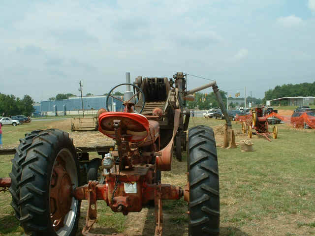

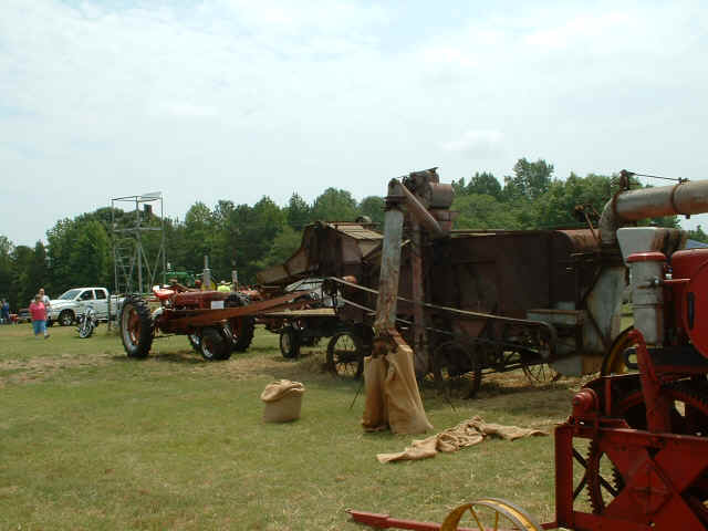

Well, you might want to run a thresher.
Wm
