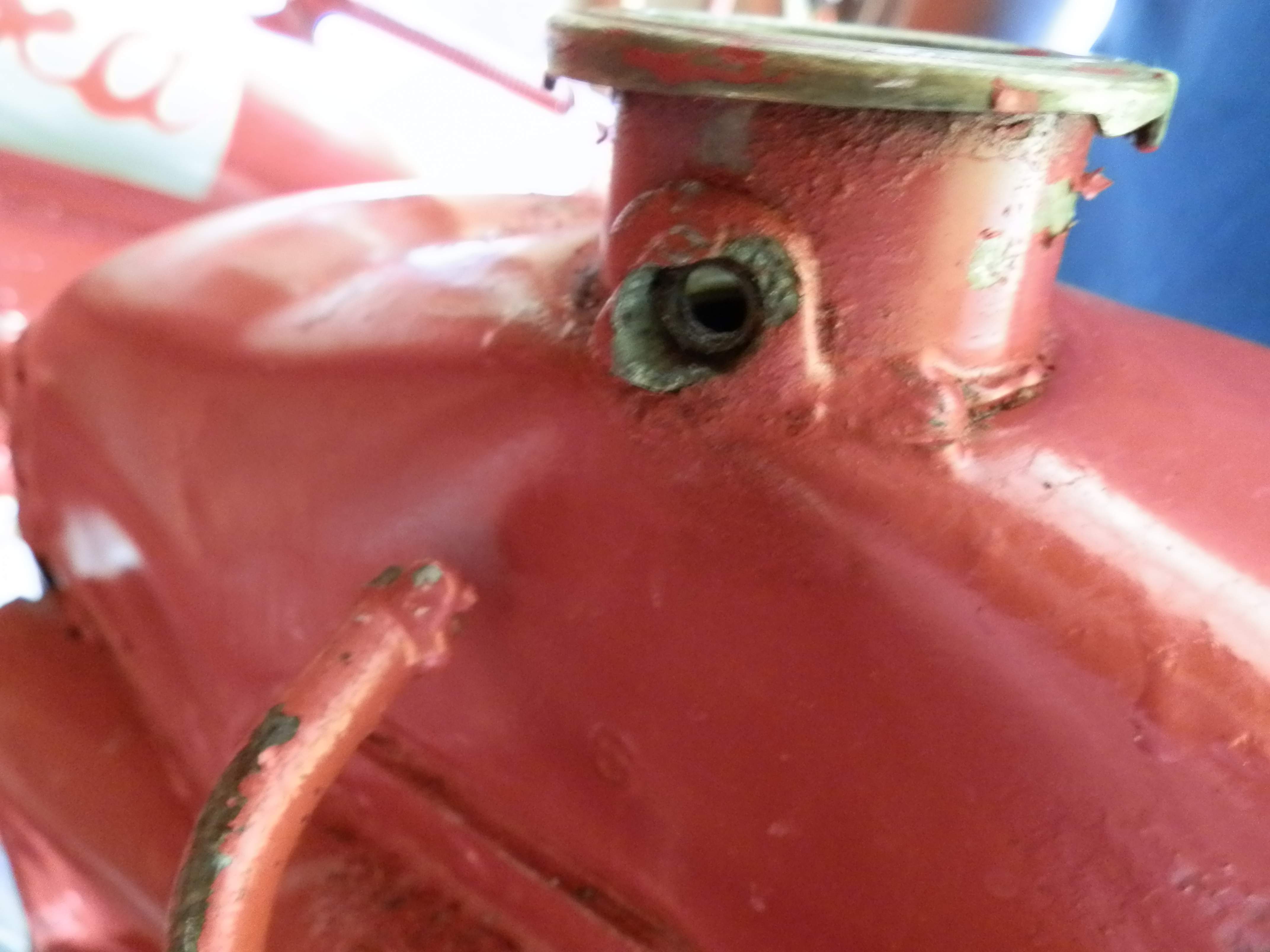

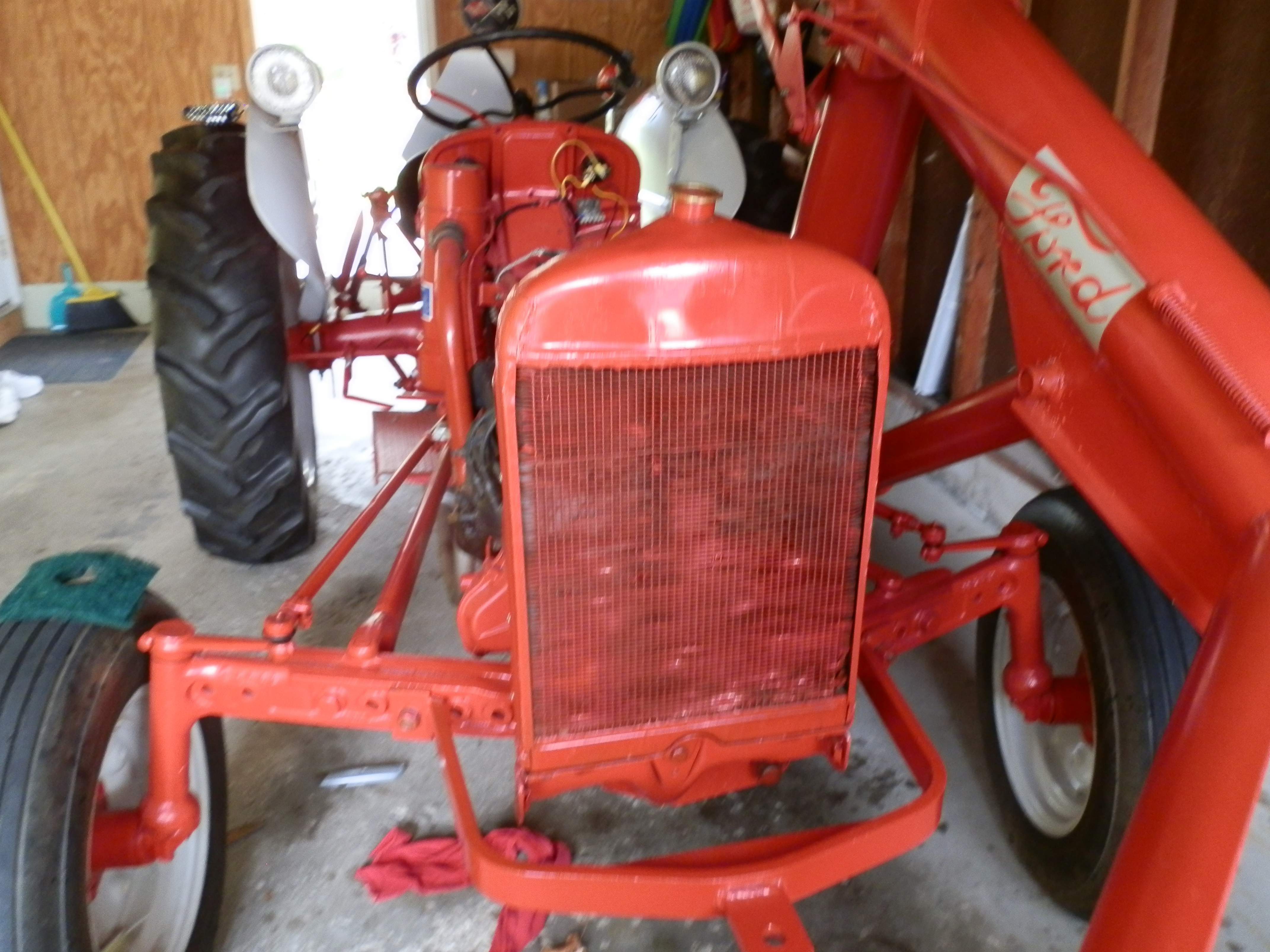

With my wifes help we removed the hood today. Was not an easy process as she is not that strong and having to work around the loader made matters even worse.
When it goes back on I will have to recruite some stronger help but I truly appreciate all she helps me with. 20 years and going strong!
Anyways,here are a few pics of what I am dealing with as far as the radiator goes. The two questions are..Take this one in and have it rebuilt or just order a new one and save the hassle of running around getting this one in shape?
Secondly,what is my next step in determining the status of the cooling system?
I have ordered the upper and lower hoses and T stat from Just8Ns and I will either have a new or rebuilt radiator soon so what is next?

almost looks like someone jb welded the overflow on. if it is instead a bad solder job.. I'd just clean it up and resolder it.
it only functions when she is venting anyway.
plumbers soldering kit will do it.
   / Just want to be one of the COOLing kids.. 8N
Thanks Soundguy and everyone else.
I am either going to have this radiator repaired or replaced with a new one since I have taken the time and effort to pull the hood off I want to get the cooling system in 100% shape.
