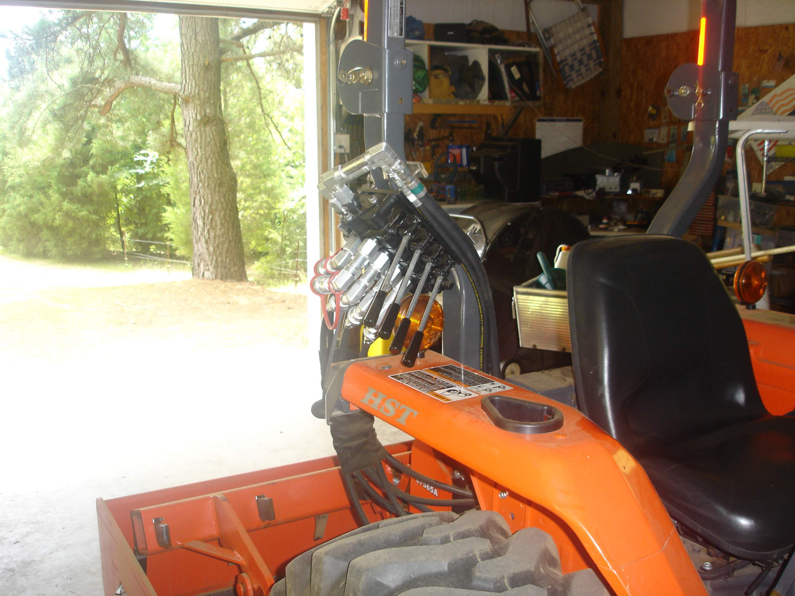

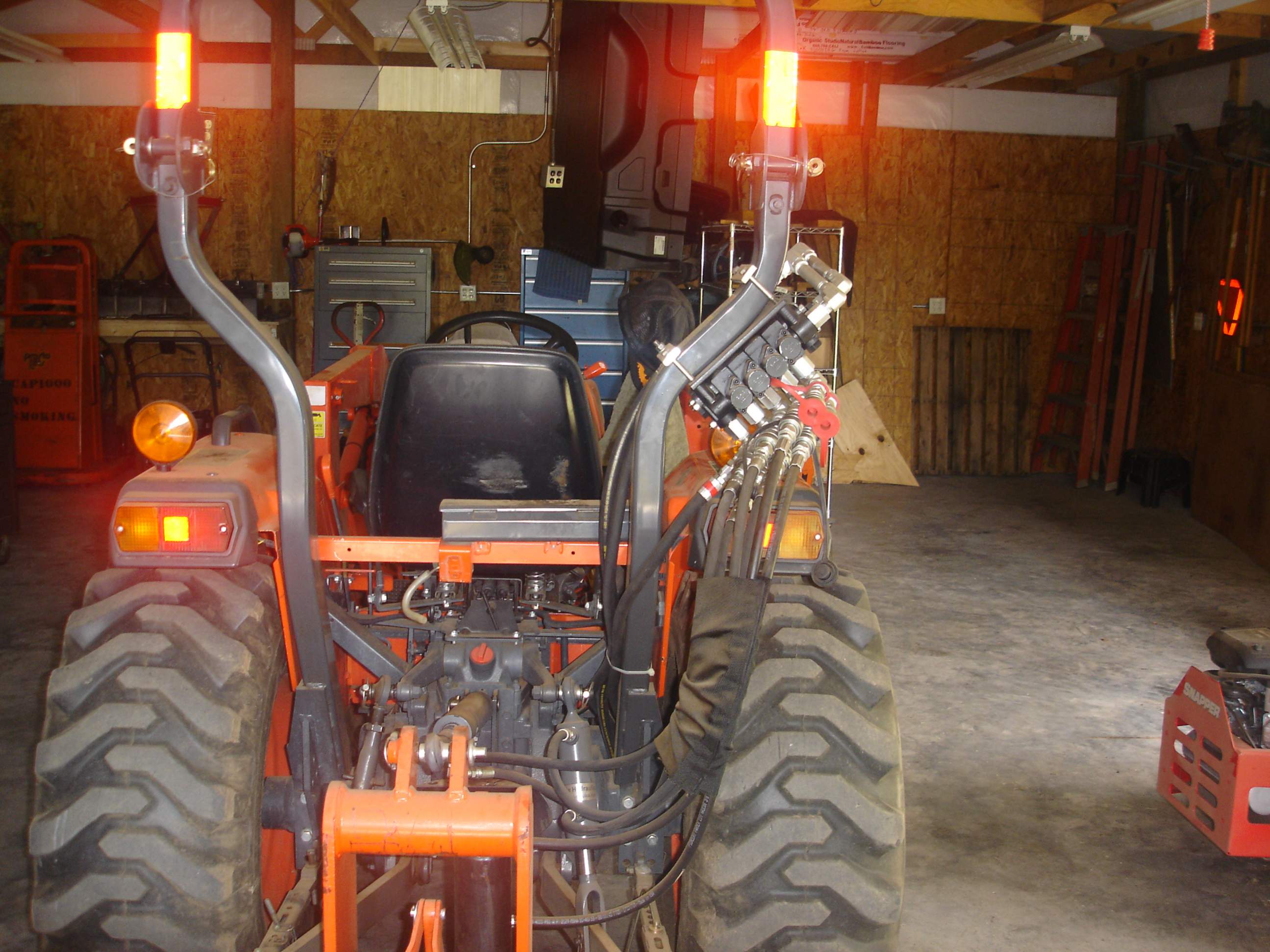

Here is a picture of my three remotes.
TripleR,
Do you have hose covers on the hoses to your tilt cylinder? The hoses look like you have some pretty tight bends. Especially the top hose. Or is it just the angle on the picture?

Don't have 10 female connectors but I got 8. 2 for top link, 2 for side tilt, 2 for box blade rippers, and 2 for... nothing yet, spares.
