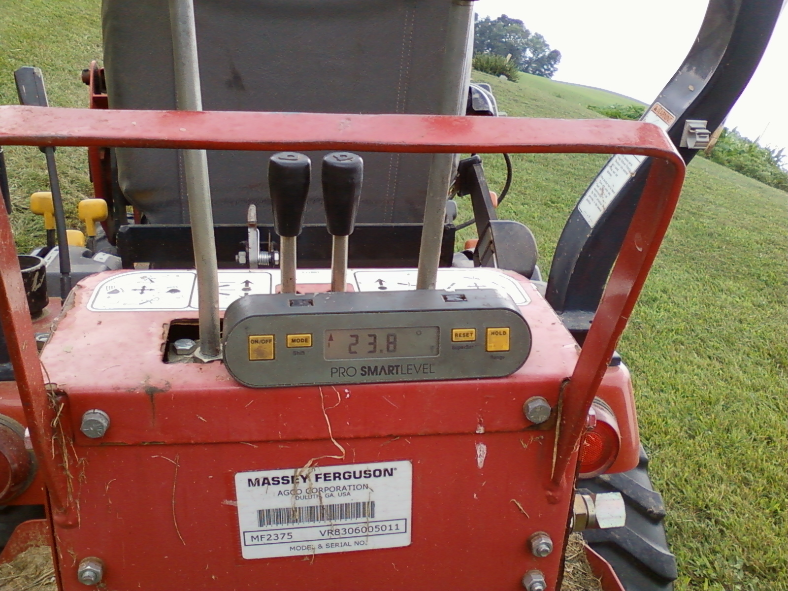

I mow steeper then this without a problem and if I think there will be a problem I swing the BH to counterbalance the tractor. Just be careful.And when you are on a bank put it in 4WD because the first time you find out you have no brakes because the rear tires are sliding you will make sure you have it in 4WD the next time so you have front braking.
Doug
