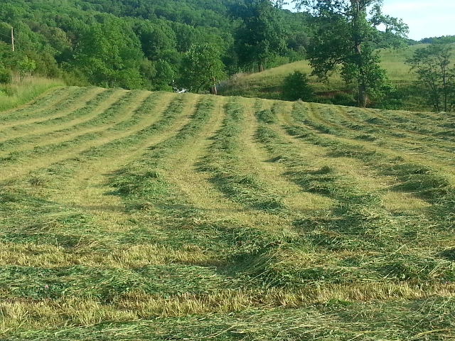

Mowed 20+ acres this past weekend, and it preformed flawlessly. I couldnt have been happier. Felt of the disc when finished and all were cool. Not even luke warm. The only thing it needs is a new set of blades which shouldn't be too difficult.
   / just purchased a New Holland 408 discbine. #10
Looks like it's working just fine.
