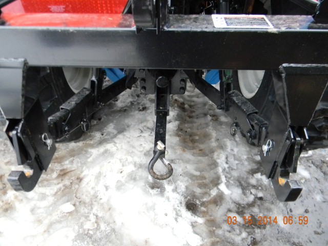

I drilled holes in the brush guard for the D-rings or they could be mounted to the frame right behind the guard. The twisted clevis in back is in the drawbar.
I welded a 2"x2" angle to the top of the bucket for extra strength and welded grab hooks to that. Also drilled and bolted tow hooks on the bucket.
