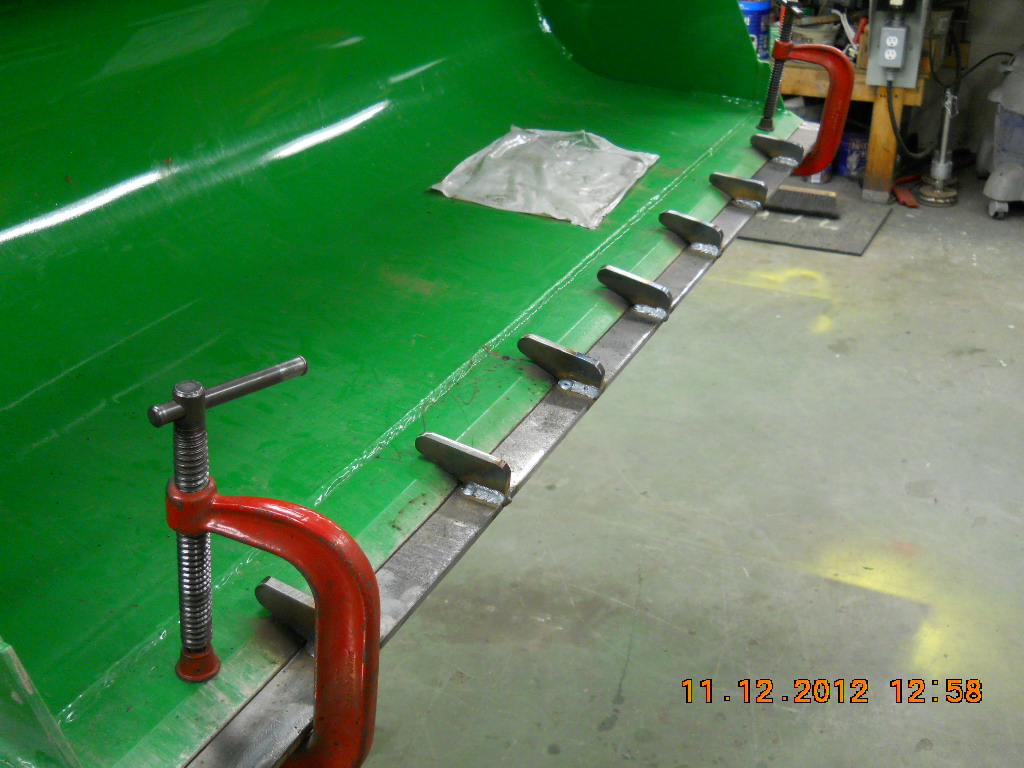

Decided to fab up a sacrificial wear bar for clearing snow this weekend.

View attachment 288398View attachment 288399View attachment 288400View attachment 288401View attachment 288405View attachment 288416 new tractor 384.JPG

Nice looking work BIG DOOLEY !

I put the ends on tonight, drill all the holes for the bucket and primered the top side.

THE WELDS LOOK GOOD. WHY NOT JUST DRILL HOLES IN BUCKET AND MAKE IT SO ITS REVERSIBLE AND REPLACEABLE.?
   / Just playing with the welder today
my thoughts were to only use it only when plowing snow not when working in dirt etc.
I do so much plowing for myself and other neighbors I would wear the edge very quickly.
It can't be reversed. the tabs allow the cutting edge to come in from one side only.

I think that when it starts showing signs of significant wear i could tack weld a new skin to the bottom
or
I could tack a second skin now and when it gets thin grind off the thin layer and tack on a new strip.
this is only 3/8" thick, the one I saw on-line was 5/8" thick.
Thanks for the thoughts .
I think i'll add 1/4" skin to the bottom and maybe replace it every year.

OH OK. YEAH THAT IDEA SOUNDS LIKE IT SHOUYLD WORK WELL AS WELL
