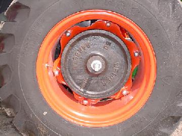

I copied the "easy weight" mounting system and added olympic weight plates on the rear wheels. Ive included a picture. If anyone is interested, I'll explain how it is done. It's really simple and not expensive at all. Besides, it looks good. My 5030 never got light in the rear, even when moving round bales on the spear. My previous 3710 did and I had to add rear ballast. I'm not saying that the 5030 can't lift the rear tires off the ground, it can. It's just that the 5030 and all the new L's are better balanced and use the new single point mount which distributes the weight on the loader much better than the old style.

"I'm not saying that the 5030 can't lift the rear tires off the ground, it can. It's just that the 5030 and all the new L's are better balanced and use the new single point mount which distributes the weight on the loader much better than the old style."
Daryl, it sure seems that way. Thus my hesitation to add liquid ballast. Rat...
