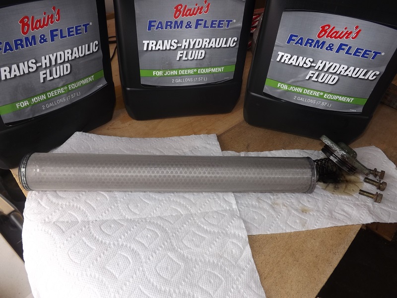

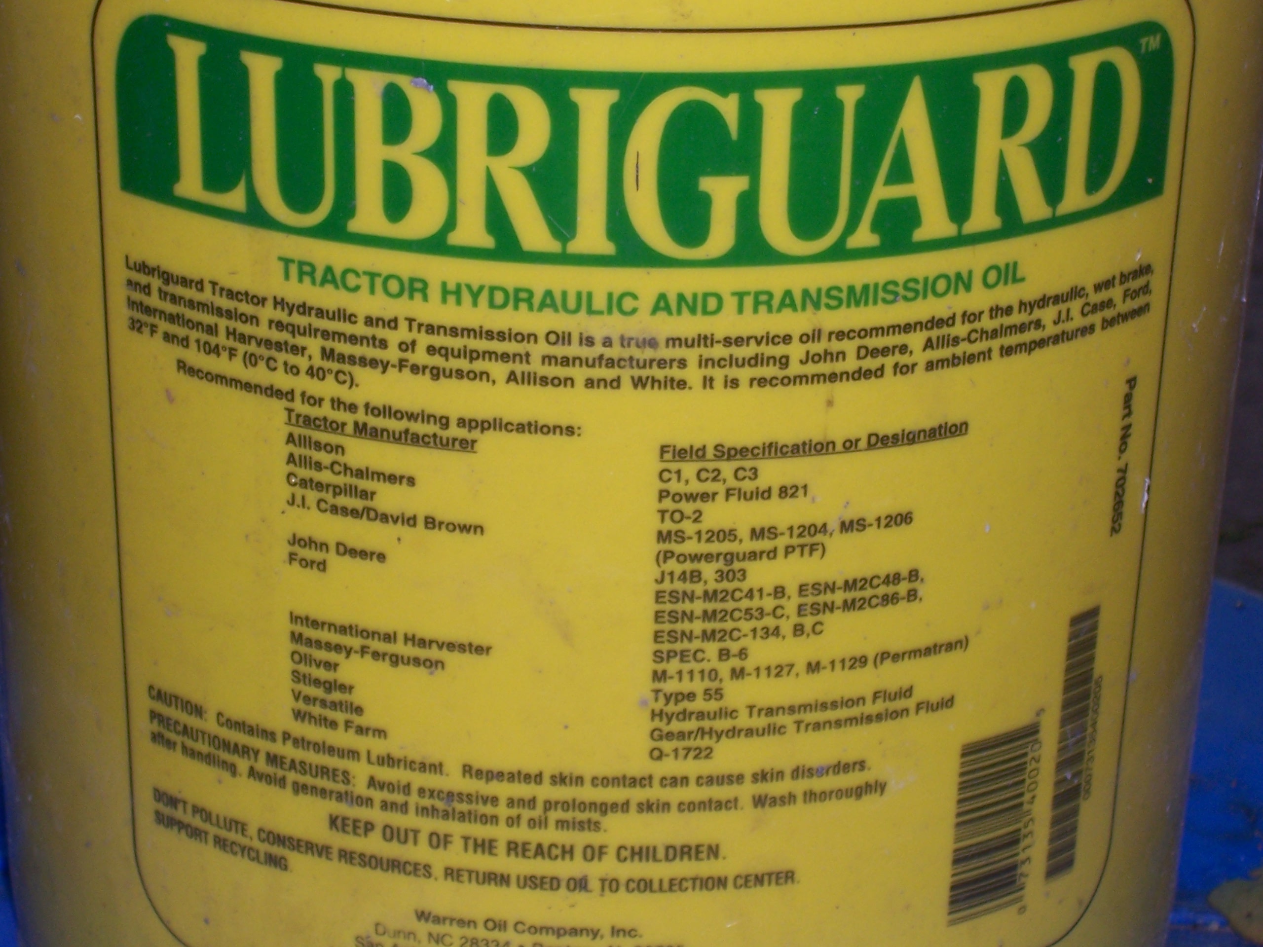

These are so simple to maintain and I believe this came from either or to what Winston said. The only two choices I have or even had back then. I think it was Walmart though. Your after the JD. 303 or equivalent. I'm pretty sure that is still correct for a 1980-85 165. 6 forward and 2 Rev. Gear........

As for the hydraulic fluid as a few others have said, use JD 303 or equivalent. Can be found at Bomgaars, TSC, Wal-Mart and most farm stores.
