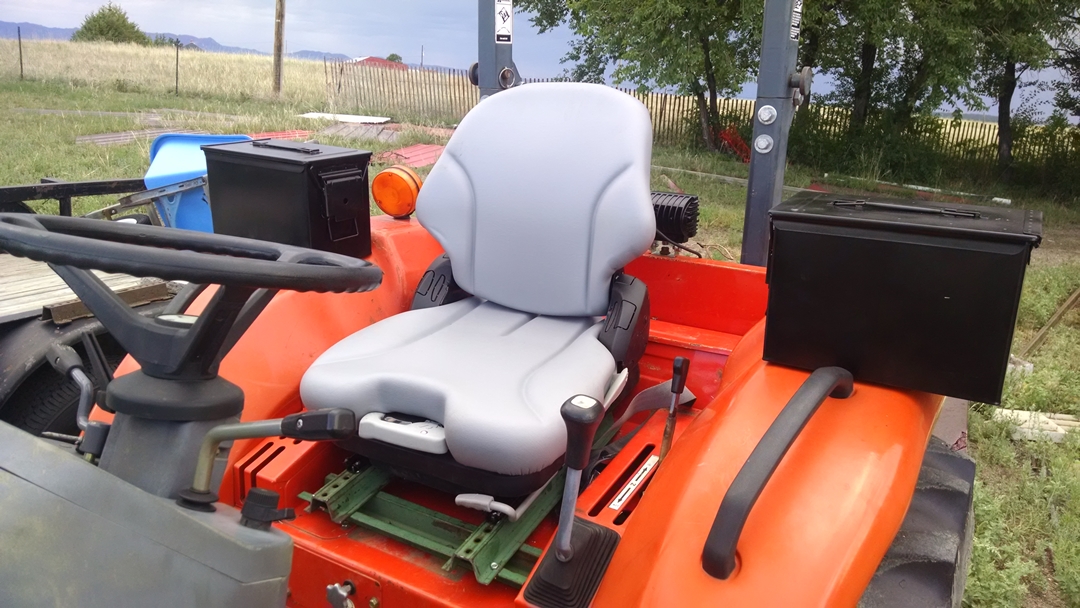

I bought it from Amazon because I have Prime and the shipping would add to much to an already "high" cost for a seat. I got t his one:
Grammer MSG65/531 Gray Vinyl Mechanical Suspenion Seat
I needed to solve the back-killing ride, when mowing big fields, especially. I was literally standing, in this tiny no-space-to-stand cockpit. The ride just awful.
Installed by fabrication of a base into my 2003 era Kioti DK35
That was bit of a fab install. But it's in.
First test ride orders of magnitude improvement.
I'll post some more in time.
I may make some more adjustments to the install. I can see that the Kioti DK35 has a significant slant forward in the pan I mounted the seat onto. Since the Grammer is intended for flat base installation, my seat resulted in a bit of a pitch. So far it isn't an issue. But I might shim the front of the fabbed seat frame so that it is less pitched.
(Hopefully I'm posting properly here this way.)

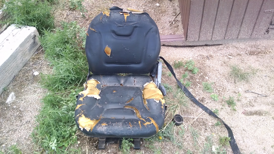

Old seat (black):
New seat (gray)

Because you have to fab a mounting for the Kioti. I'd really check all the dimensions quite carefully.
The original Kioti seat has a fairly high mounting and it's designed to install in a base of the tractor that slants quite a bit forward.
So I had to build up a platform at least 4" high so the new seat would be at a normal height. I also had to pitch the front of the fabricated mounting brackets up to reduce the forward pitch. It wasn't easy. And it should be pitched to near flat. That's not going to be easy either. The platform fabrication challenge is true for any after market seat installed in the Kioti. I don't know of a good quality bolt in seat. Sadly.

New Grammer Mechanical seat experience.
I've now run the tractor down the road and did some mowing.
I love the seat.
It seems to remove both high frequency (rolling down pavement) and lower frequency (mowing clump grass) bumps very nicely.
I completely forget I have a seat and it could have been a rough ride on the old seat, it's that much better!
Now I hope it lasts.
