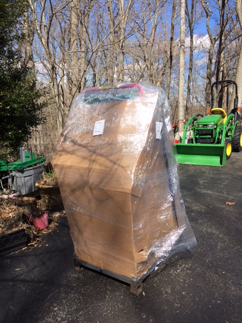

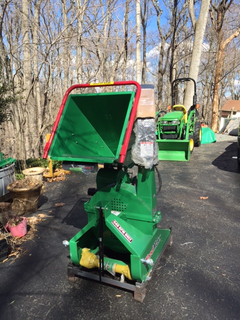

Firstly, the folks at WoodMaxx were great to work with. I talked with them on the phone a good bit to make sure this was the right option for me, and they were very helpful and responsive. They sent me a PDF of the manual so that I could review it ahead of making my decision as well, which was nice. It gets shipped as freight, and while I paid for liftgate service I have to say the guy that delivered it was beyond helpful, and delivered the chipper down to my shop instead of just dropping it at the end of my VERY long driveway. The packaging is robust, and it arrived in excellent condition:

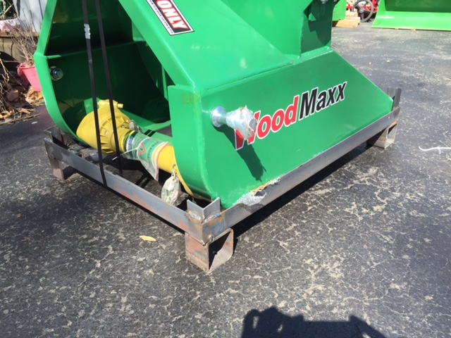

It comes attached to an angle-iron base, which I've already cut apart and put into my scrap welding bin:

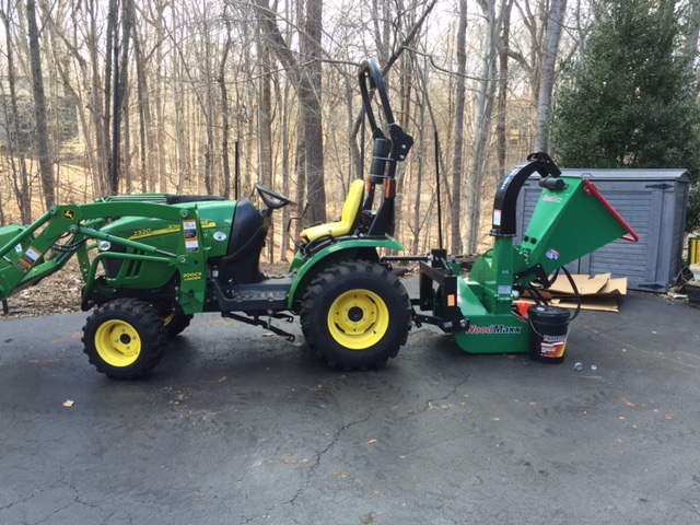

It comes fully assembled, and the only thing you have to do is fill with hydraulic oil. That was the biggest problem for me -- I couldn't find my funnel and ended up using one too small for the job. But, at least that gave me the chance to break out the Pressure Washer for the first time this year when I had to clean the puddle of oil off of our driveway. :)
It comes with a PTO shaft, and luckily for me, with my Quick Hitch, I didn't need to cut the shaft to fit. After letting it run for a bit to get air out of the hydraulic lines, I ran a 3" piece of wood through it and it chipped it into perfect little chips. Now, if the weather holds out, I'll put it to the test over the next few days and post additional comments on performance.

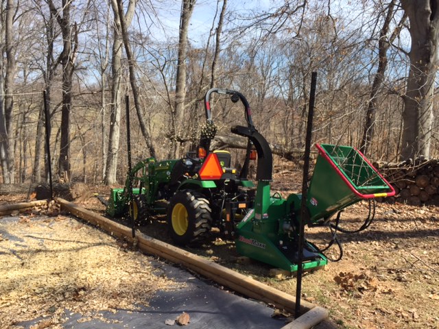

Well, I FINALLY managed to get out and try out the chipper today. Overall, I have to give it an A, not an A+ yet, but that might be user error.
It worked flawlessly on big limbs. Even with my puny 18 HP PTO, I was able to chip through 5 inch green wood by adjusting the hydraulic infeed setting at the slowest rate. Didn't bog down the tractor at all. One crotch section did stall the tractor, but that was my fault... never should have fed it through without cutting it with the chainsaw first. But, by reversing the infeed rollers and restarting the tractor, it came right out with no issues.
The reason it isn't an A+ is that it does struggle to grab some of the small branches (pencil size or smaller) for some reason. When I was doing final clean up and putting in some of the small pieces that were broken off / left over, it didn't always grab them. I think that it might be because I don't have the tension spring tight enough. This weekend, I'm going to tighten it a bit and see if that helps... assuming it does, this machine will be an A+.
I am SO glad that I went with a hydraulic feed unit. As a one-man-show today, it was really nice to put in a piece of wood, then walk over to get the next one knowing that it was going to feed fully. Not a single jam or misfeed today. On the gravity fed unit that I rented last year, I had to manually push the "branchy" stuff in to make sure it would feed correctly. Not the worst thing in the world, but the convenience of the hydraulic feeder is great and it's a real time saver. Plus, the reverse function to clear a jam or back out a log that is too big is very nice.
I chipped for about 3 hours today, and I didn't even make a DENT in my pile of branches and limbs, though. Our winter was hard on the trees around here -- lots more clean-up than I realized.
I'm putting the wood chips around my wife's raised-bed garden, and it looks like I'll have enough to do a full 6" of chips over the entire area without exhausting my supply of wood. Not sure what I'll do with the rest. The chips are good quality -- same size and consistency. Most likely, we'll use them to freshen up the existing wood chips around some of our flower beds.

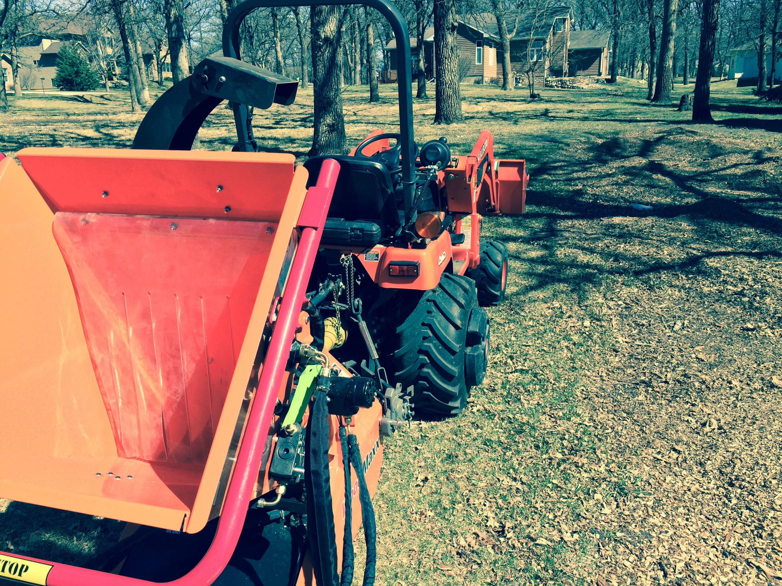

[/ATTACH]image.jpgimage.jpgimage.jpg
Trial run. Works great so far. BX 2200 handles it well.
Sorry about the inverted photo. Meant to show the BX can lift it.
The stablizer bar for Pat's quick arrived this PM after the photos. Recommended for ease of attachment and detachment of 3 pt implements.
