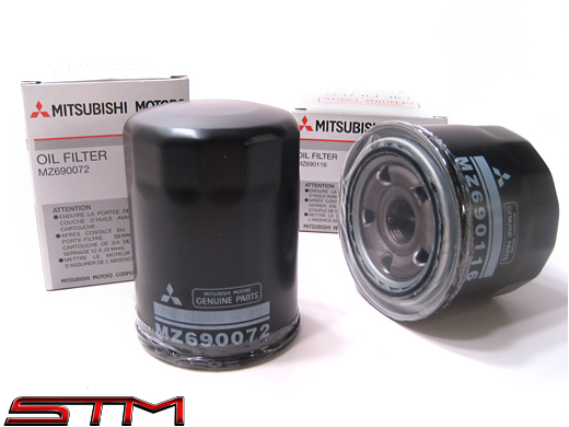

In all of my research on these tractors I did notice a lot of people ask about oil filters. Tractors seem to have the same cross references to oil filters as cars. So all the aftermarket filter brands make compatible filters for the Mitsu 1.3L. I plan on using the same OEM Mitsu filters I use on my Mitsu cars, MZ690072. I can get them for about $5 a piece. All the Mitsu car engines take either this one or MZ690116. Here is a pic of both filters: http://www.streettunedmotorsports.com/parts/b/evo_oil_filters.jpg
The filters are made by Denso in Japan. If anyone has an actual Mahindra filter, I wouldn't doubt that they are the exact same thing with different markings on them. I think the MZ690072 will be slightly longer than the stock one, but as long as it doesn't hit the cowl, it will work. I have an Infiniti G37 which can also take this same filter.
I've also noticed that the oil caps on the Mahindra/Mitsu tractors is identical to the oil caps used on the Mitsu cars from the 90s and into the 2000s. I wouldn't doubt if there are some other shared parts.

I agree with those oil filters all working on the MAX 28. What I learned in all my research is there a lot bigger amount of cross referenced oil filters that will work on these Mahindra/Mitsu tractors than what is out there documented.

Just my normal warning when this type of thread pops up. Just because the threads are the same and the gasket matches up doesn't mean it is the correct filter. If Wix or Baldwin or Napa or whomever says it is correct by application, then I think you are good to go. But if you get a cross reference off a cross reference or a guy on a website says it fits, I'd be careful. Other than threads and gasket compatibility, you need to consider filter media type and size, bypass valve pressure setting if equipped, anti-drain back valve or not, and pressure capability of the can. If Wix says it works, we can assume their engineers considered all of those factors.
As time goes on, we are seeing more and more aftermarket support from various manufacturers for filters for Mahindra. That is good in my mind, as it will keep Mahindra honest on pricing. I think folks are OK with paying equal or even a little more for a OEM filter, but nobody wants to pay $20 for a filter that ought to be $10. I get that, and I agree.
We cut apart a Mahindra/Mitsubishi oil filter and an aftermarket oil filter once and the difference was significant. So if you do go aftermarket, at least go quality aftermarket.
