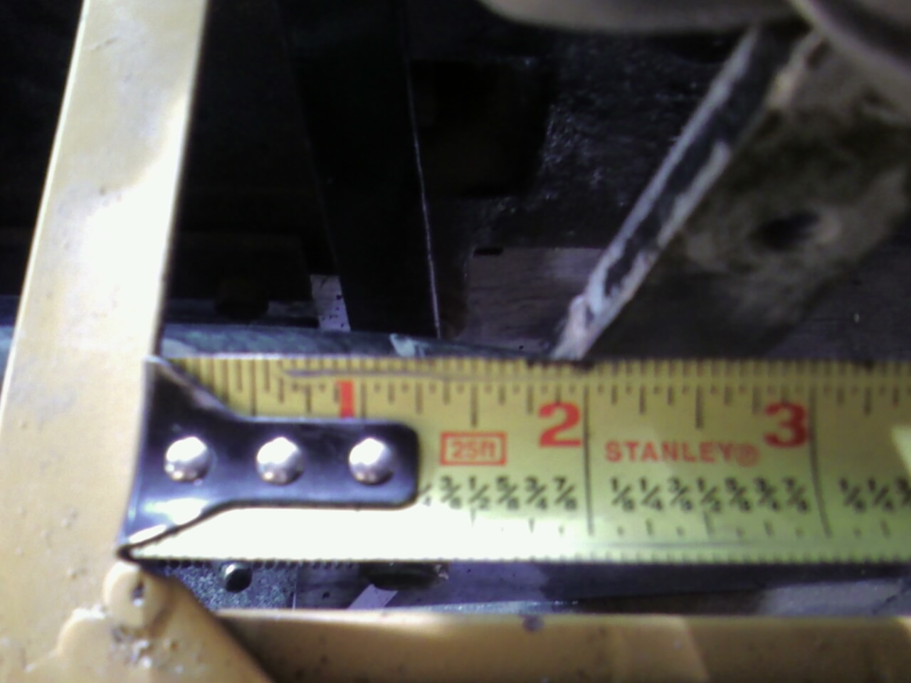

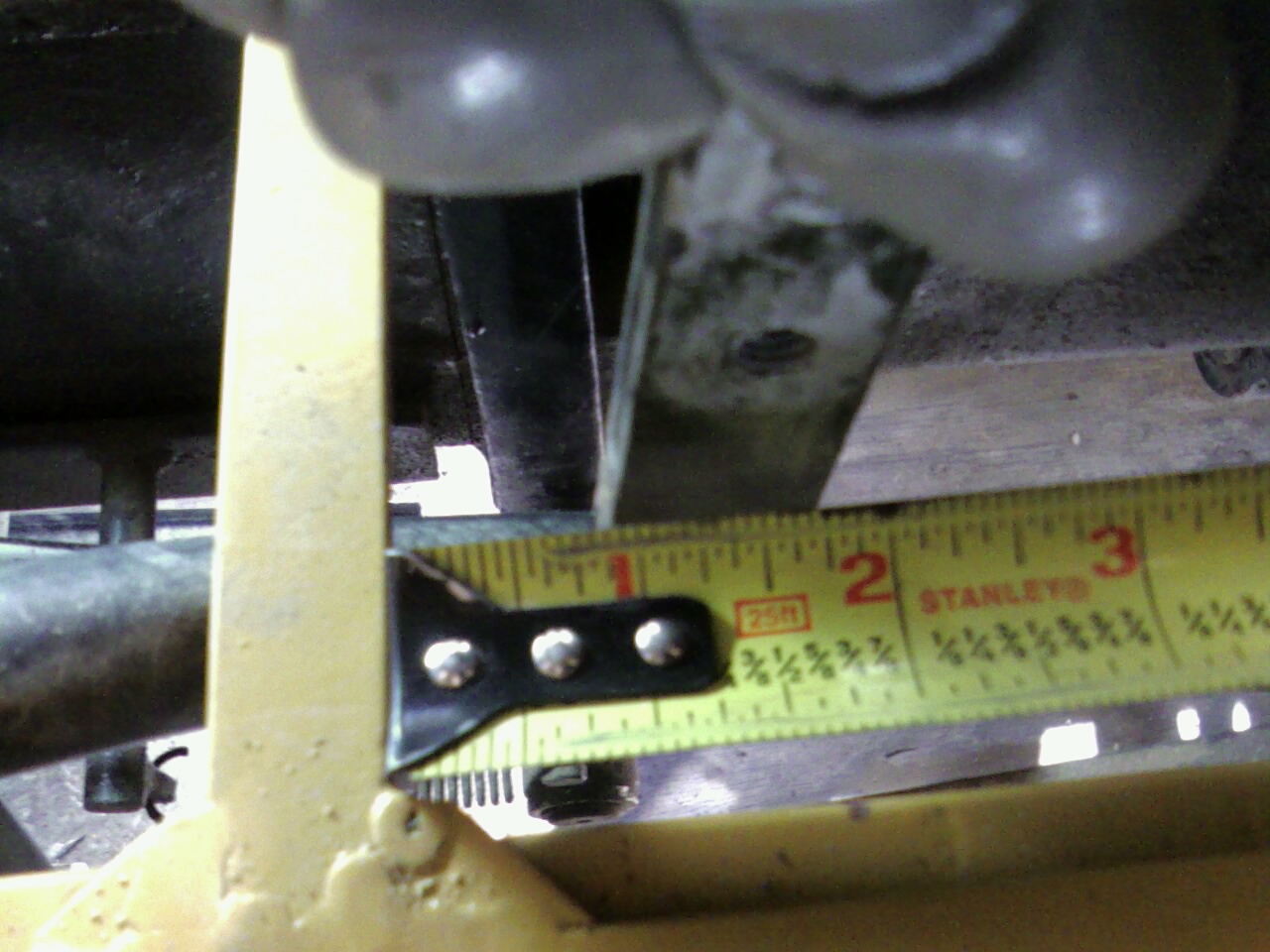

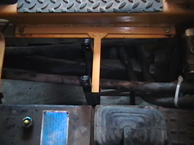

update: I realized my break pedal also have zero free play. They rest against the floorboard like the clutch did. So I'm working on adjusting those when i realized the operating rods are hooked up backwards *facepalm* the book shows the brake rod going to the lower hole and the clutch rod going to the upper hole. and they are reversed on my machine. also one pedal has proper free play but only the with floor board removed. I'm going to go through the adjustment procedure and hope this fixes my slippage in lower gears.
its hard to tell from the pics because i couldnt get the hydraulic hoses out of the way. a few are even stretched tight with no room to move them around.
im getting more and more annoyed. i really dont want to ship it back and get a new unit... can i ask for anything like discount or free parts?
   / Just got a Nortrac 35XTD.. need some help! #3
You need to fabricate a jig for adjusting the steering clutches/brakes to the proper sequence, and engine clutch as well. Dimensions are taken from the two floorboard bolt holes and the floorboard stops.
Check your final drives for the proper gear oil - they should have SAE 140 gear oil and not the "mystery paste" that comes from China. Check your fuel injection pump/governor assembly for the correct oil level - use the same 15w/40 oil that you use in the engine. Also check your air intake system for restrictions - these are the only bulldozers in the world that allows the radiator fan to blow crap directly into the air cleaner.

fantastic idea for a jig to adjust the brakes! and thanks for the pictures. yeah i have done a bunch of research about chinese tractors and the dozers. so I'm not freaking out but i did send an email to my sales person letting them know what issues i have found so far and that they need to talk to their technical/prep ppl cuz this is unacceptable. I honestly don't want to have the hassle of sending it back and getting another one. I'm hoping they can work with me, give me some free parts and/or give me the extended warrenty for free. the sale is done so to speak so i dunno if asking for a discount now is doable. but we will see.
Overall im happy with the machine. it just needs to be setup properly.
