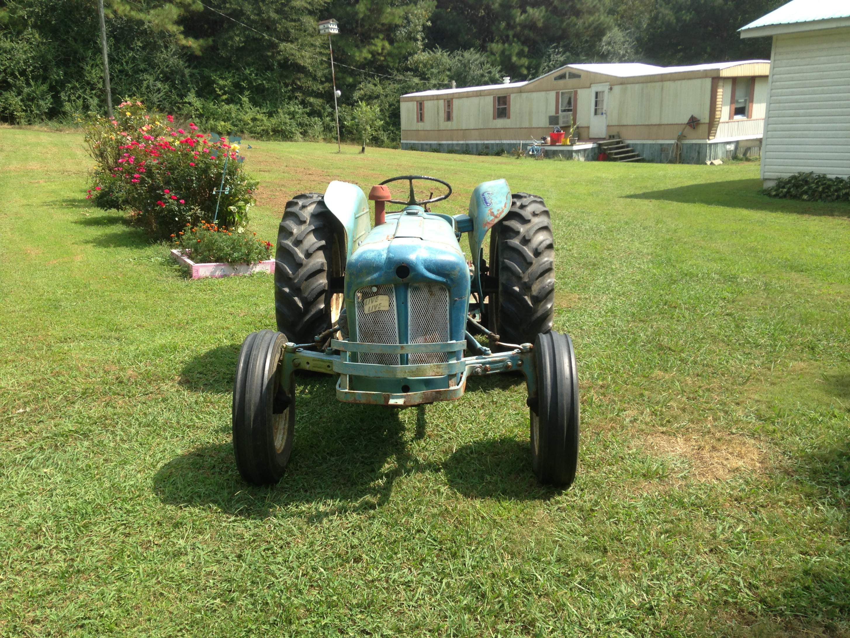

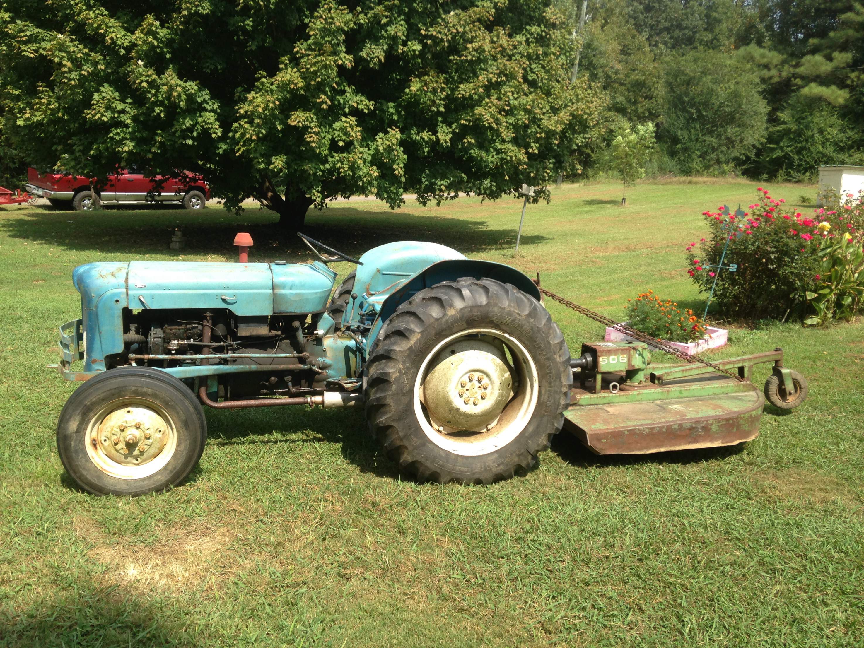

Hey guys, glad I found this site. I just bought an old ford tractor and I am trying to identify the model and year. I was told it was a late 60's Ford 2000, but I'm not too confident. It has a 3 cylinder diesel motor with live PTO and 2-stage clutch (half way in and it stop the transmission, all the way in and it stops the pto). The hood open from the left side with two turn handles. It is a 4 speed with high/lo selector (8 speeds total). It has an interesting emblem on the grill that says "live PTO" and "live clutch".

I think it is a Fordson Dexta, but don't know the year.

Sure looks like a Dexta. Look for the serial number on the flange between the clutch housing and the engine, on the left side of the tractor, stamped vertically on the edge of the flange. Then see if it matches any of these numbers.
1957: 957E 1
1958: 957E 144
1959: 957E 22558
1960: 957E 44432
1961: 957E 71921
1961: 957E 312001
1961: 09A 312001
1962: 09B 702592
1963: 09C 932031
1963: 09D 900001
1964: 09D 907332
Final: 09D 928248
