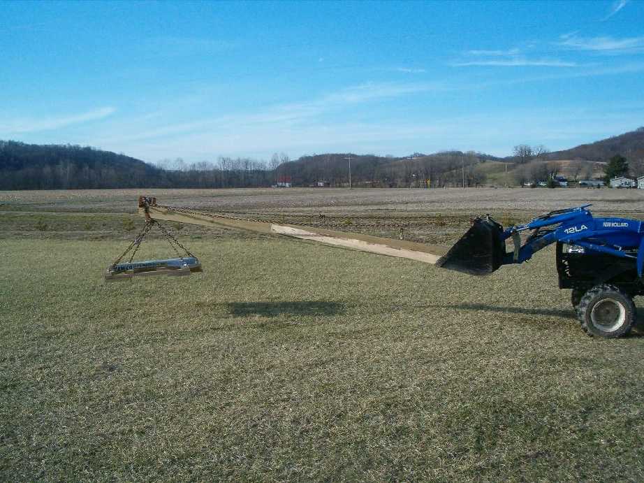

As far as tires go I have the R4s. Normal mowing jobs they do fine. Haven't noticed any significant ruts during mowing. I normally take the FEL off though since it takes all of about 2 minutes. Today I had some serious weight on the tractor and I was in 4wd and it is extremely wet around as the soil is still kinda thawing out so I didn't notice some marks. Nothing that a little roller won't take care of though. Here is a picture of what I had on the front of the loader today. That is 2 bundle of shingles on the end of that pole if you can't tell. I also had the KK on the back with 6 concrete blocks for counter balance.

What would be a guess of the weight at the bucket of your tractor.That is a long way out and kind of heavy.I guess you were going to place them on a roof?

I was placing them up to the roof of the pole barn I'm building. I have no idea what the weight at the bucket would be. I know the first time I tried to lift it up I didn't have the bucket curled enough and it wouldn't curl and I had maxed the height out. I set it back to the ground curled the bucket without any tension on the chains and lifted again. This time w/o any problems. 2 was about all the little guys could muster - but that is 2 more then I was gonna be able to muster. Save a lot of running up and down the ladder.
BTW, using this same setup is how I set my trusses for my barn. It is 30X48.There were a total of 25 trusses.
