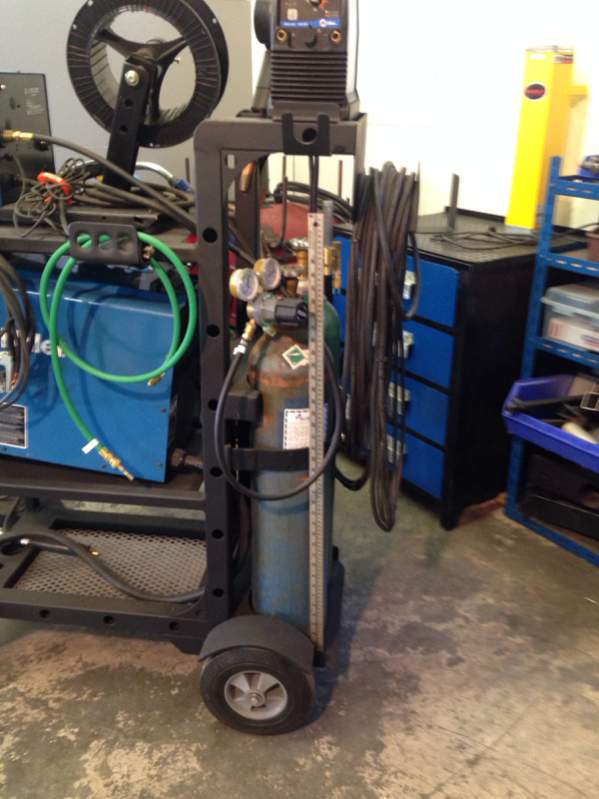

At one welding supply house they said to a customer "Buy a tank. If you find it is too small just trade it in on a bigger tank. You get the price paid to the bigger tank." I have a 4 foot tall tank I use with my Handler 140. It lasts a good while as little as I weld. Here is a thread with a picture at the bottom of the thread. What size gas cylinder?
   / Just bought a new welder! #8
Thanks Jim, thats a good pic.
I copied it into TBN with "insert image" (copy from URL)
