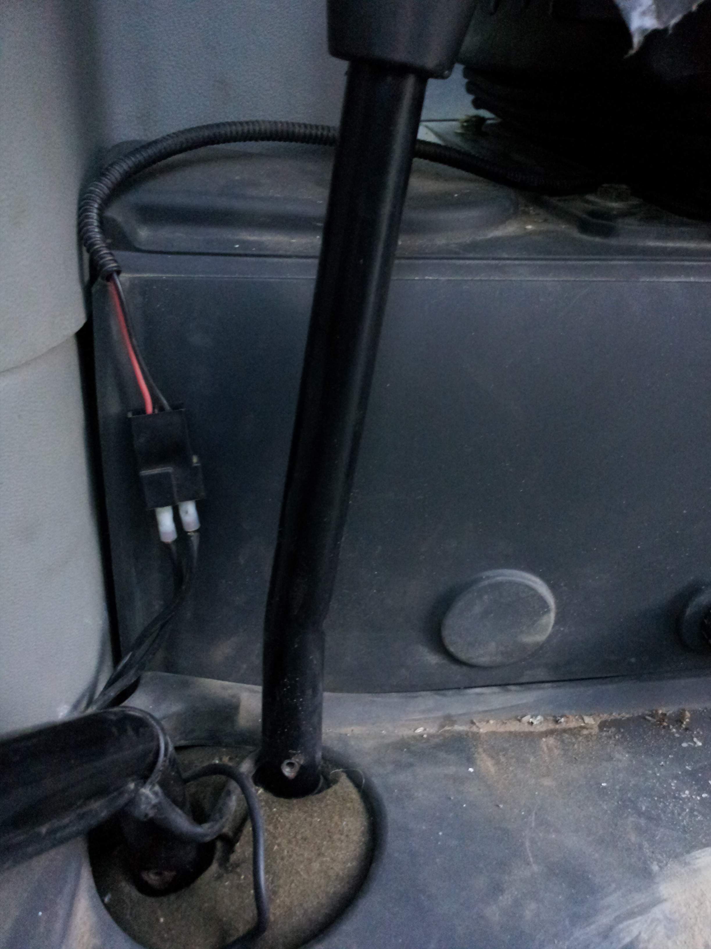

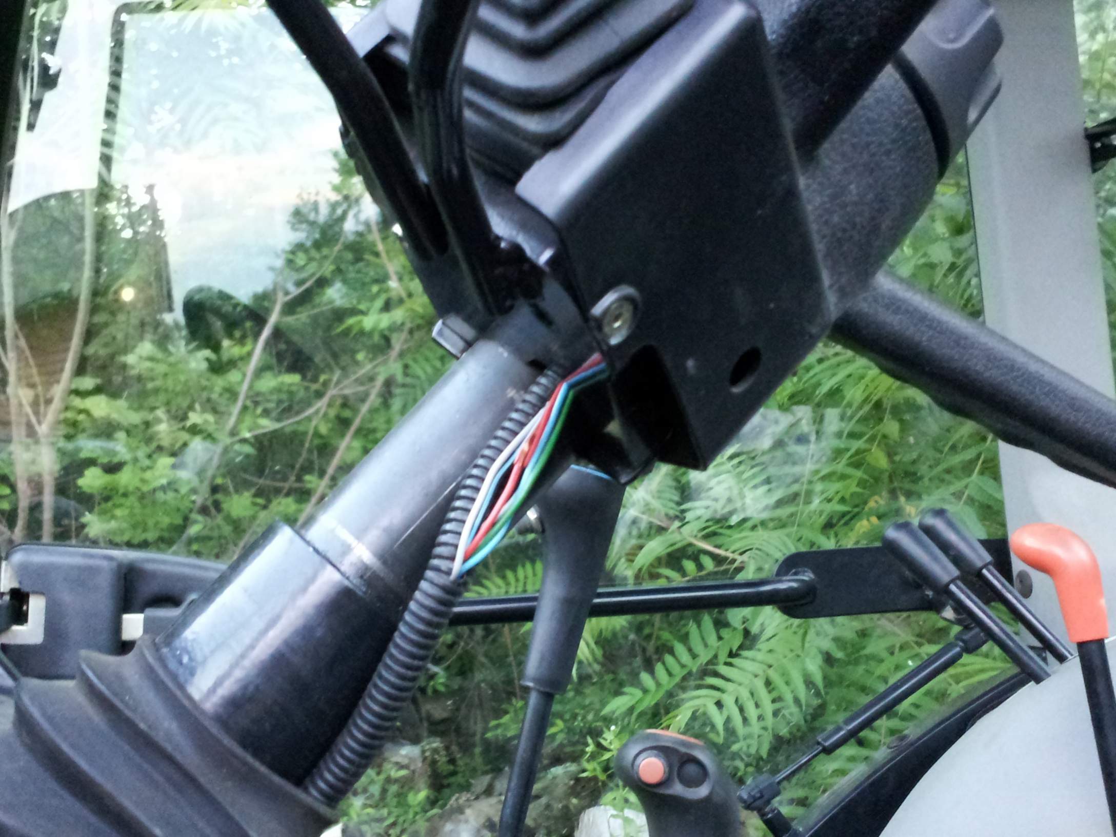

So far, it 's really nice. I fund some broken plastic and glass in it, so an event must have taken place. There are some small screw holes in the cab's right side door frame too. The wires on the steering column are exposed, and there's a splice wire by the shifter, running to the seat area. It's not in the correct place. Other than that, it looks new, but there are a few things:

The column wires look like there may be a trim piece missing. My column is different on the open station, but I think you're missing a trim piece. The spliced wire I don't know about either, except I know there was a factory fix supplied to dealers that involved a pig tail type splice somewhere on the tractor and it was electronic related. That may be it, hidden poorly. On the overspray, I guess that is the factory filter and I would go ahead and replace it given the age. Alternatively, a lot of dealers lay down new black paint on used machines and that could explain it.
