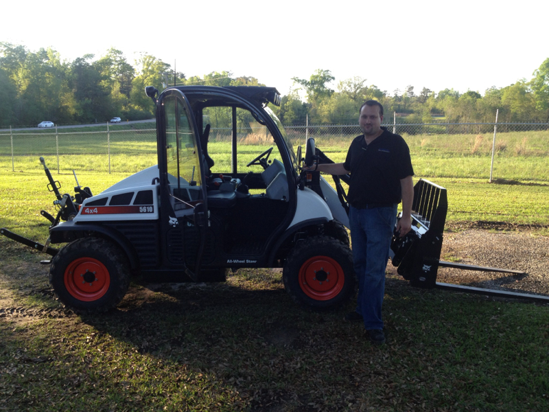

Just got my 2012 Toolcat 5610 (ordered oct. 11' with all options even Sirius sat radio) delivered from the dealer Friday late afternoon. I've been using it for a few task totaling 2-3 hours over the weekend and noticed a few quirks I would like to pole the forum community for advice on.
1. Saturday AM when I moved the unit from it's parking spot I noticed a 3-4" diameter oil / fluid spot underneath the front driver's side of the drive motor on the concrete slab.
2. Once over the past two days when starting up I received the error code 50-08 "PDR sensor multi response". After stopping and starting the unit a few times the error went away.
3. Saturday PM and Sunday AM when I went to start my TC up I got the error 50-56 "can bus comm. error". As with the other error after cycling the unit from start to stop a few times it went away. FYI on both error all function of the unit worked except for drive forward and reverse until error was cleared.
4. On all startups I get a brief puff of black smoke from exhaust. I'm used to that on my older model ford powerstroke dually but it surprised me coming from a new diesel machine. Unit had 4 hour on it when delivered.
5. My unit is plagued by the constant ac compressor cycling issue. Dealer did provide a service document upon delivery noting that the factory engineers are working on the issue with a possible solution soon.
6. Sirius Sat radio option would not display on the radio. I dropped the center overhead console panel and found that the Sirius sat tuner data cable was not connected. I completed the connection, registered the unit online and all was working again.
Please let me know anyone's thoughts on these issues I'm having on a my new 5610. I'm going to contact the salesperson from the dealer first thing Monday, but any feedback I could get would be greatly appreciated.
I'll be glad to post the progress of these issues as they evolve as it may help other owners in the future.
