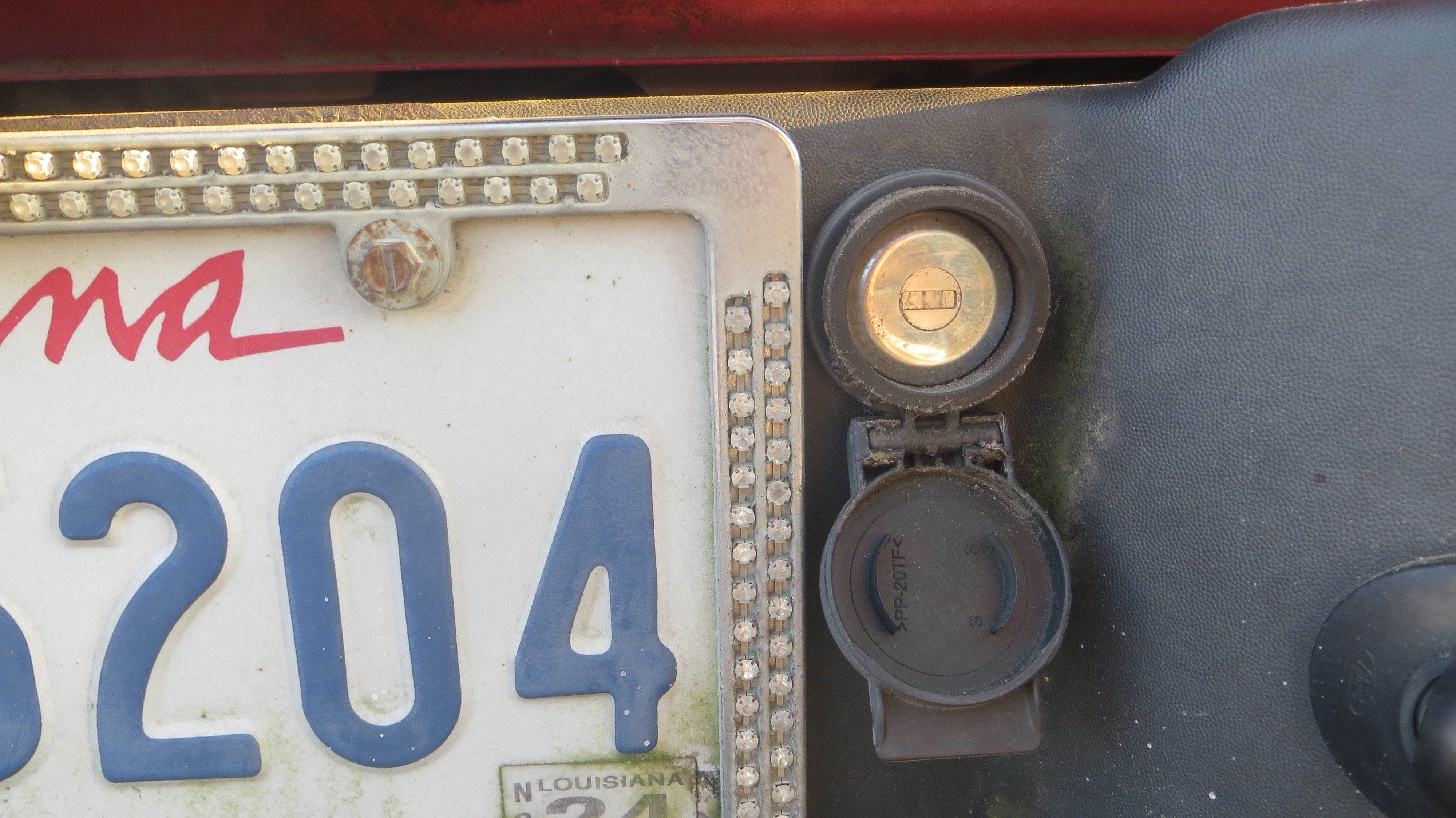

I bought this 2012 Ford F150 new and have had it all this time without ever seeing this before. I just saw it today for the first time and don't know what the heck it is. I am too lazy to look for the manual to see if it is in there because I know there is someone on this forum that knows and will tell me. My key that came with the truck goes in the keyhole but won't turn it. So, What is it?

It is the access point to you spare tire. Put your ignition key in and turn counter clockwise to remove the lock. Then you have to dig out your jack handle bars (mine were under the rear seat) and connect all the bars together and insert fully thru the hole. Then unwind to lower your spare wheel / tire from between the frame.
As you bought it new and haven't changed the ignition lock the key should work. May need some lube / penetrant oil to free it up. Its been sitting for 12 years.

Put the ignition key in, turn it and pull. It should come out if not rusted in. Behind it is the tunnel that guides the rod to the crank that lowers the spare tire.

That's where you access your spare tire. My crappy Internet won't let me see the full picture, but it appears you have a lock on it which must be removed before accessing

I question the need for a lock on the spare tire "system". I just can't picture somebody squatting down and operating the lift system just to steal the spare tire.
