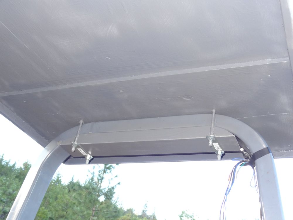

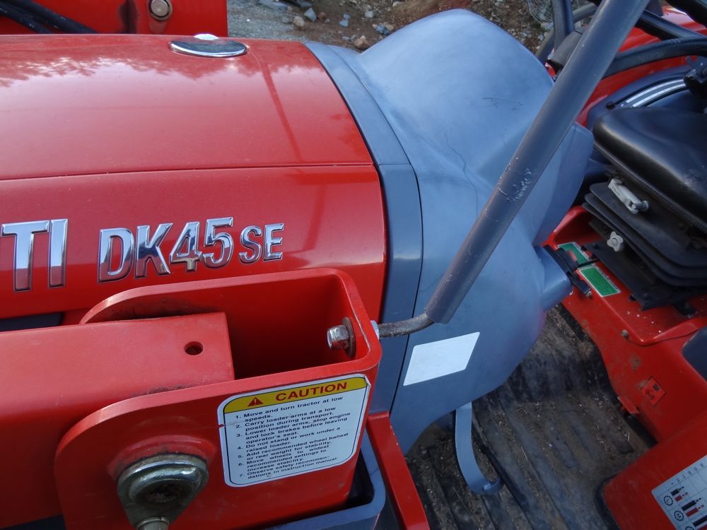

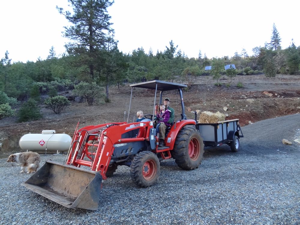

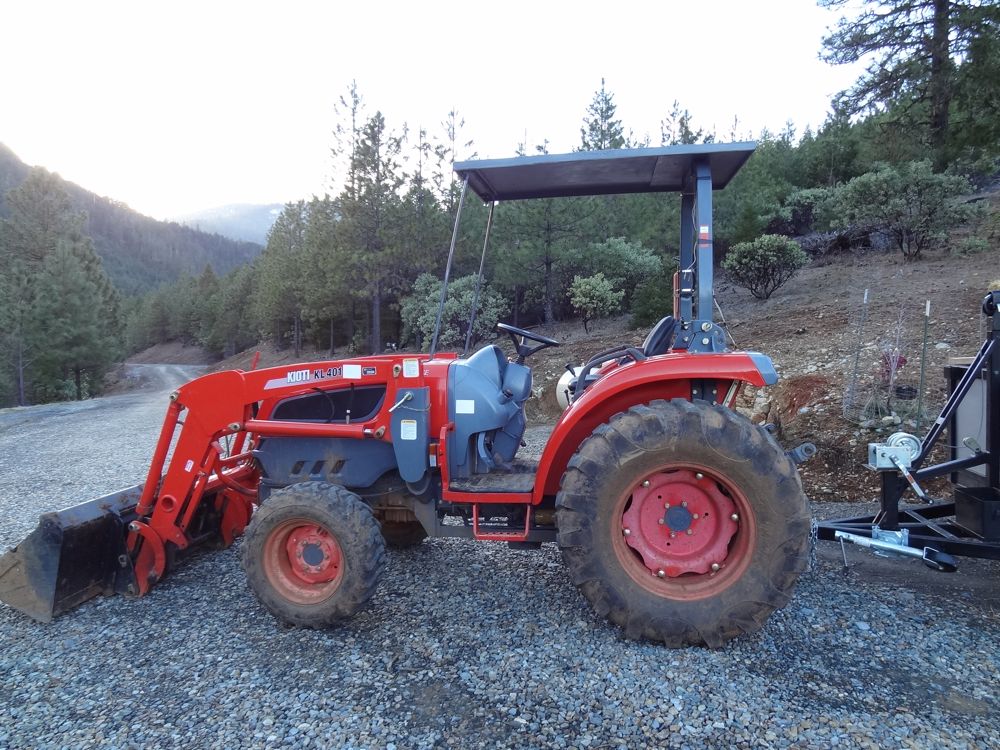

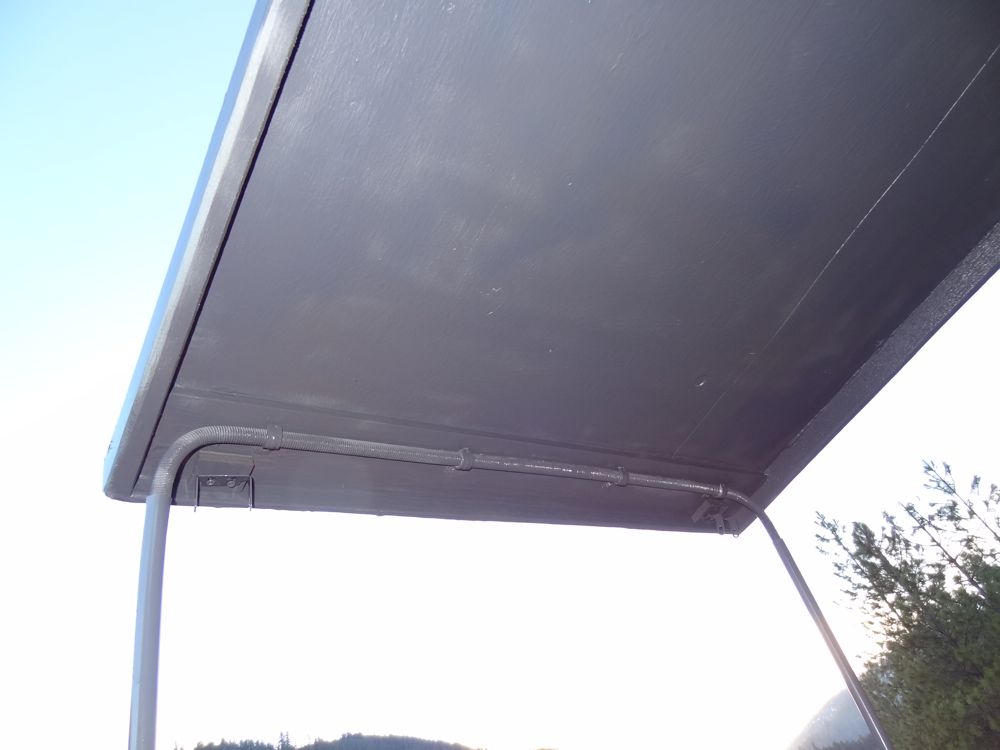

Just finished building my tractor canopy yesterday. I wasn't about to pay >$500 for a piece of fiberglass.

Looks great and yeah, I need to build one myself. Sure is nice to keep out of the sun.
Any lights?
   / Just another DIY tractor canopy #4
Looking Good! I can't believe the prices of canopies either.
   / Just another DIY tractor canopy #5
Looks good and it well get the job done. In the summer time I can't believe the differents in temp they make.

Simple and functional, I like it ! Great idea using the loader frame a couple of holes, and threading the ends of the rod.

Sure, KennyG: it's all just material I had lying around.
Roof of 1/2" plywood, doubled up in the stressed areas or where there would be multiple screws for lights, etc.
Border of 1" x 1 1/2" ceder.
3" U-bolts, 2x4"s under and above distribute the stresses.
Everything glued and screwed w/ polyurethane glue (Gorilla glue).
Painted with 2 coats of rubberized RV roof coating/primer.
Top coat of dark grey Rustoleum spray paint.
Without the front supports, it would have worked fine, but it vibrated a bit.
I had some 1/2" threaded rod which fits perfectly inside EMT conduit, and I don't have an EMT bender so the 1/2" is easier to bend.
The holes in the loader frame were pre-drilled. I just bent some long bolts into 90 deg angles. The bolt heads fit quite snugly into the EMT with minimal grinding of the heads with an angle grinder. I was planning on securing them with J-B weld but didn't have to.

That's a nice canopy, but what happens when you want to remove the loader??? Seems kind of problematic since the front of the canopy will have no support, if the loader was removed.
