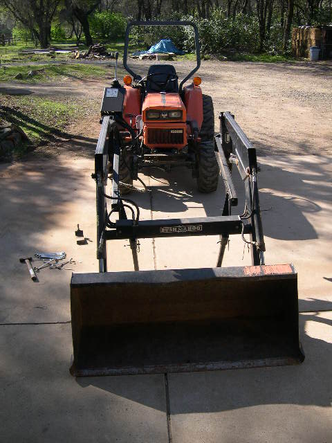

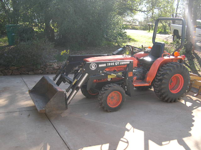

I did very well with a Bushhog loader on my old B8200HSTD. I bought it with just a 3pt mower and scraper, then saved up for a loader. I used the smallest Bushhog QA loader for about 10 years.
Having been around TBN since it's infancy, I will tell you the used loader market is practically non existant.
Having bought a loader, I would warn you to be ready for sticker shock. Mine was $3150.
That's right, over $3k!
At the time, a Kubota loader was a couple hundred more expensive. And, because they did not have a mount kit for my slightly older tractor, Kubota would have had to cut and weld a newer mount kit to make it fit.
These appear to be the latest version of the loader I had; the smallest available.
Compact Loaders 1847QT
Compact Loaders 1045
Had a friend with a 30hp Massey; it had a Koyker loader. Worked fine too.
The loader I bought is still going strong. I know the guy that bought the B8200 when I moved up to a larger tractor.
