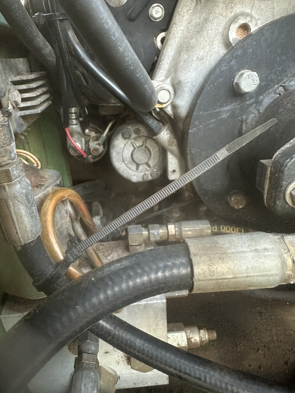

I wonder if i could find a starter with more torque for this Subaru that i currently have. I am doubtful but i may go to a rebuild shop and see if they can cross it to a larger one. Its worth a try anyways.

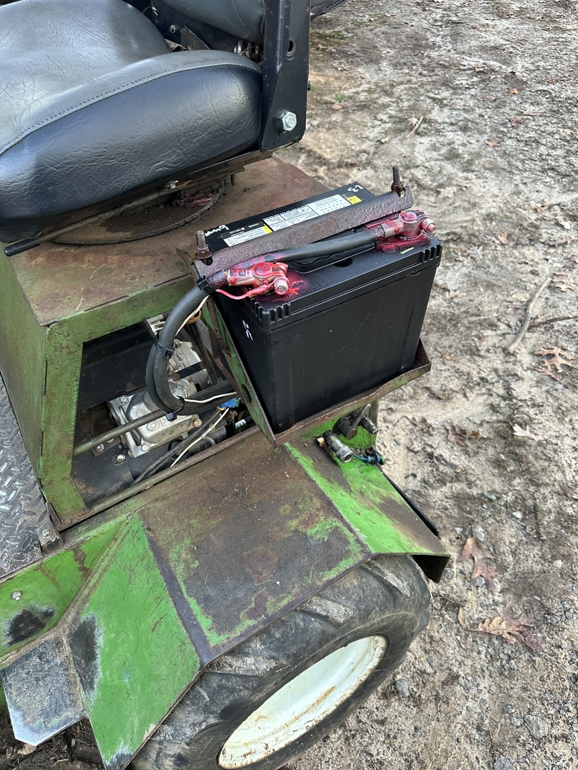

My 018 stays in a unheated garage, but I have no problems starting it. Are you sure your battery is good with good clean connections?
   / Just a thought
Batterry, power and ground are about as good as they can get. 650 cca battery.
   / Just a thought #9
Yes you have a lot of great extra battery and electric improvements. My tractor is all stock.
Maybe the brushes in you starter motor are worn? When it is out it is easy to look for your high torque version.

I know it's an old thread, but there is (or at least was) a heavy-duty starter for the 25hp Robin. It made a noticeable but not dramatic improvement in cold weather starting. That was probably 15 years ago, so I couldn't say what the part number was.
