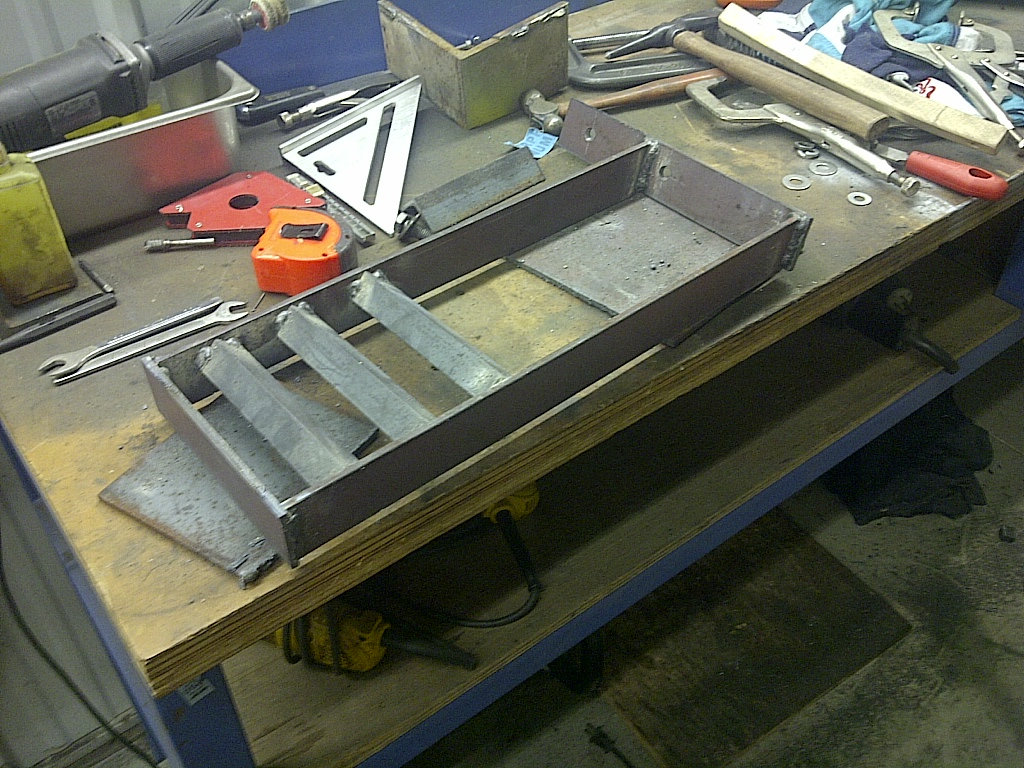

So it all started with me rebuilding a tilt cyclinder.
I finished the cyclinder, re-installed, and went to start the old girl to excersize the cylinder to get some oil in it before I did the other cylinder.
turns key...nada
charges battery....
turns key...."Click!"
dead cell in one battery
anyway so I went to the local dealer and bought two new batteries. I removed the old batteries which were in an double box on the right side. i Look in the battery box to see it is completely rotten with rust inside.
So I ecide to build a new battery box, then I decide to go back to original and have one on each side.
And so it begins I start yet another project except i gotta finish this to start the tractor.
Day 1 I figure out my design and start fabbing

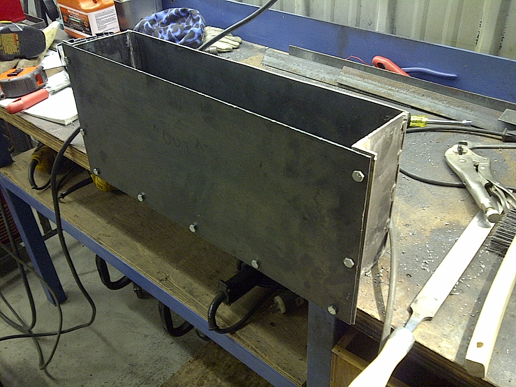

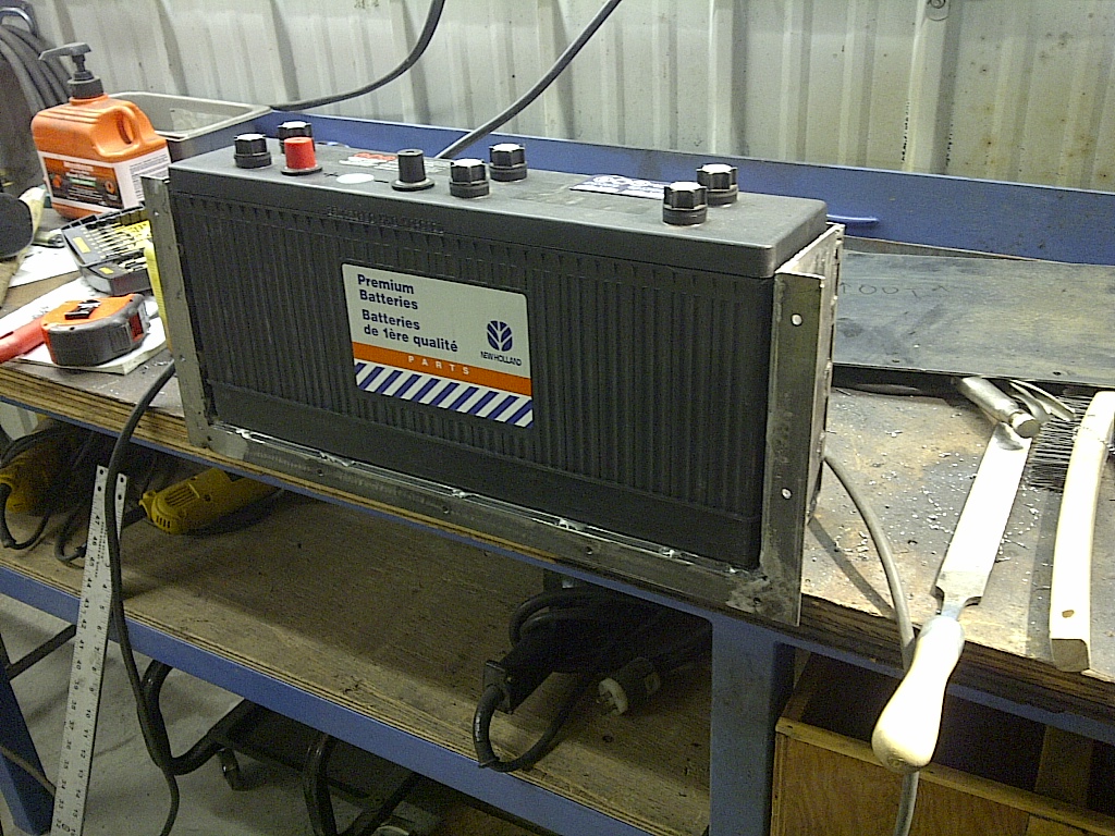

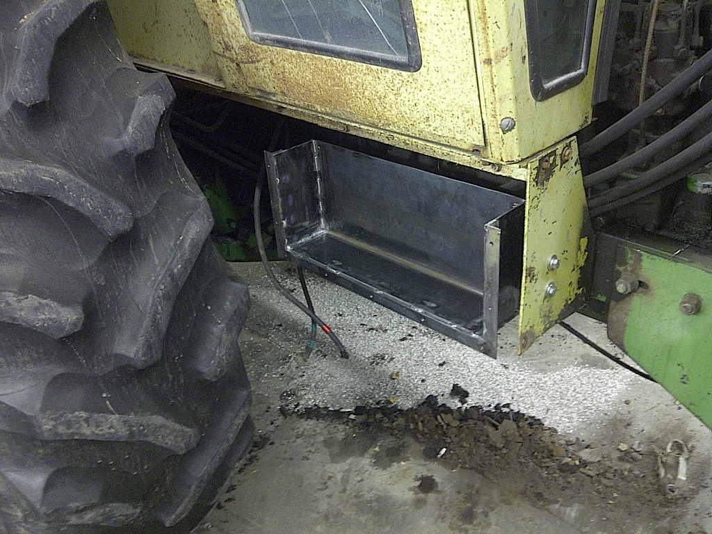

   / Just a new set of Battery boxes for my 4020
#2
Day two I mock into position and build brackets
Tomorrow I will prep for paint and saturday I will install
Then I need to fix that side step cuz it is all bent and dirty
More pics to follow
Note I mae the face removable just to make it nicer to remove the batteries should the need arise.
PS I LOVE MY PLASMA CUTTER

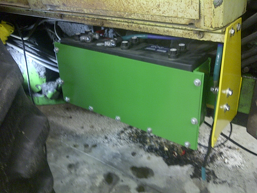

Lots of running around this weekend so by the time I prepped for paint with drying time I didn't get too much done.
Last night got home from work at 9, but got an hour in the shop to assemble the first side.
Here is how it looks so far, I have to build a new better step as well, maybe tonight.

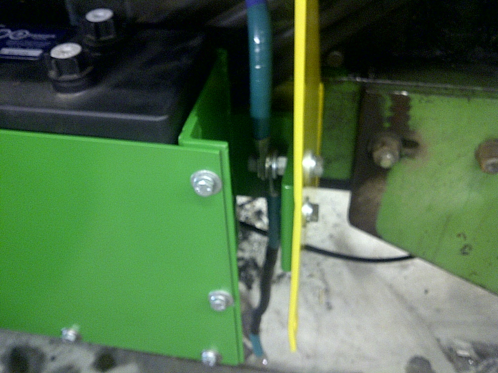

The third picture is the ground connection, one end bolts on at the step so is hanging free.
Don't mind the dirt and grease, once it warms up I am going to steam the old girl all clean and pretty and start working on any leaks. :thumbsup:
