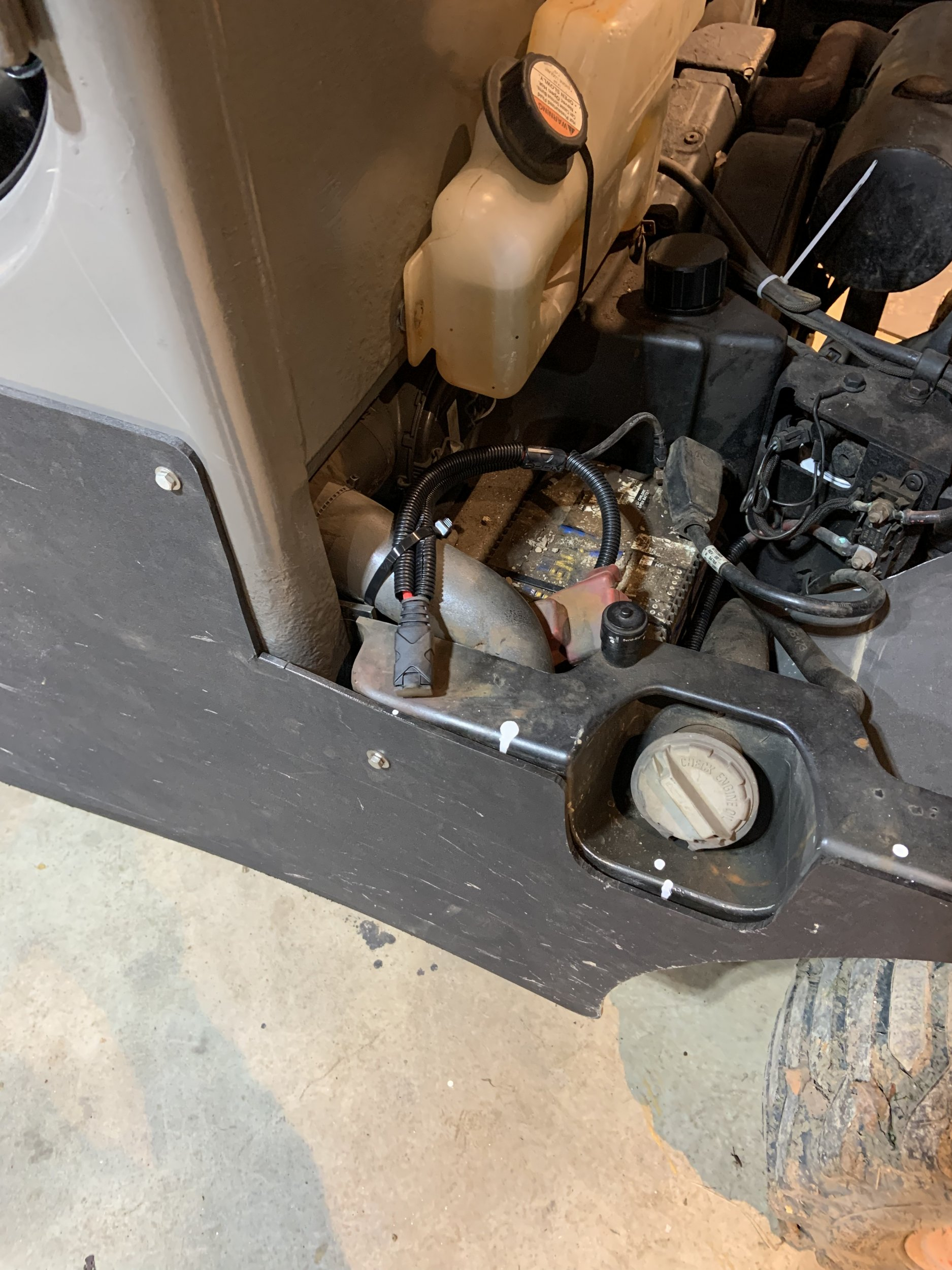

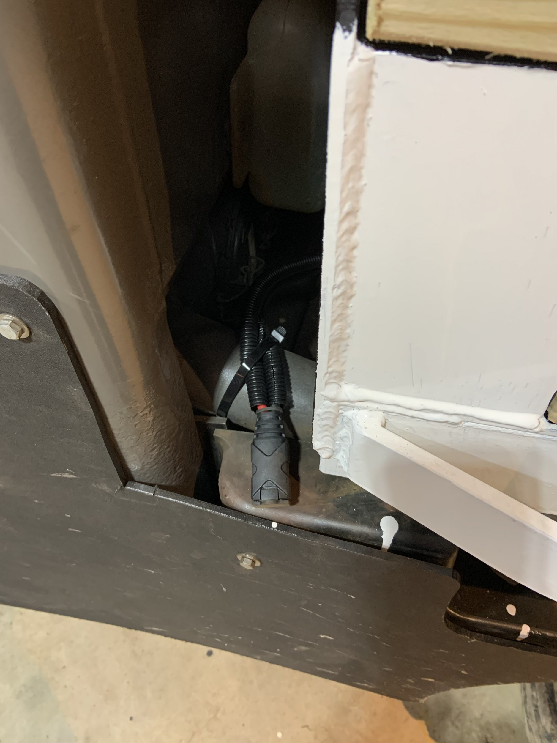

So still new to my 2007 Toolcat and wondering how do you go about jump starting it when you have a dead battery. Battery is hidden behind bed and skirting. Thinking of adding jumpstart cable that is accessible

Appreciate all the feedback. I am going to run the jumpstart cable like was mentioned above.

   / Jump start Toolcat
#9
Added an lead for my jump box. Should be good for when it happens.
