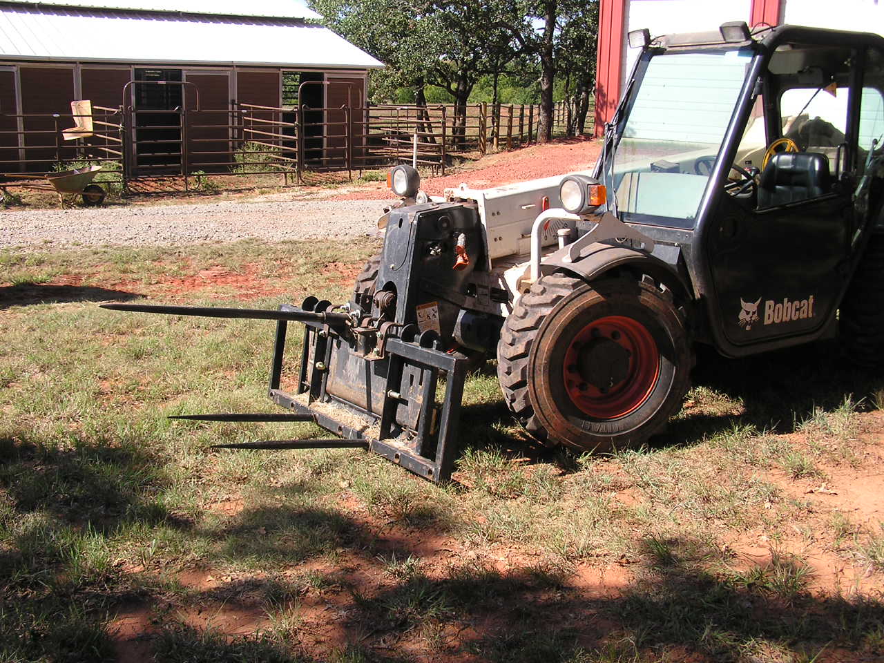

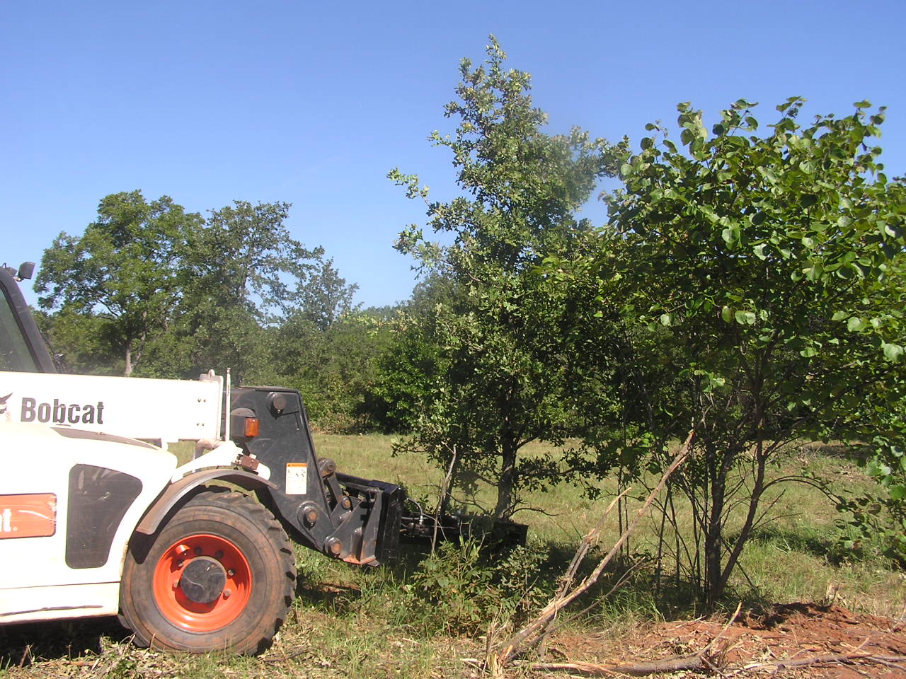

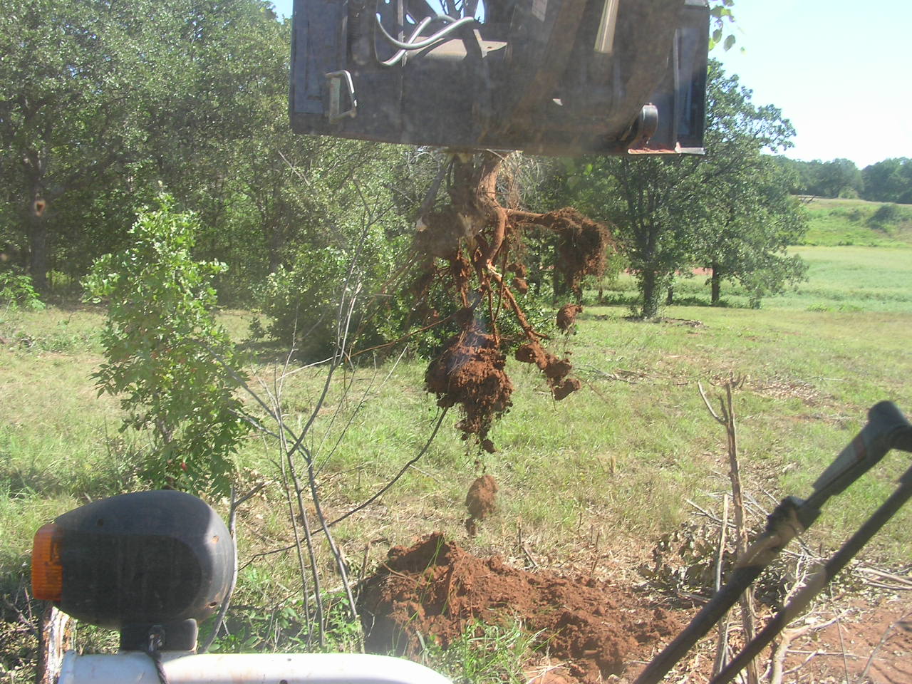

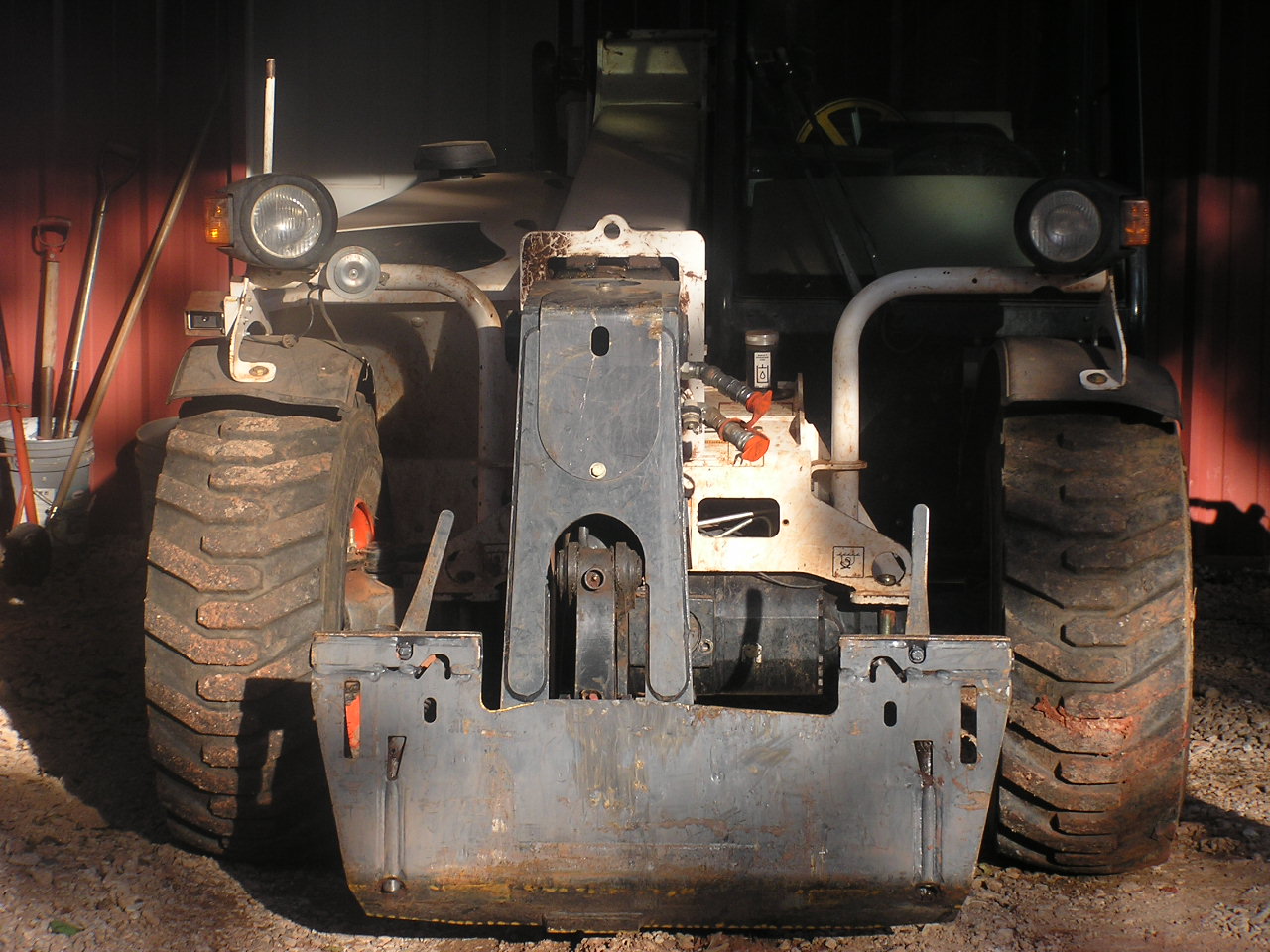

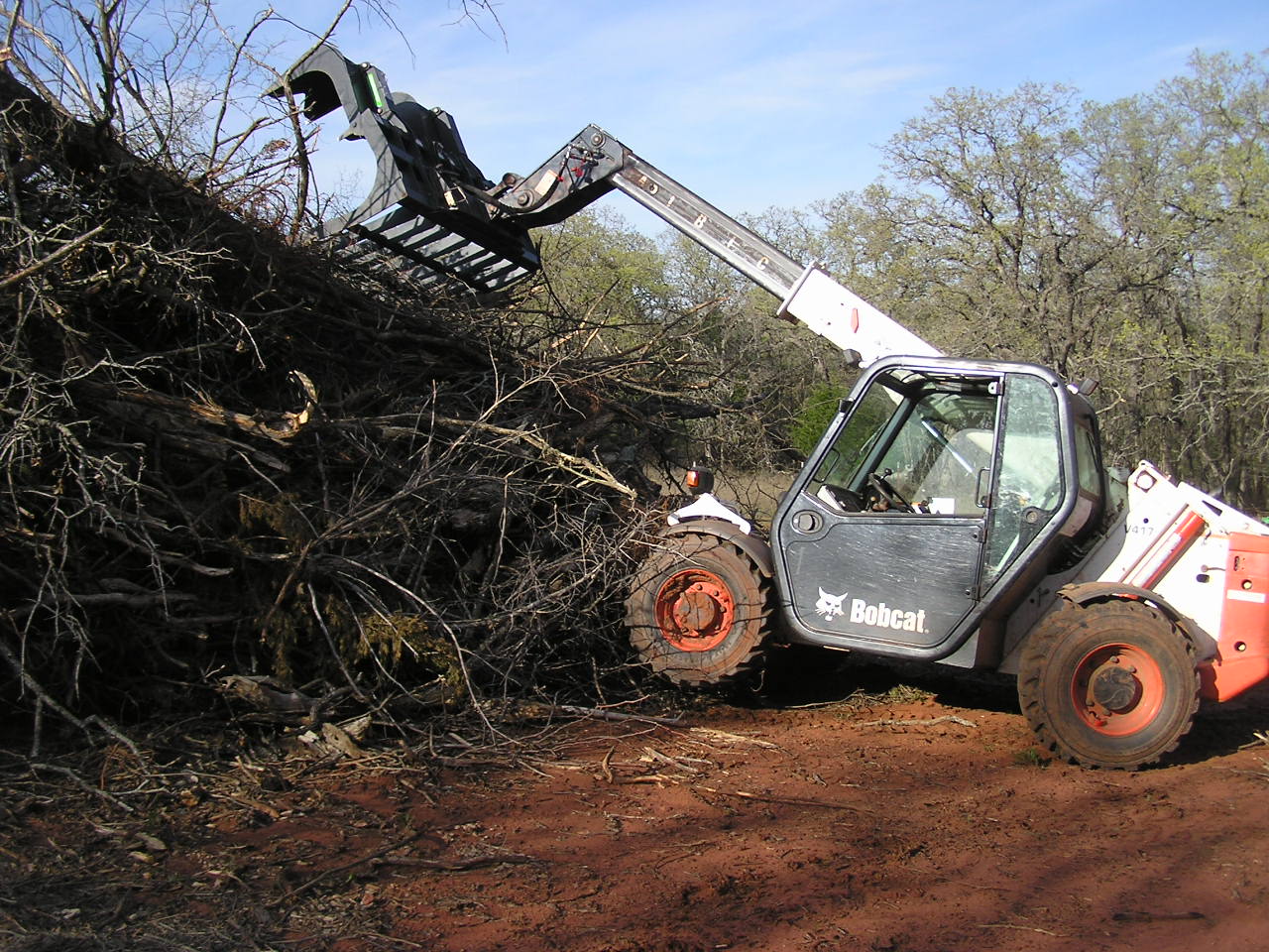

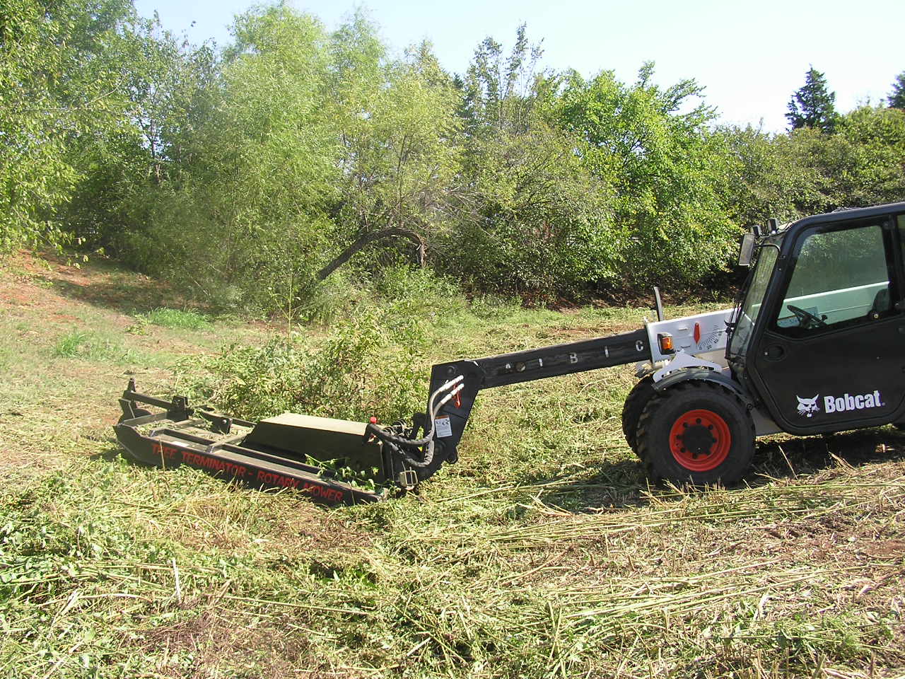

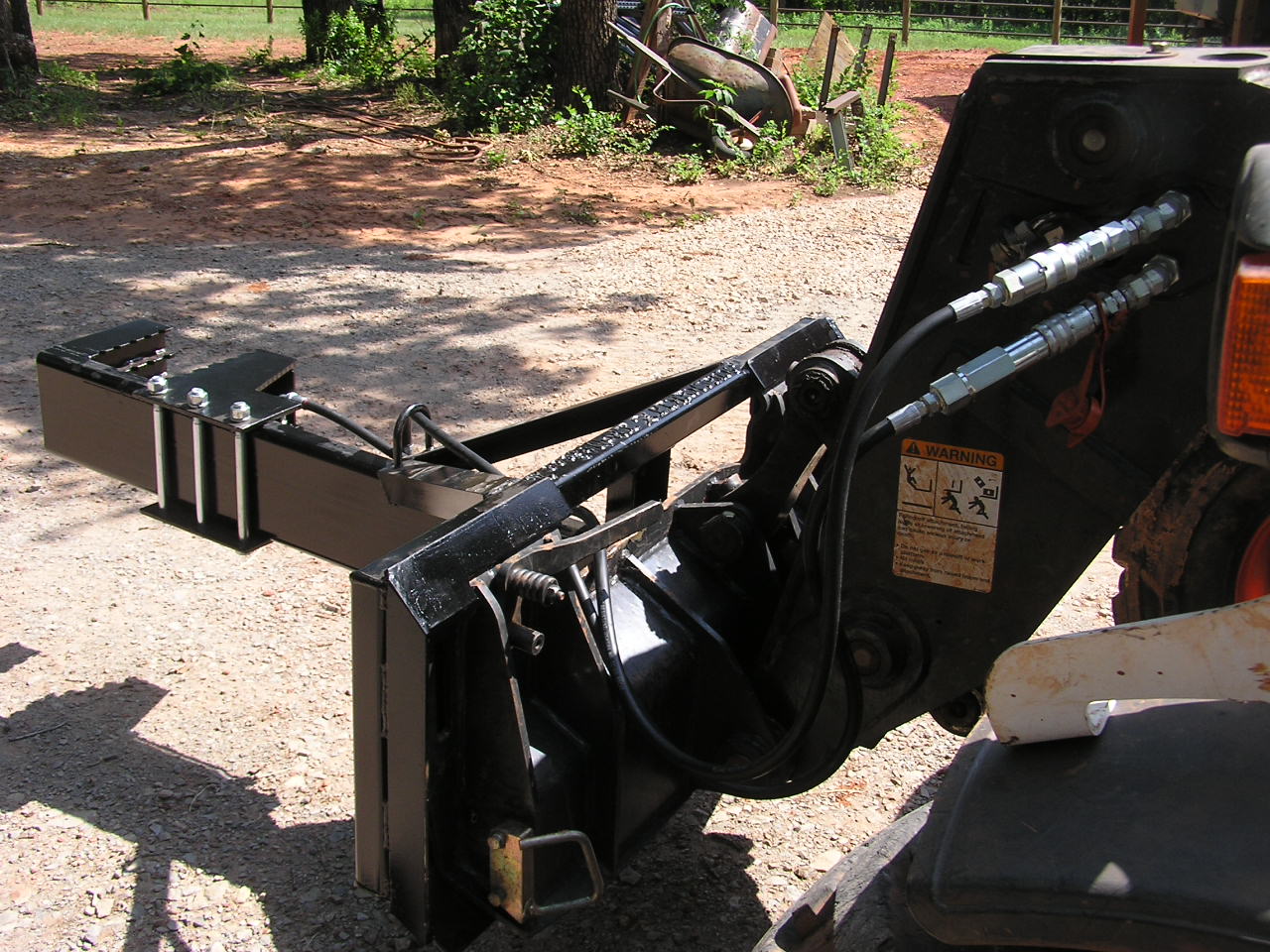

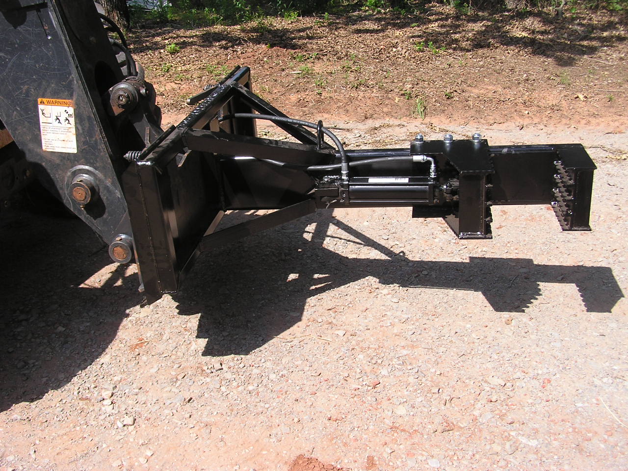

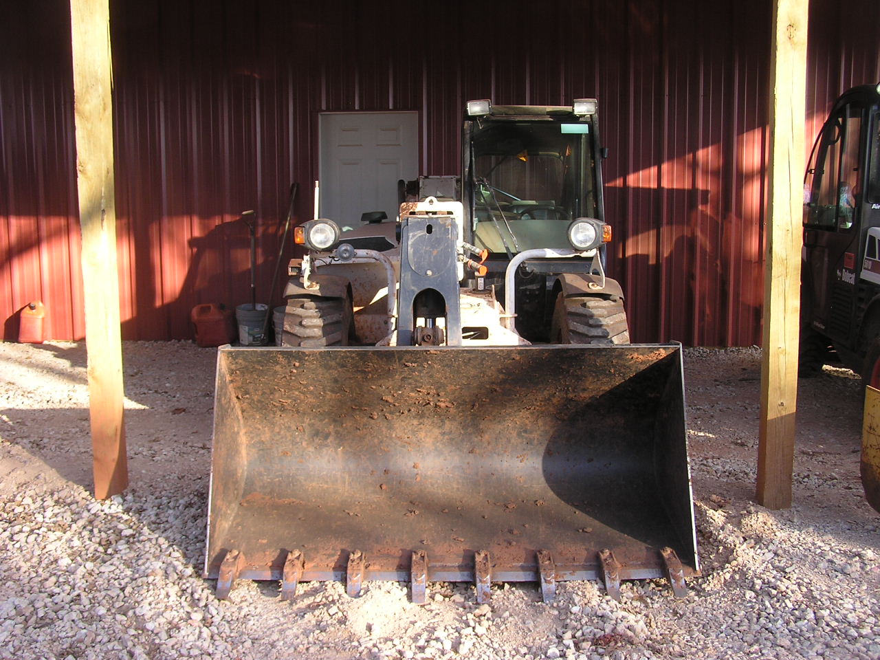

I was trying to show you what a compact telehandler can do, compared to a skid steer. Here is another link: http://www.tractorbynet.com/forums/bobcat-construction-equipment/160568-compact-telehandler.html
The V417 has a SSQA (Skid Steer Quick Attach) plate and Aux Hydraulic connectors on the boom.
More hydraulic attachments.
Standard attachments.
The V417 is 6' wide, 6.5' high and 13' long. Tire size is 14x17.5. Top speed is 15.5 mph, drawbar pull is 7,000 pounds and it will lift over 5,000 pounds!
Controls are a steering wheel and a joystick for the boom and attachments.
