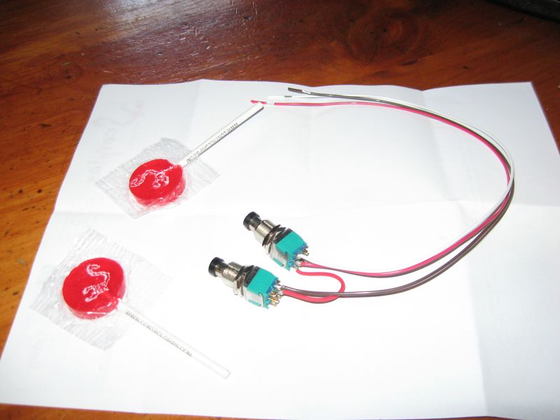

Have you looked at Scorpion Technologies.
They have lots of handles and switches to choose from and will custom make them also. I contacted them last fall to get some switches for a 3rd function hydraulic kit. I have a handle that has knock outs in it and they hooked me up with the button switches to put in it. They are really reasonable and nice people to work with.

Did you buy direct from Scorpian?
Yes I did buy directly from them. We talked a great deal about what I wanted and then they emailed me a diagram and parts list. I gave the ok and they put it together and mailed it to me.

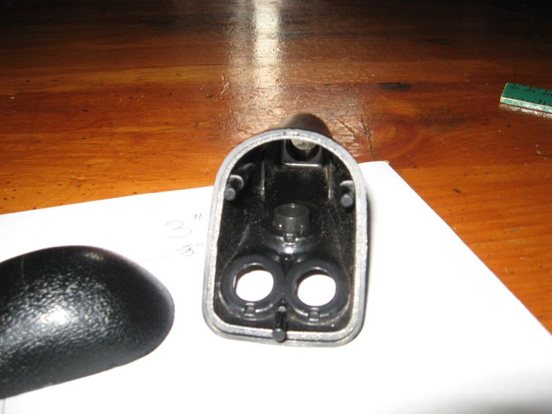

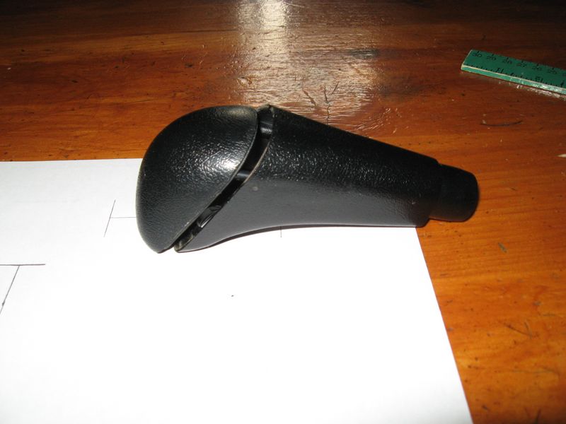

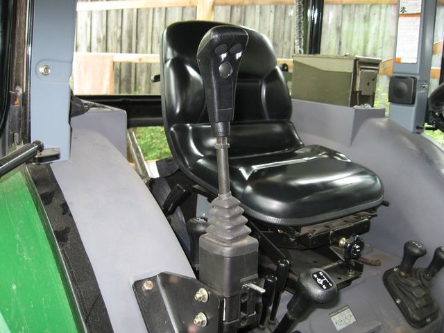

No problem Scotty. I found out about them from 3RRL.
Here are a couple pictures of my handle and the switches I got. I can't find pictures of the switches installed but will get them tomorrow.
