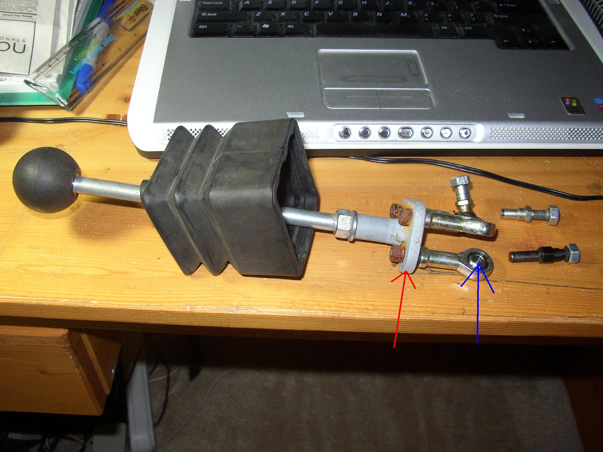

Does anyone have a pic of the joystick that KennyD has picked out. I mean a pic of it mounted and in use?
   / Joystick Conversion #8
I have that joystick on my homemade Cub Cadet loader. The valve itself has been working perfectly however the Joystick has broken twice. The first time it broke the little triangular plate that holds everything together stripped out because it was made of aluminum. I made a new one out of steel and it has been holding up well (see Red arrow in pic). Now, the little ball joints keep coming apart (see Blue arrow). I am waiting on some new better rod ends that I ordered that should fix that problem.
