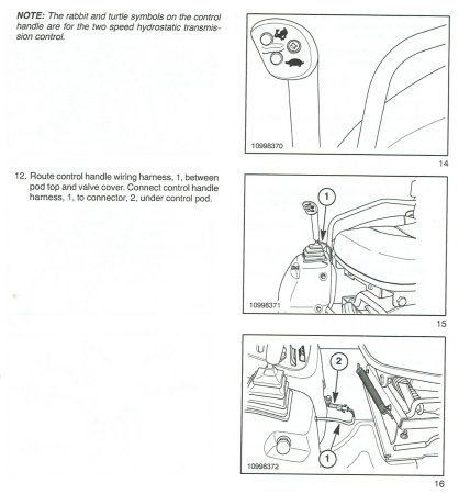

Mine stays in place just fine. Is it seated on all 4 edges ???
Maybe you could try a small dab of silicone adhesive caulk here and there to 'weld' it to the plastic shroud. /forums/images/graemlins/confused.gif

I noticed if I keep the boot pushed down on the joystick shaft it allows a lot more flex and is less likely to pull away from the base.

I did what Jim recommended but I also found that if I rotated my boot 90 degrees is stayed put in the base (not sure why however). I also routed the wire from the rabbit/turtle switch under the boot to keep it out of the way. I was careful to give it enough slack under the boot so that it did not get caught in the mechanism. I have checked it on a regular basis and so far all is well. /forums/images/graemlins/grin.gif

<font color="blue">I also routed the wire from the rabbit/turtle switch under the boot to keep it out of the way </font> Isn't that the way it supposed to be ???? If your wire was out, someone may have assembled it incorrectly. Maybe the boot was rotated also ???

tc35dforme New Holland instructions show the wire outside the boot. See my attachment, and thats how it came to me. Unfortunately I caught the wire on everything (it also looked like the devil) so I quickly changed it and all is well now.

I stand corrected .... I guess ???
Common sense would look to put the cables inboard. I would hazard to guess that the vast majority of us have the wiring routed through the plastic cover...then up the boot.
I'm going to the lumberyard ( next to the NH dealer ). I'll check out the units in the yard...just for giggles. /forums/images/graemlins/grin.gif

You'll get no argument from me on that statement. However, at the time of my purchase all the TC-40Ds that I looked at sold by different dealerships did have the control wire routed on the outside of the boot which made no sense to me.

Here's a link to my original No Joy Joystick post back in 2001. Notice that my cable was routed up through the boot instead of on the outside. I bet NH changed the routing when they changed the style of joystick shaft although I don't have a clue why they would do that? /forums/images/graemlins/confused.gif

Jim I'm thinking that was a move by New Holland to keep us all on our toes, or at least to confuse us. /forums/images/graemlins/frown.gif
