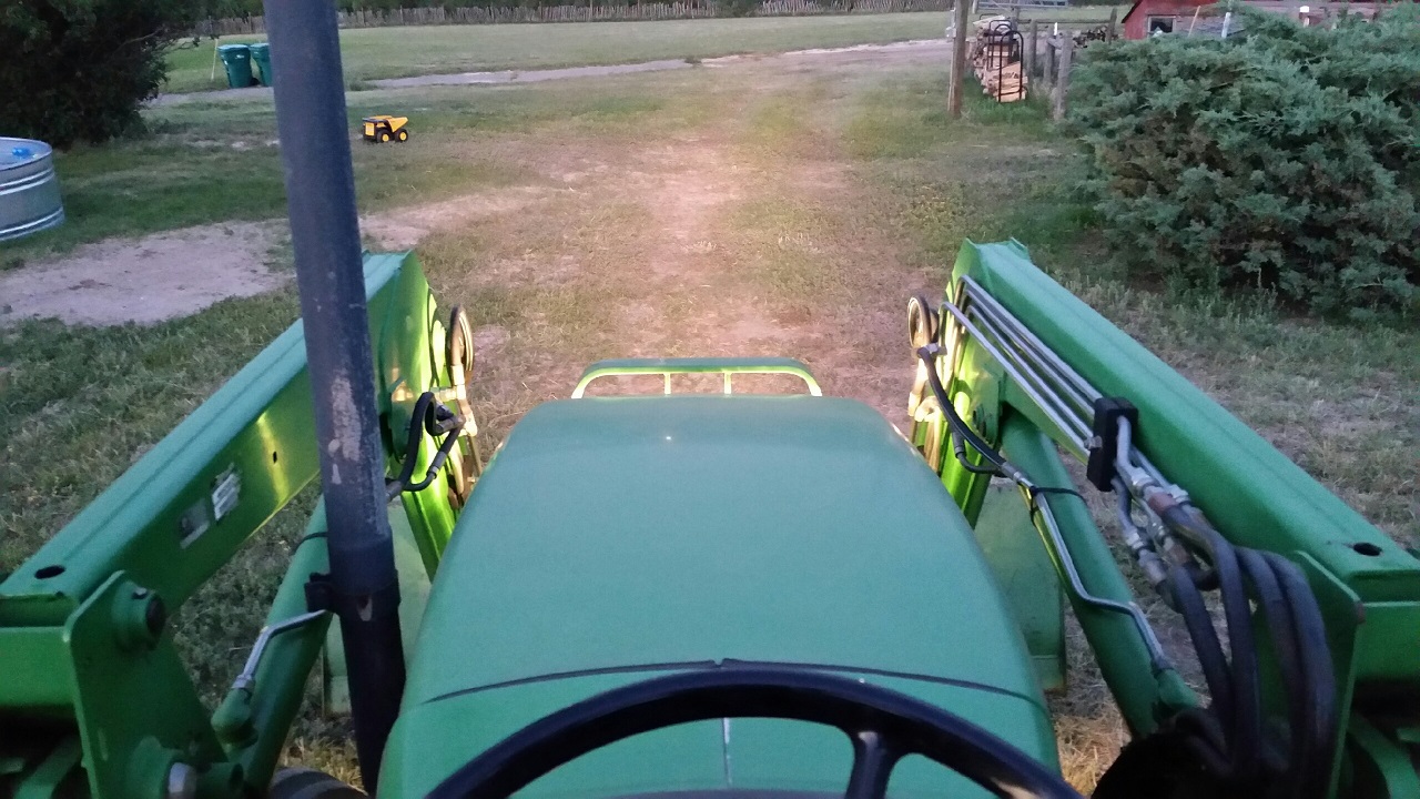

I joined the club and bought a used JD 5105 with a 521 loader. I've had it for about a month, and like it quite a bit so far. I've used it for a little bit of driveway repair to get the hang of everything. I've moved a bit of dirt around. I'm building up a leveling pad for a 10x10 shed this week. I also picked up a box blade and have just started to learn how to use that. I've used it to move around some unsplit firewood and other heavy items. It's really handy for that. The capacity of this tractor is pretty impressive for its size.
I grew up using a 4020 with an F11 loader, so this isn't too big of a jump for me. I didn't do a lot of dirt work with it growing up, so I'm still learning how to do that.
Here's a pic from the day I brought it home. Don't worry, I put the ROPS up right after this. I had lowered it to trailer it home.

Welcome to TBN and the forum. Looks to be a very nice unit - box blades DO take practice. Suggestion - update your profile and tell us where you are located.

Cool! Very nice machine. Hope it gives you many years of good service.

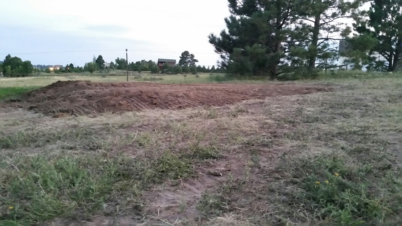

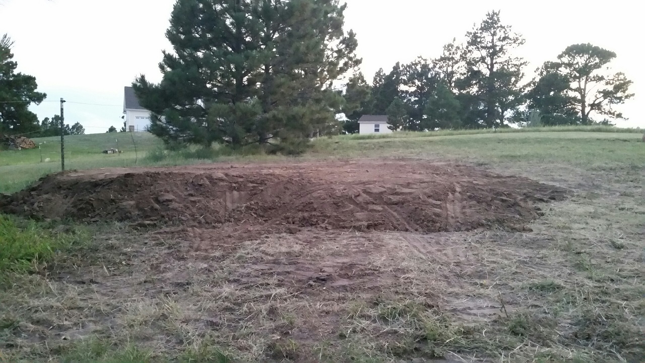

I worked a little more with the box blade tonight. I dug up an area I wanted to lower a bit for drainage and used the dirt on a leveling pad for a shed. I tried adjusting the angle of attack on the box blade, that helped quite a bit. I tried working some with the scarifiers all of the way down. It takes quite a bit larger bite with them in the lowest position, to the point where it would dig too far and start spinning the tires. To resolve, I practiced using the draft control lever to control the depth and got fairly good at it. That's an option on this tractor, and I'm glad to have it. (One of my projects for next year is to flatten out a spot for a shop).
I still have some work to do on my leveling pad. I'm usually racing the sunset after I get home from work. It's only for a 10x10 shed and it's between a couple of trees and against a fence. It's almost too big of a tractor to work in that spot. I'll get it done, just takes a bit of time. It's good practice anyway.

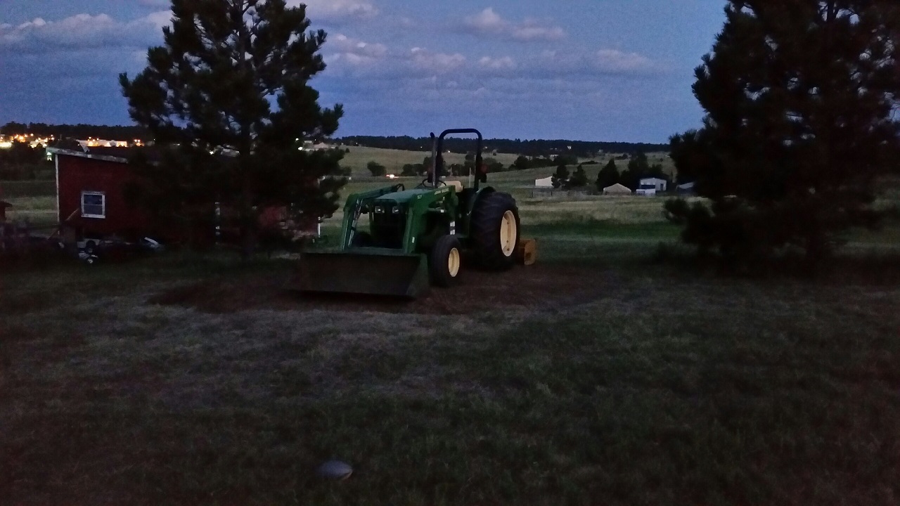

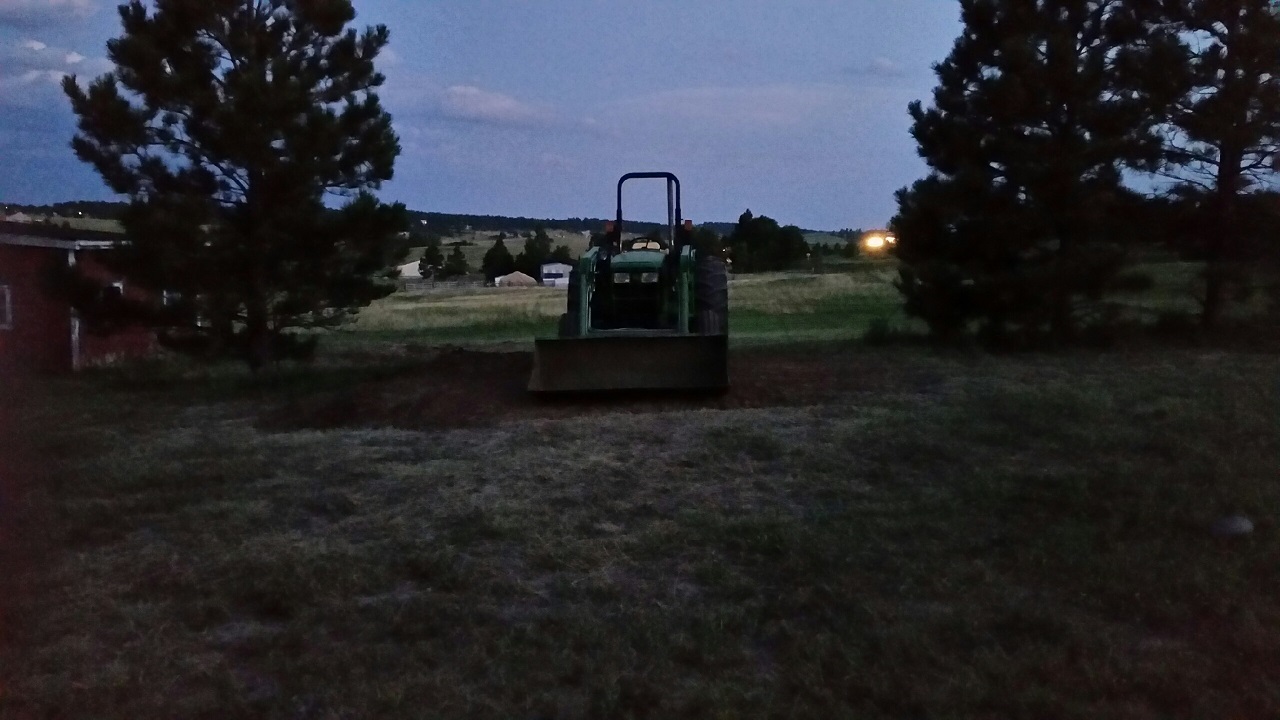

Almost done with the pad for my shed. It's taking a bit, but I'm getting the hang of it.
