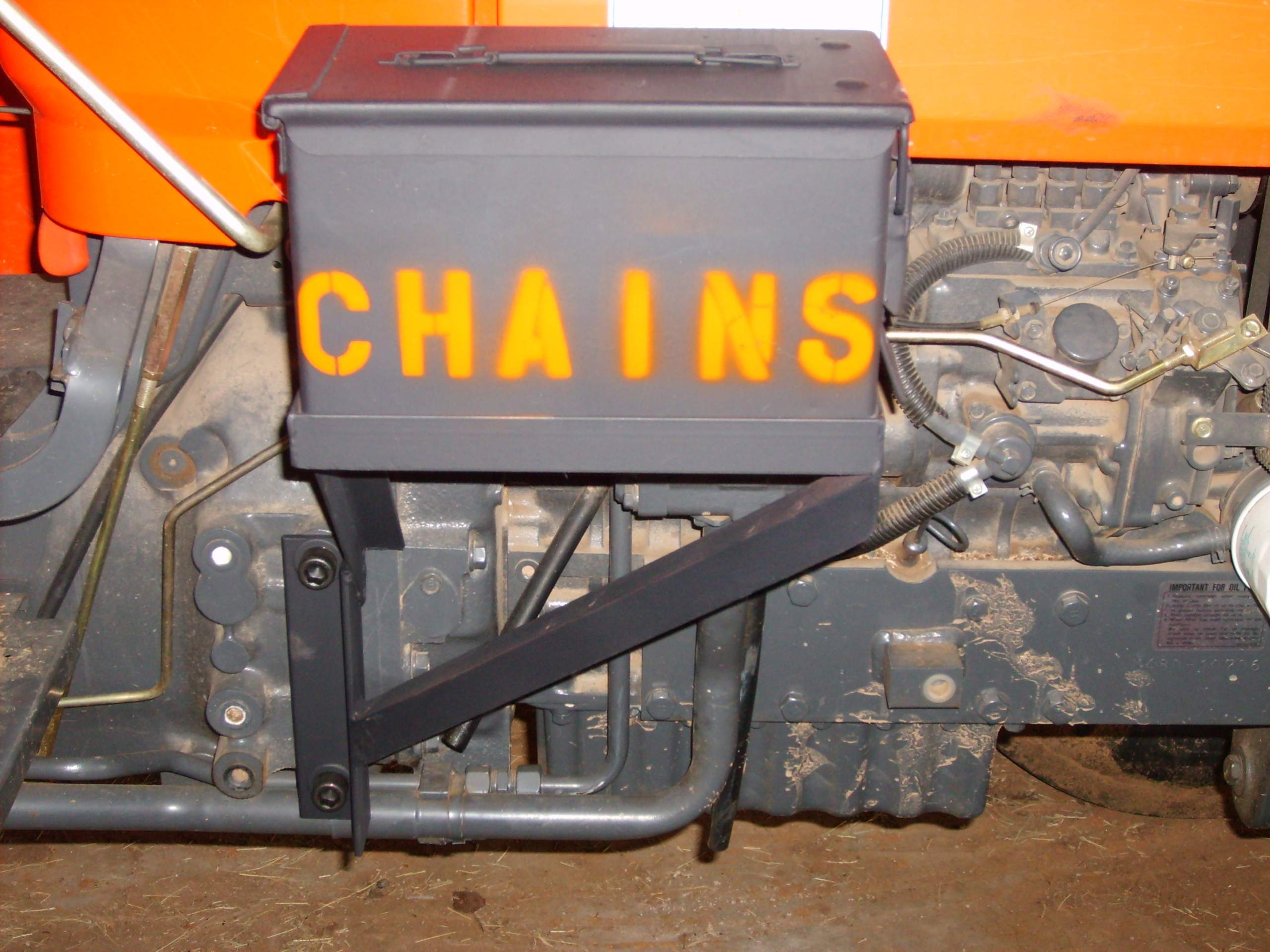

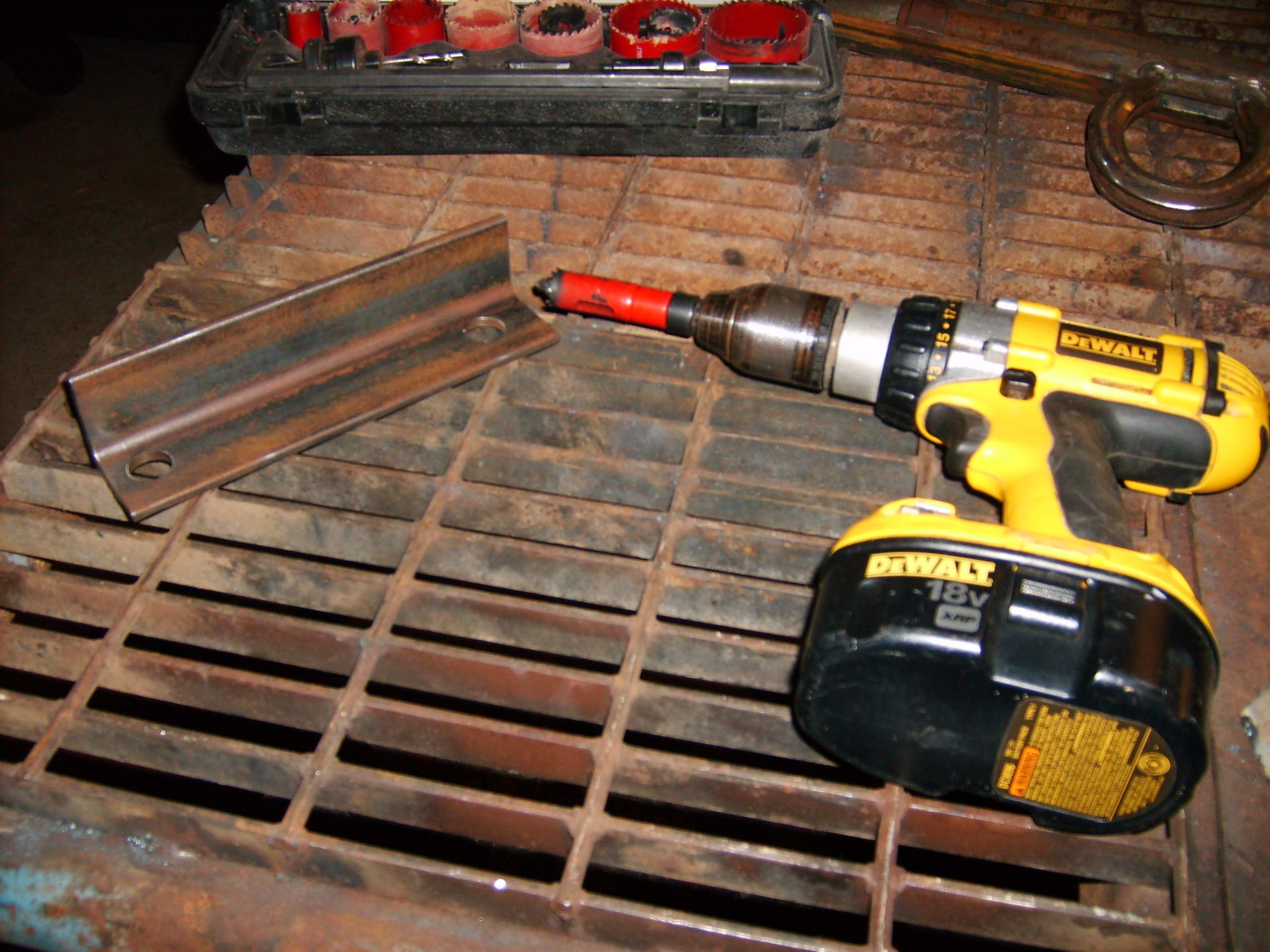

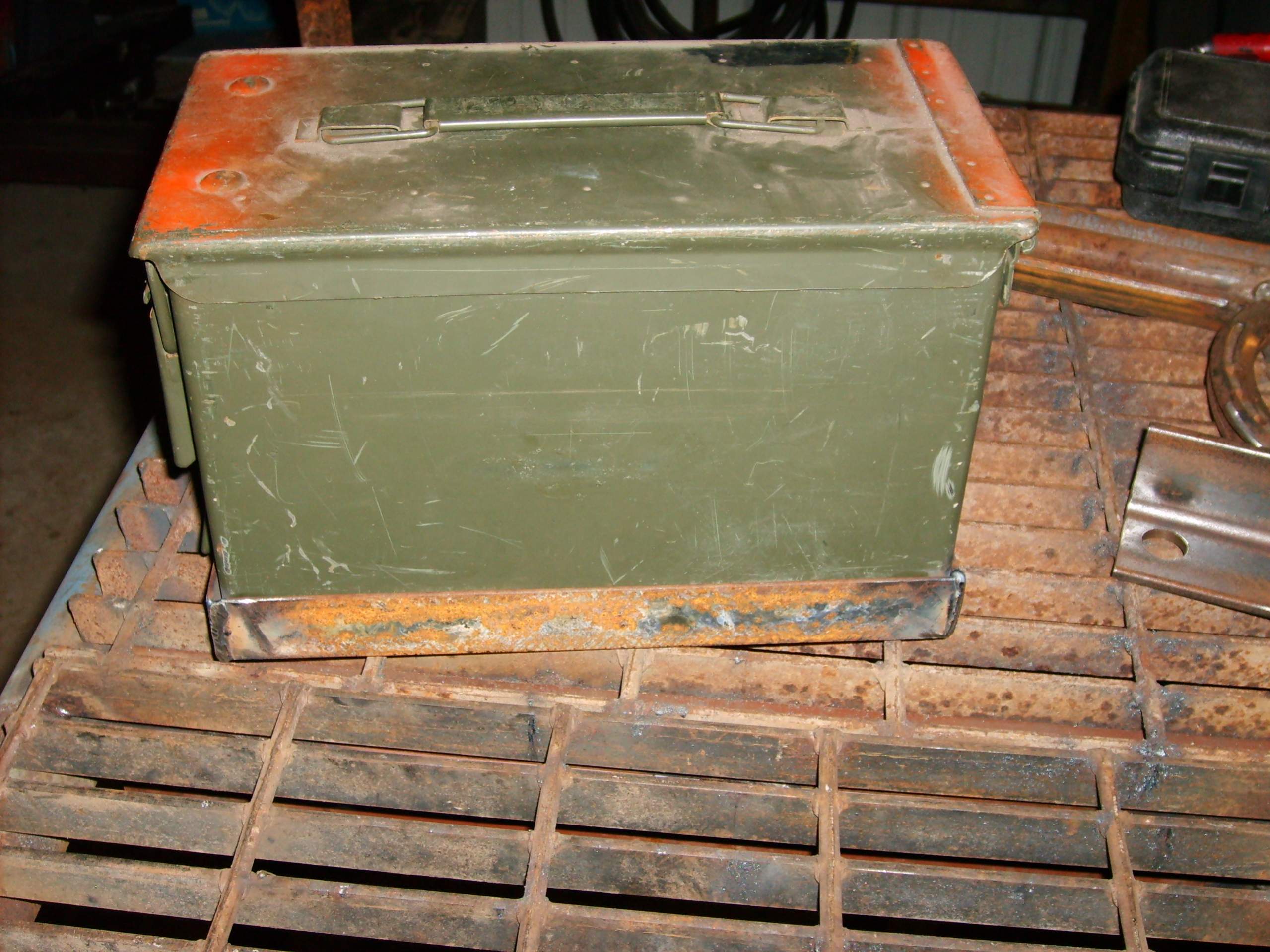

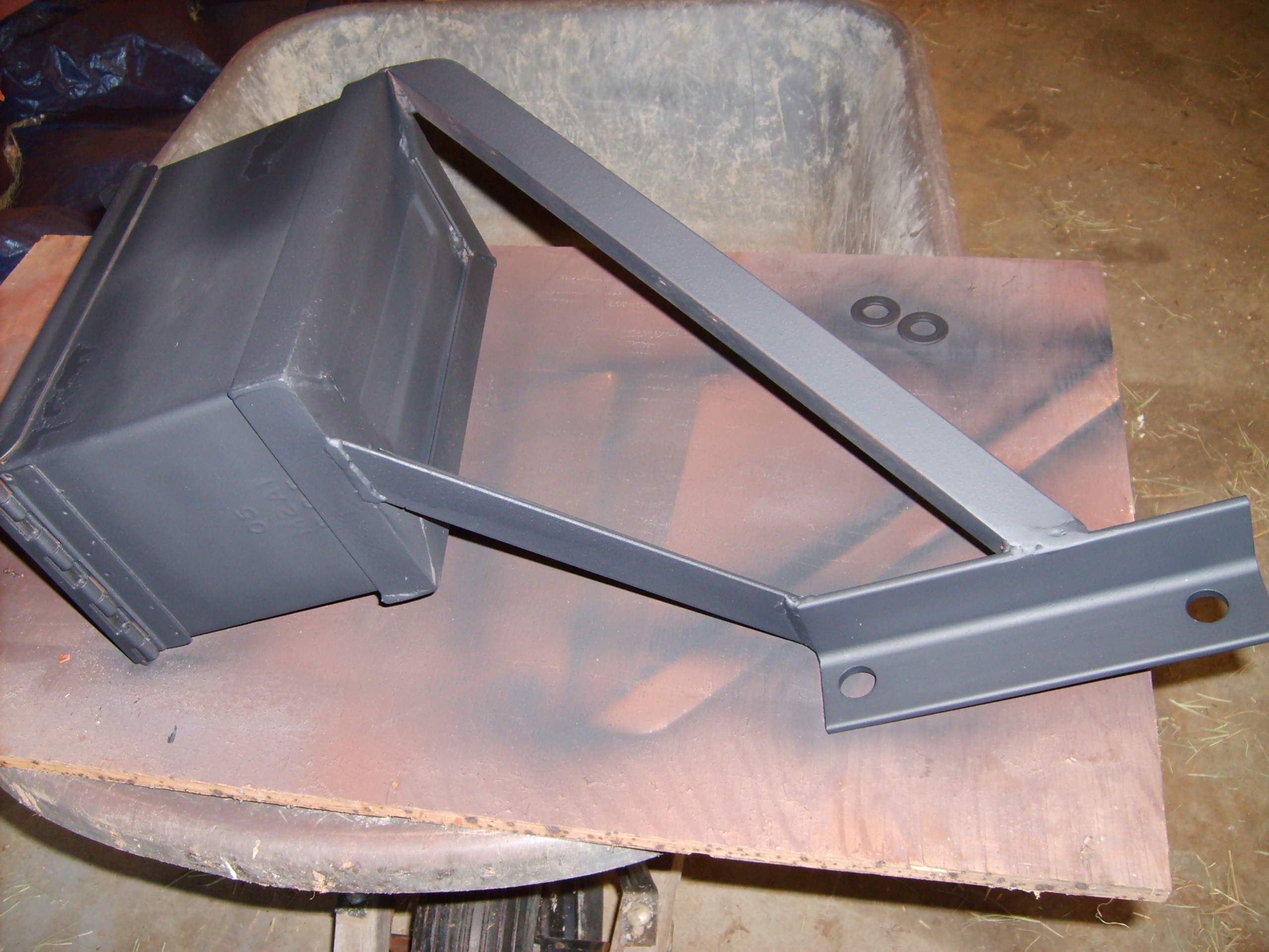

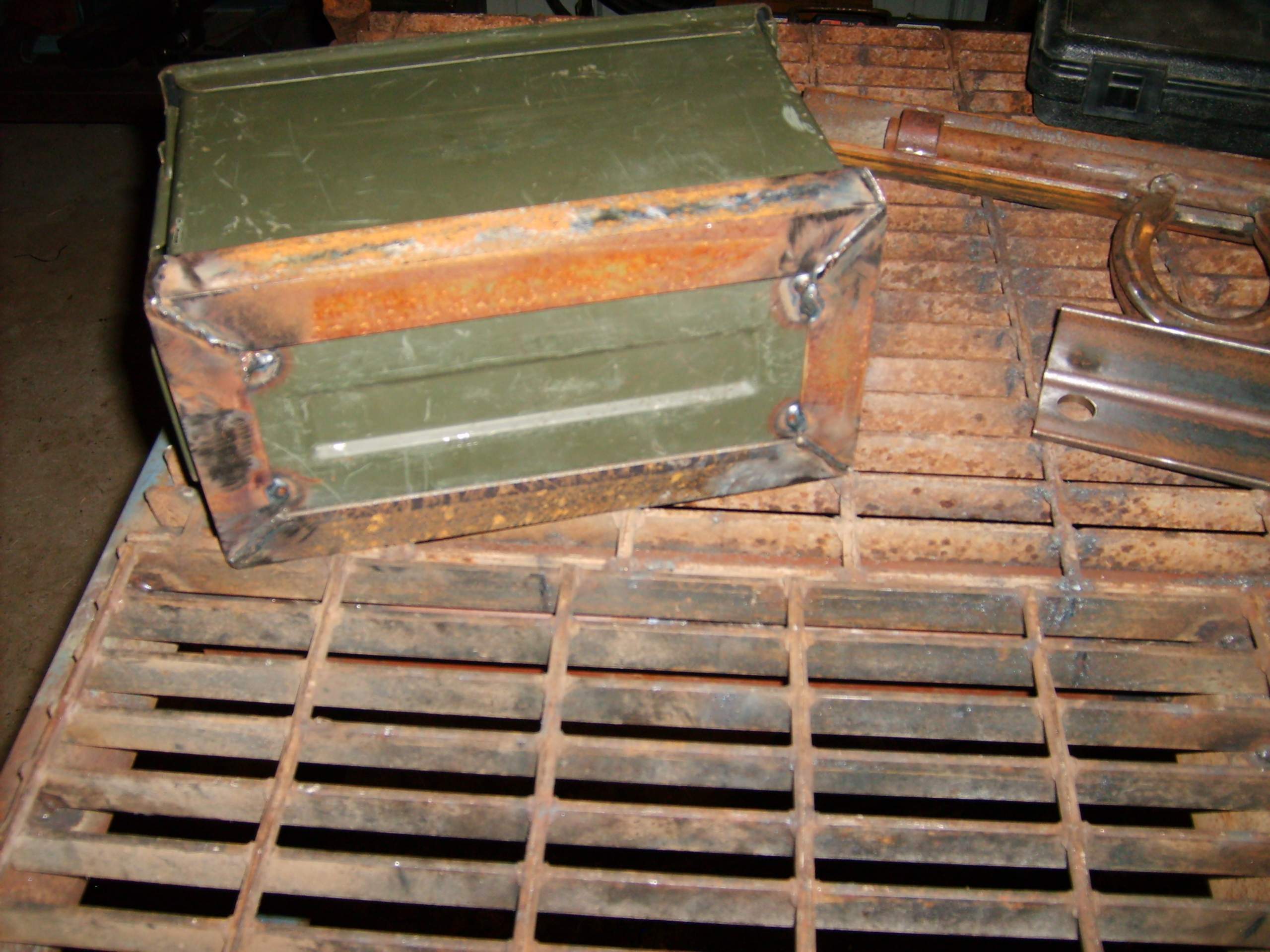

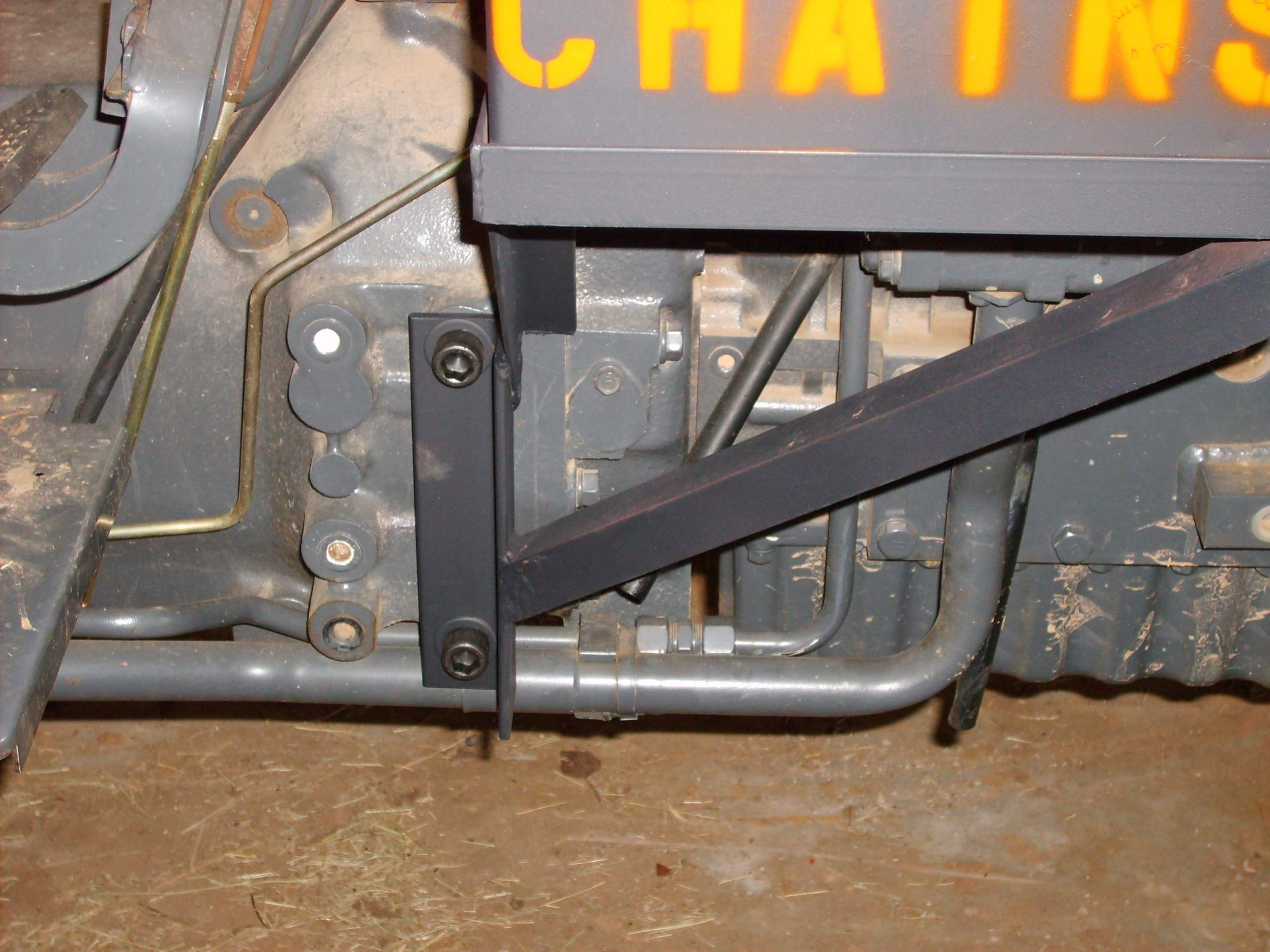

No, I'm not doing a stretch with Cool Hand Luke or did I go out and buy some chains for my tires. I joined Larry (guglioLS) & Rob (3RRL) and possibly others that I can't remember and made a place to put my chains and hooks on my tractor. The floor board and under the seat wasn't cutting it. They gave me the ammo box idea but unfortunately my ammo box isn't as cool as their ammo boxes. Mine is just an average .30 cal box but readily available at my Farm & Ranch store. The angle iron was free, box was around $5.00, bolts to mount it were $3.00 ea. :shocked: at Fastenal and the paint I already had. I didn't do the greatest job of taking pics in steps but you get the idea. BTW, works great and sure beats what I was doing. Right now it's holding 1- 20' 5/16 chain w/hooks and 1- 18' 1/4" chain w/ hooks with a little room to spare.

The final product painted, labeled and mounted. Yes, that's my dirty tractor it's mounted to and yes, it's mounted to the FEL mount area. When the FEL fairy leaves me one I'll modify the chain box mount!:D:thumbsup:

Wow, very nice work. This is the coolest site ever. Where exactly did you mount it to the machine? A wider picture including more of the tractor would help. Did you mount to pre-drilled holes in the tranny case?
   / Joined The Chain Gang

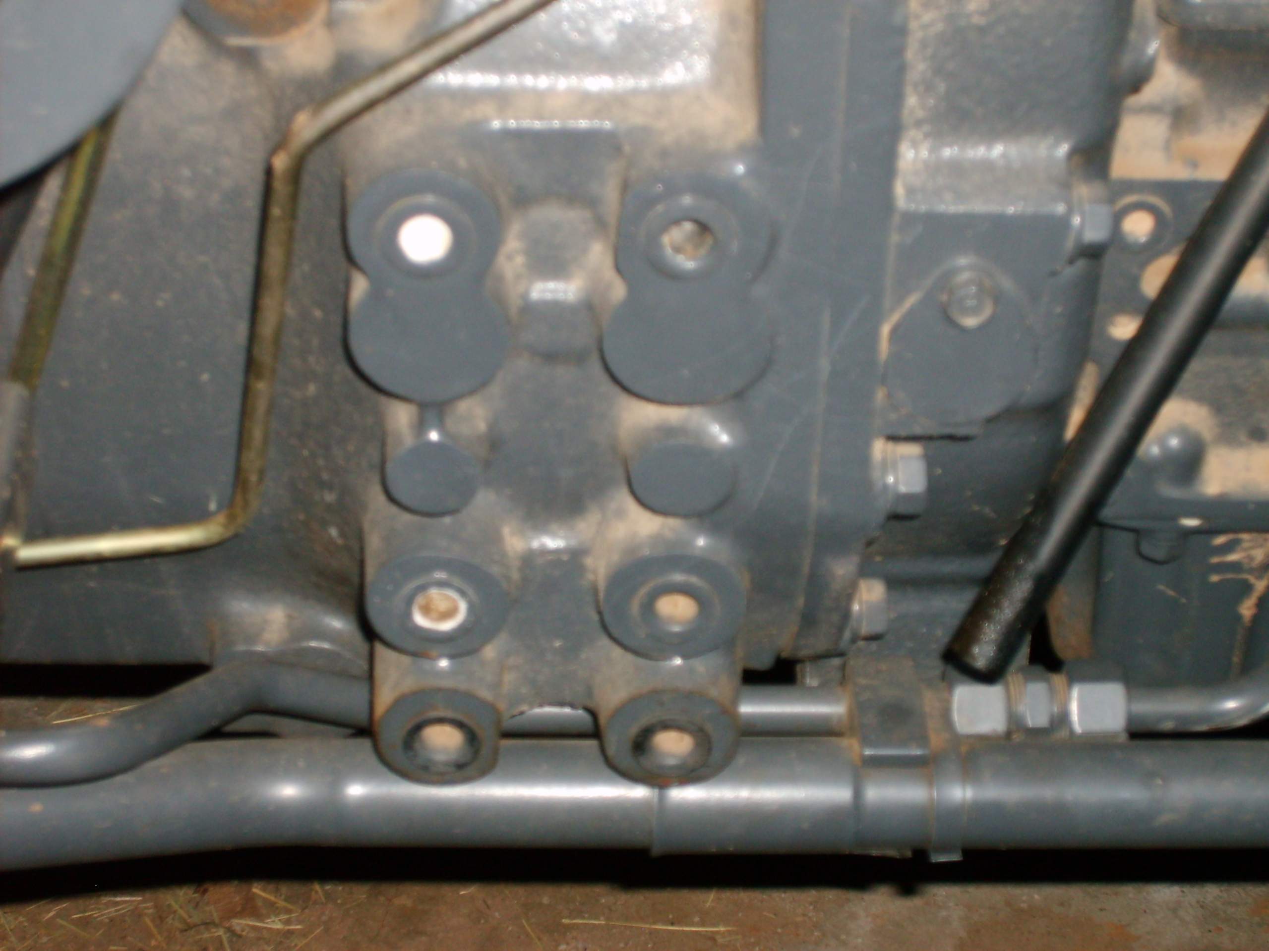

Sorry, I didn't take one of it from a distance or wider. I can but it will be tomorrow. Thanks for the compliments. Yes, it's bolted to the pre-drilled holes where the front end loader mounts.
   / Joined The Chain Gang #5
Looks to be on the right side where a FEL would mount. You can see the brake peddels in pic 2 and 3.
