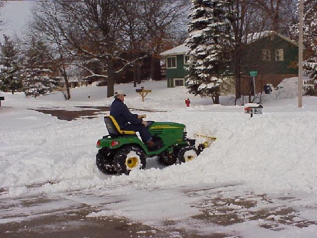

Hi Brian,
If your primary purpose is to remove snow, my opinion would be to just use the front blade with dual hydraulics (up/dwn & angle). I will say that I have a 45 loader and have been amazed at all the chores I find for it, but for moving snow I just use the blade. I have an X585 and find that with the 4 wheel drive that weight is not necessary on concrete. I would be nervous about breaking something if I had more traction. This is with turf tires by the way. The only concern I have is the down force that my X585 puts on the blade while in float. I don't think Deere has a fix for that yet. I added a spring to my blade to offset that down pressure. I plow my drive which is 3 cars wide and goes to 3 buildings on the property. I also plow the street in front of my house for the heck of it! What ever you come up with, I hope you have a lot of fun.
Joe in Wisconsin
