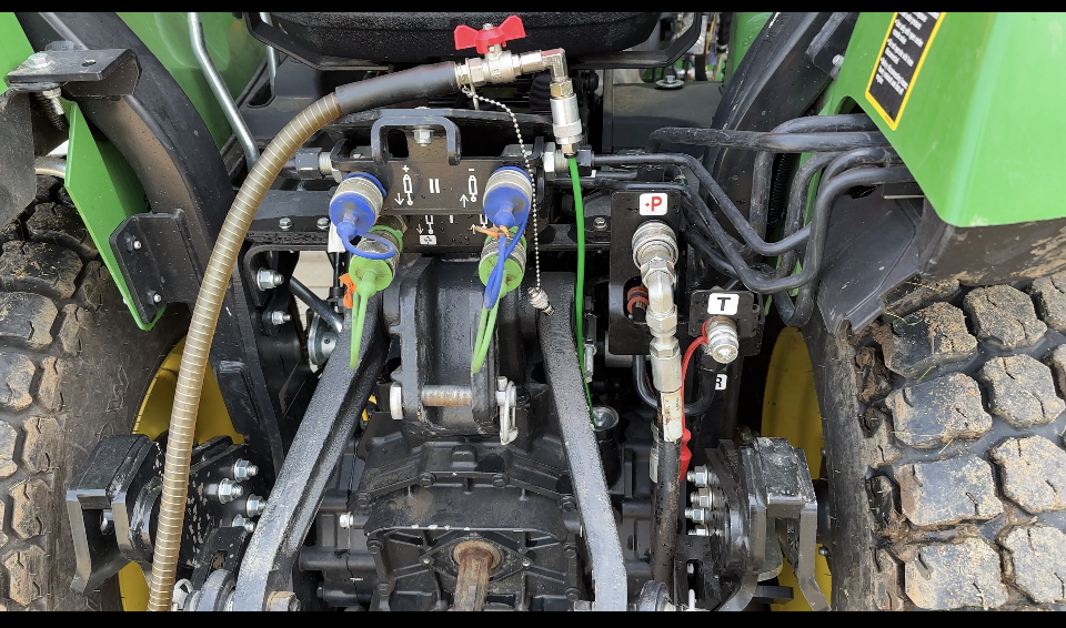

I used my Fluid Extractor to change the transmission fluid on my Deere 2032r. My thought was to remove as much as I could via the extraction to help manage a potential mess with 5 Gallons of fluid in a pan. The extractor basically got all of it out. I know that some will say to never use an extractor because it wont remove all the fluid- but it sure saves a mess!
I also made a youtube video if you care to watch.
Hope this is useful to you in some way or another.
Chris

After you finished with the evacuator, how much more fluid came out when you finally pulled the drain plug?
