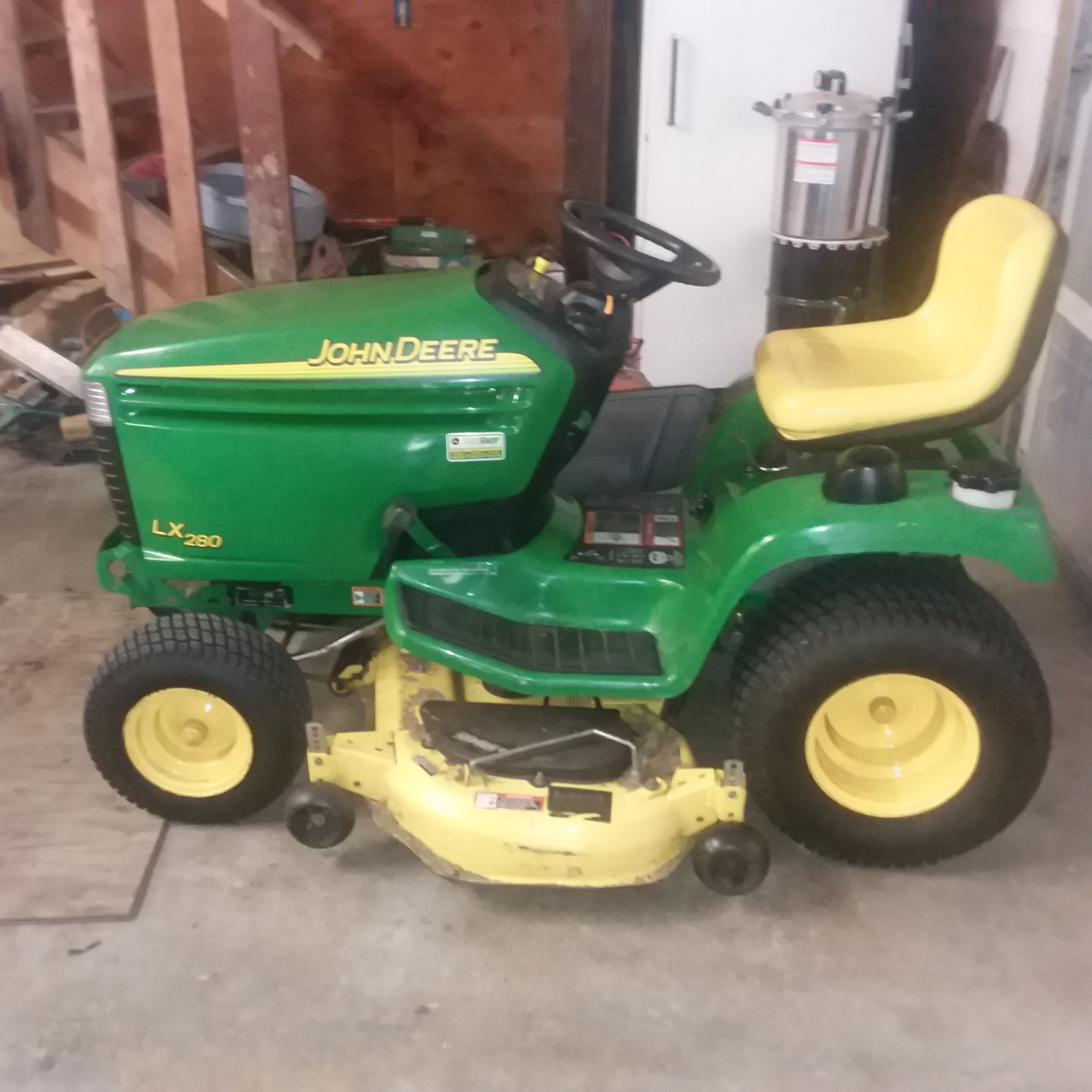

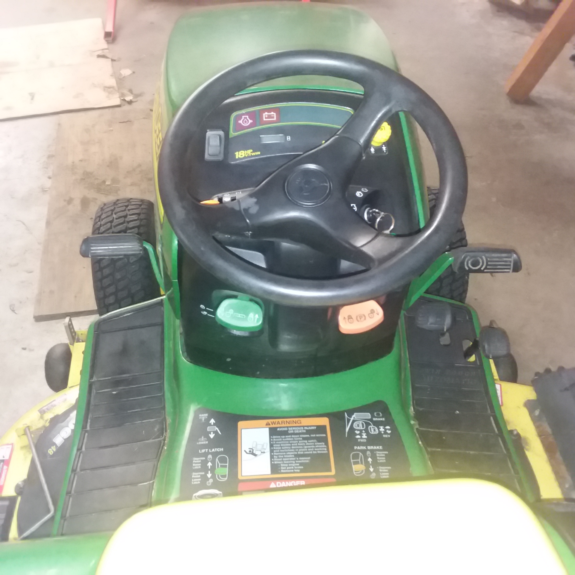

Tires feel pretty hard so will check the pressures and lower as I won't be bagging grass. The deck is in mulch mode but without a manual will be leaving it that way for now anyway. Here are two photos showing this mower in it's work clothes.
