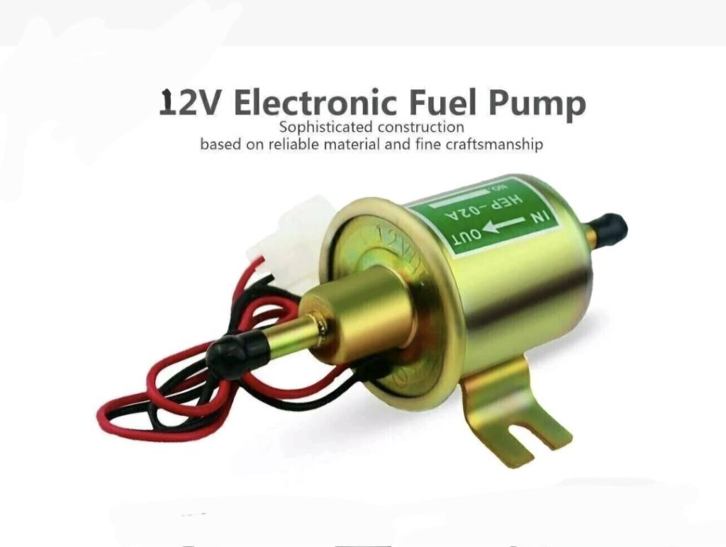

I use this it has a screen. I'd add an inline fuel filter if it doesn't have one.
