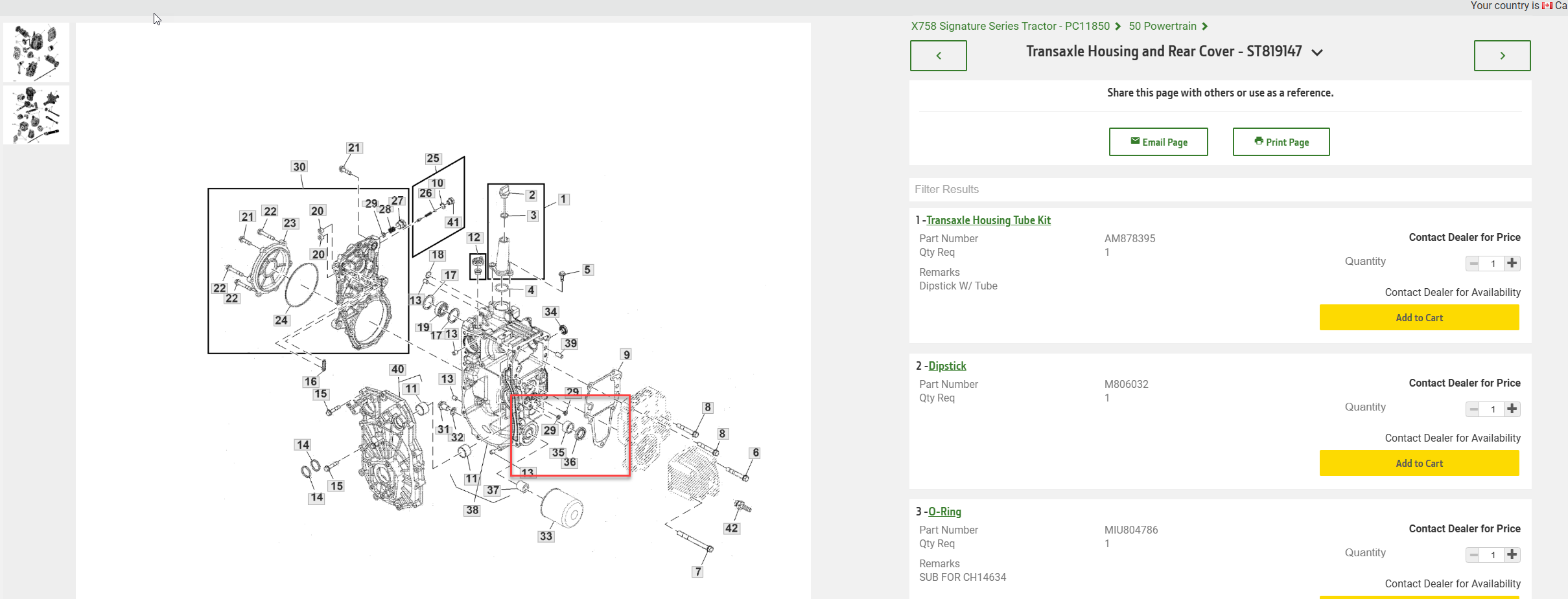

I have a John Deere X758 and a seal is leaking where the drive shaft connects to the rear axle housing , I am trying to find the seal part number so I can order a replacement seal , I have looked in the John Deere parts section and I cannot see the seal listed in the parts diagram ,would anyone be able to help me find where to get the seal part number please.

I think it is item 36 in section 50 powertrain, transaxle housing and rear cover. I am assuming you mean the mid pto shaft seal where you would connect the mower shaft. there are lots of options for rear PTO kits but take a look in section 50 they are all on jd parts website
   / John Deere X 758 seal leak #4
sorry p/n ch14765 is item 36. I would have put the seal with the shaft If I was writing the ilustrated parts catalog

Thank for your help I discovered it was the hydraulic tubing that lifts the deck it had a high pressure leak and was spraying hydraulic fluid when lifting the deck and hitting the axle.
