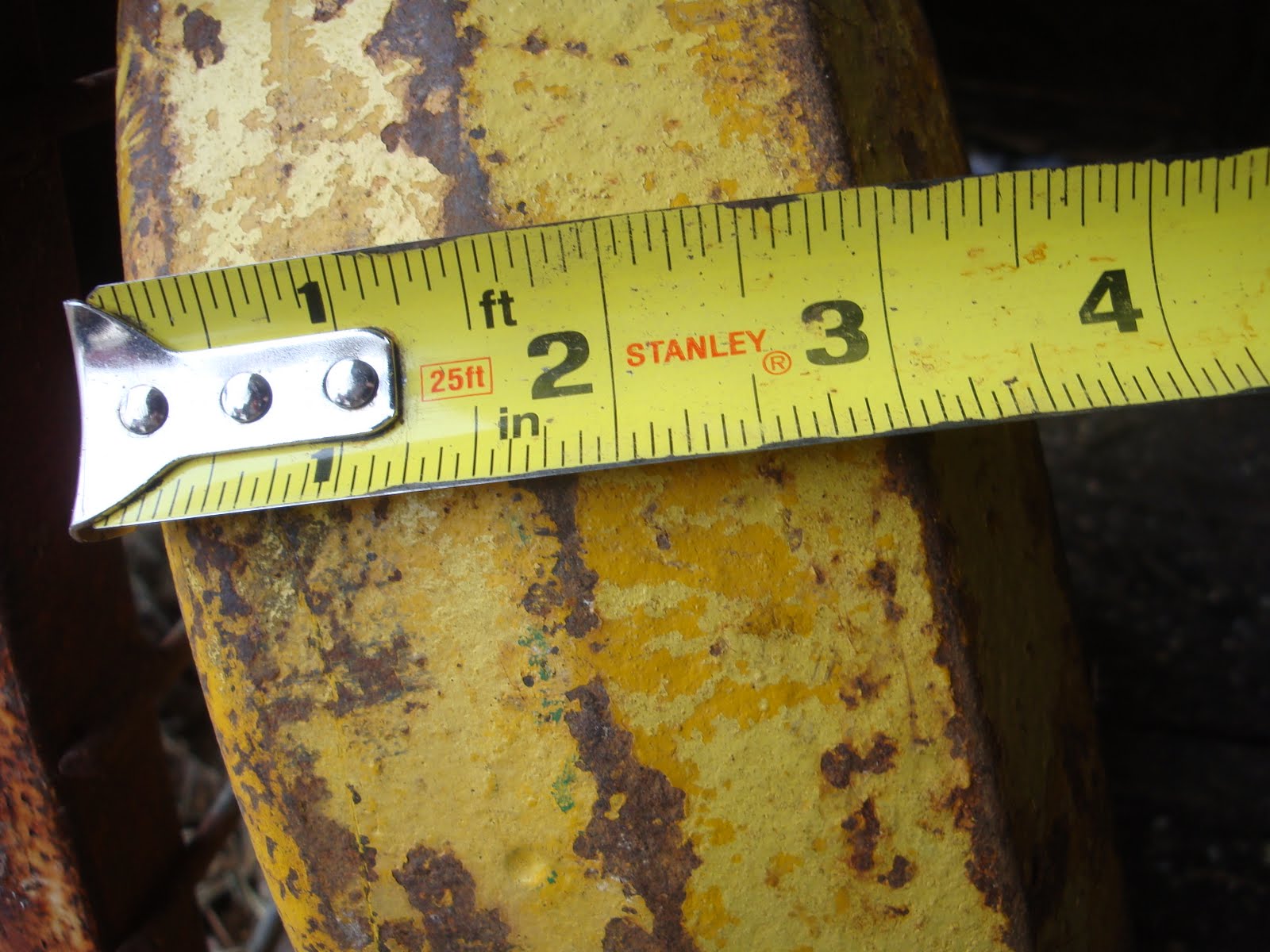

Does anybody know of a reference either online or otherwise of John Deere Weights by tractor? Dad bought a set of weights at auction with a number cast into them: H10377.
There is the notable JD cast right below the part number. They weigh an unbelievable 150 lbs each. They very close to types I've seen online for the L/LA tractors.
If it helps, I can upload pictures.
Thanks in advance for the help!!

A picture would help. What are you wanting to put them on? Chances are they are for a utility size tractor if they weigh that much.
   / John Deere Wheel Weights X-Ref
They came on a pallet with some other wheel weights, wheel weights that I wanted for my 730. I'm not looking to put them on anything...yet. Just trying to figure out what they are first. Following are some pics.

The weights you have pictured are for the rear wheels of an old jd combine thanks for the pics!!!
   / John Deere Wheel Weights X-Ref #5
Yes, that is probably correct. The H prefix is usually for "harvester" or combine parts and R and AR are for tractor parts.
I thought that when I first saw your post but it didn't register. I was thinking "tractor".
