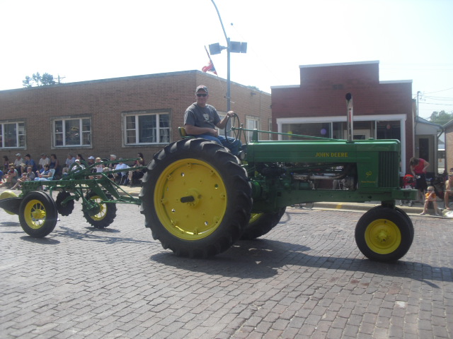

   / john deere transmission noise
My dad's 1955 john deere 50 that I restored 10 years ago and 44 plow I restored last summer in 2012 otoe county fair parade.
   / john deere transmission noise #9
Bearing is my first guess as well and that's probably the only option. Photos of your restoration would be very appreciated.
I had a #44 plow years ago and it did a beautiful job and pulled easy. Might still have the owner's manual for it. No wonder John Deere went to the head of the class with such a quality plow..
