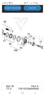

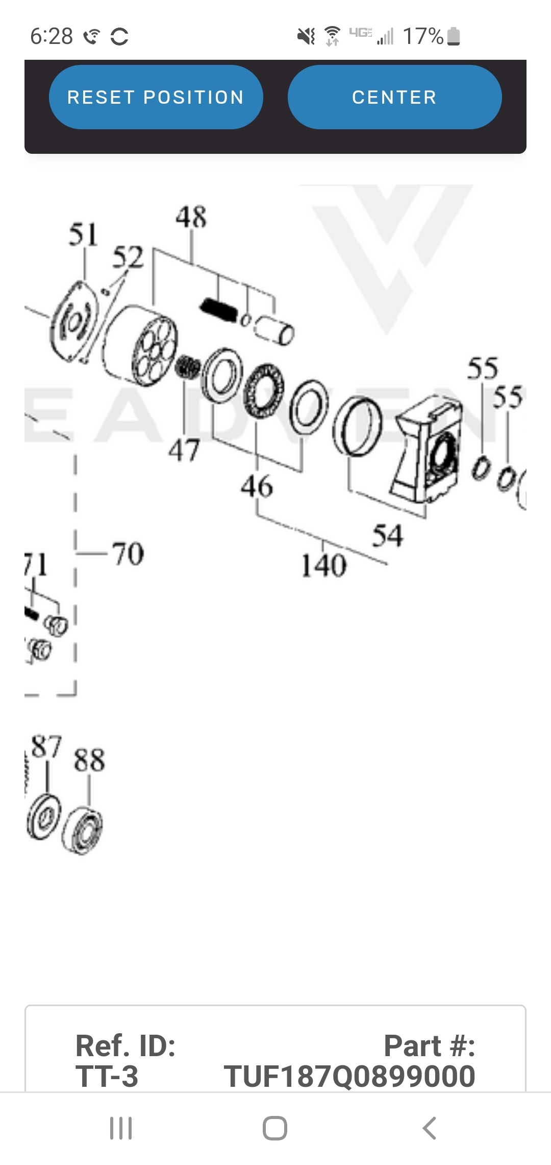

John Deere z950R
Hello,
I have a John Deere z950R mower with the tuff torq trans axel. Bearing blew on the horizontal drive shaft next to the brake disc. When ordering replacement parts, tuff torq site shows a second snap ring and a spring located against the pump (on the rigjt side of the swash block). I have been to 3 dealers and no one can identify where the snap ring goes for the spring behind the swash block. The shaft has no groove in it. Part numbers 47 and 55. Does anyone have any idea where the snap ring goes? Thank you
