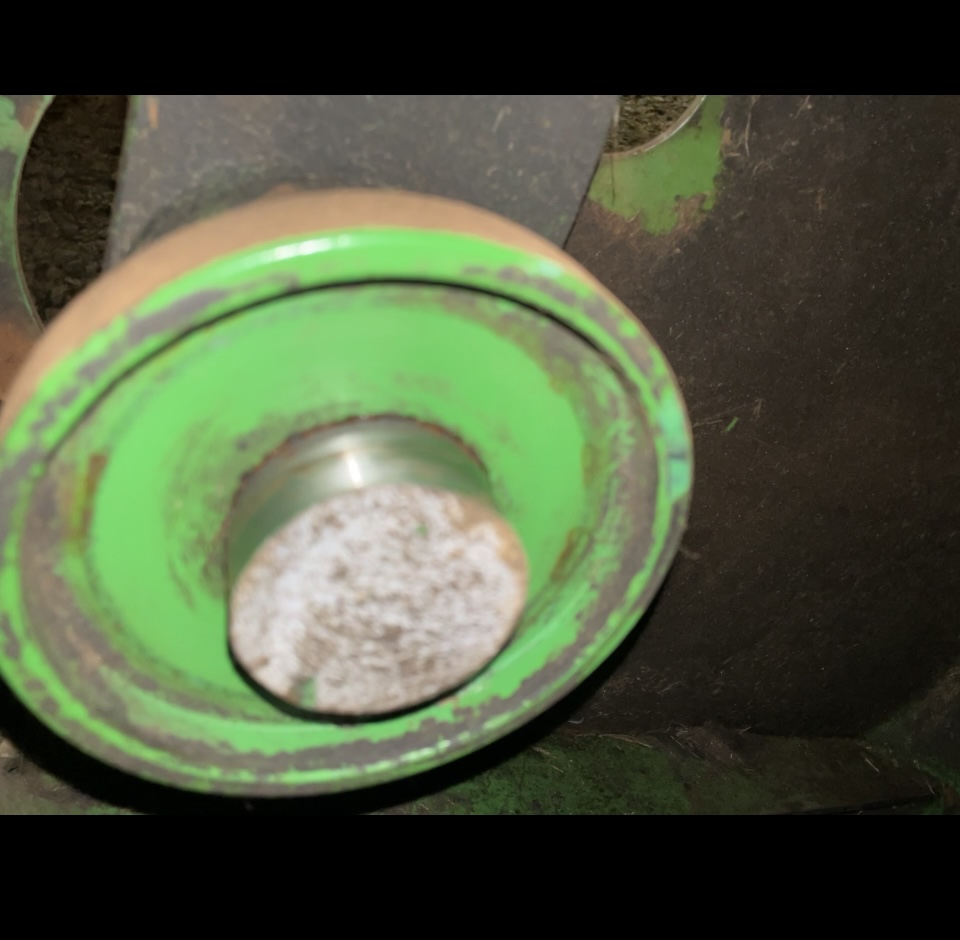

The output shaft on my MX6 rotary cutter broke and is stuck in the stump jumper attachment. When I look at the manual/part diagram, it appears that I should be able to drive the broken shaft with a sledge back out towards the broken side. I have not been able to do so. The cutter is about 9 years old and in relatively good shape. My plan is to replace the gear box as it appears cheaper than purchasing a new shaft and rebuilding the gear box (which is beyond my skill set), but I don't want to move this direction until I'm able to remove the old shaft. Has anyone experienced this or have recommendations on how to remove it?

Have you tried to heat up that green sling ring and seeing if you can pull it off . or try using a center drive to put a pilot hole as close to center if possible. then use a 2 or 3 jaw pulley puller to remove the green ring.
