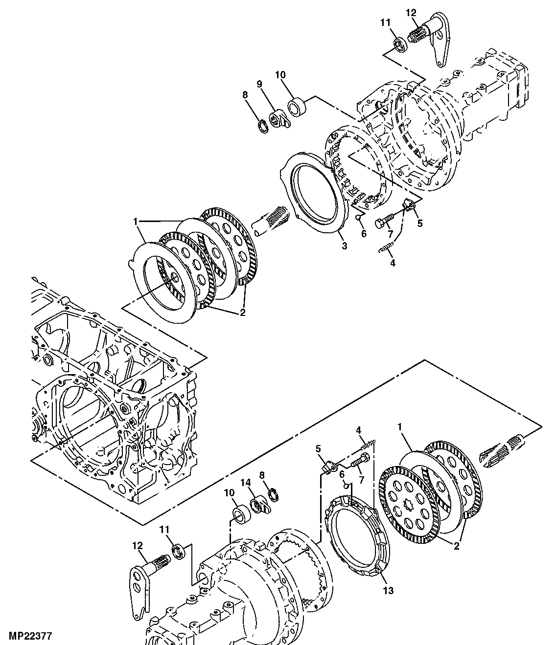

I step on the right brake, the tractor turns easily and is silent. However, when I step on the left brake, there is a seriously ugly growling noise in the rear end and I mean it's loud and gritty. My first thought since the planetary gear set, bearings and shaft are totally new, is that the noise is coming from the spider gears? Puzzled though because if it was a loose of damaged spider gear, it would make the noise from either brake being applied. Also seems to make noise when going fast as in high gear and maximum engine RPMs and you just come to a stop going straight. No noise slowing down but just as the tractor stops there's a short burst of loud growl. I'm snowed bad guys. What to do. Tractors parked until I figure it out but it's snowing right now.

   / John Deere rear end making noise #4
I'll guess LH brake assembly

Yes. To make a long story a bit shorter, we bought the tractor new. I replace the hydraulic oil the first time, I believe it was at 50 hours. Immediately thereafter, I began getting the noise. Not long ago (about two months in fact, I was running gravel and heard a steady thumping sound directly proportionate to my speed coupled with what seemed like my rear implement banging from side to side. I went to push a brush pile when the whole planetary gear set on the right side imploded. The two axel sides were completely disassembled and the right side rebuilt including all bearings shafts etc by the dealer, though I assembled the axels to the machine. Upon completion I took it for the test run but it makes the same noise. I'm leaning toward dumping the tractor and getting something else though I really like the tractor. I just need to be able to depend on the tractor and cannot afford to do $3000 again if this is going to break again. I'm certainly open to your input!

The warranty is long over. I finished putting everything back together 2 weeks ago. I initially tore the rear end apart because I thought it might be the spider gear and that it might be a simple fix plus at the time the rear end went, the whole affair locked up solid, and so I figured it wouldn't be loadable on a trailer and so hence I tore into it myself. Upon seeing the damage, I quickly decided to bring the damaged side as well as the other "good" side to the dealer for repair and examination for further damage. My dealer is fairly far away and didn't want to come out to initiate the installation of the axels. My dealer never implied a warranty nor wrote in a warranty, however, we have thrown a lot of money their way and I believe they would work with us. Another note I wanted to mention is when I brought the axel halves home and peeled the plastic seal off, I immediately realized that the clips that hold the brake disc assembly within the axel until installation on the good axel were missing and that one spring that held the brake actuator in place was off and laying on the axel bottom along with several ball bearings from the brake actuator. Both halves were immediately returned and I insisted that the axels be taken apart once again and redone which did occur.
