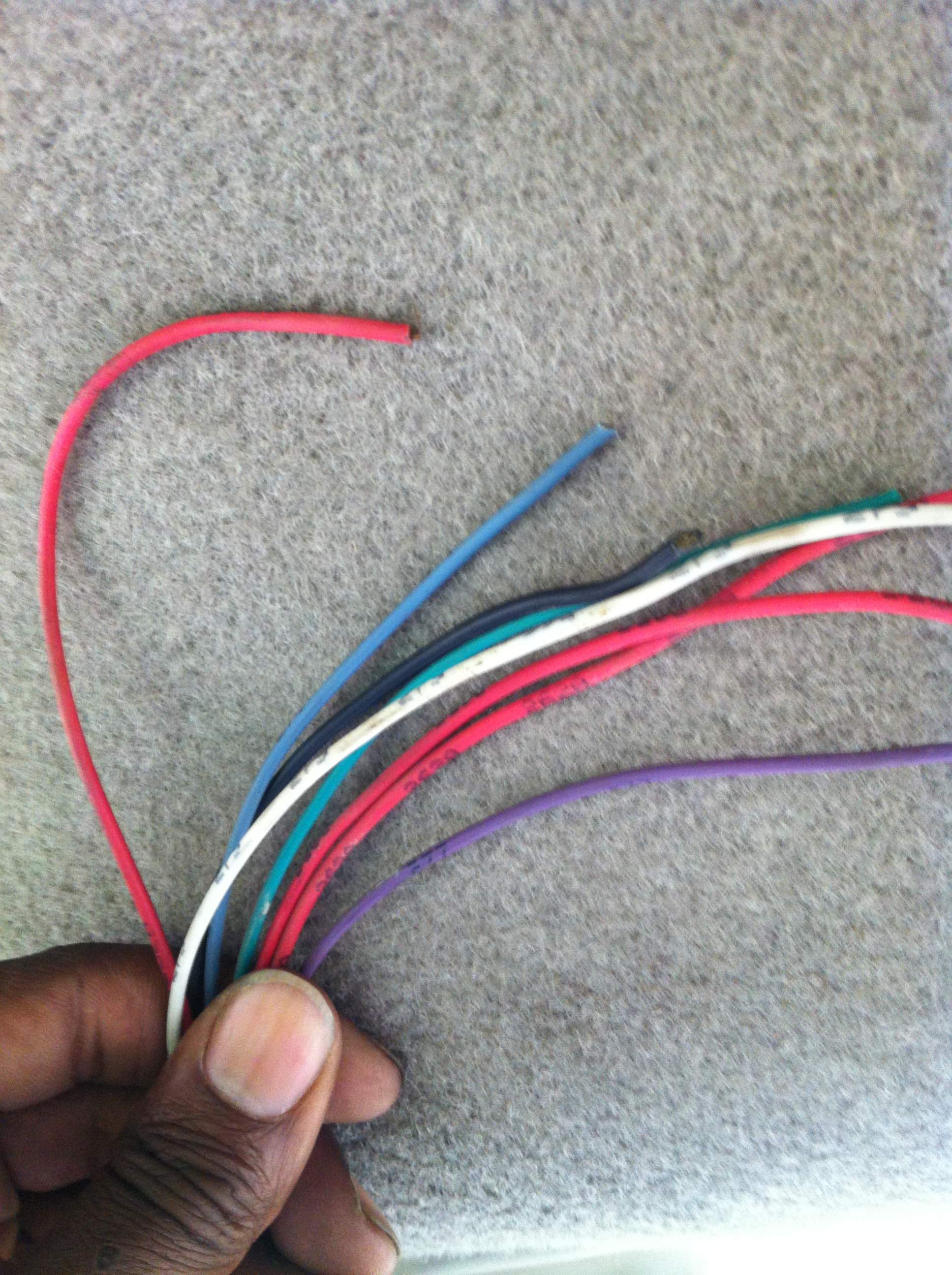

Having problems with locating the memory wire for the radio on my John Deere 5520?????:confused2: I noticed it has three red wires 025.jpg

I'm curious...what is a memory wire?

Its the wire that keeps power to the radio when the key is off to keep the clock, stations etc in memory. Therefore just take a voltmeter, turn the key off and find your wire.

Never heard of a memory wire haha. What your looking for is a continuous power 12v power line. Then there is another line that works with the ignition to cut power to the radio. Acc wire.

Ahh-ha! Makes sense now. Hot wire.... :)
