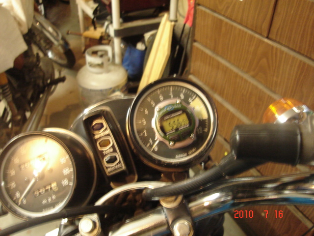

Ditto kebo-- sounds like a trip/call to the dealer would be a good idea.
Failing that, you could do what I do to my bikes- buy a $10 digital watch, remove the band, and stick it somewhere with some of that gummy blue stick-a-pic-on-the-wall stuff!:laughing:
But, really, your radio ought to be able to work properly. Call the dealer.
