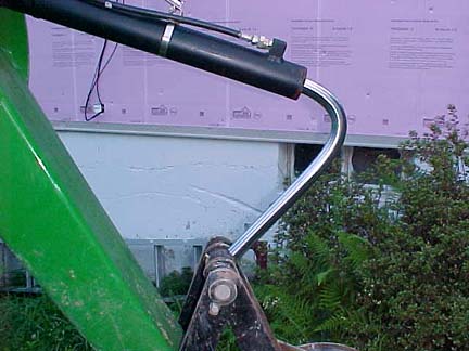

Thought you guys might like this pic

here`s another shot. I think the rental price has been reduced. This is one of the reasons I will be in the operator`s seat of my new machine.

Yikes! /w3tcompact/icons/shocked.gif What's the story behind it?
   / John deere pretzel machine #4
Ouch!! thats gotta hurt. /w3tcompact/icons/smile.gif I've read about that happening several times but never seen what they were talking about. That shouldnt happen even if you were trying to pick up a house>>>>>>Right? that's what relief valves are for I assume. THanks for the pic

I wasnt there when it actually happened. A friend of mine had rented the machine to do some landscaping work in his yard. They had used the machine all day without a problem. At the end of the day he was driving it around the house to load it on the trailer. He saw a couple of small stumps (not from trees but bushes) . He replied "Let`s get our money`s worth out of this rental". Backed up to the first one dug it out in one scoop no problem. Moved towards the second one but didnt get close enough. He had the hoe almost fully extended and was trying to curl the bucket. I guess he was hacking away. I was told by a third party that the machine was rocking pretty good. Then the piston bent in one swift motion. Some explaining and $700 later everything was resolved. Make s the $10-$20 for insurance at the rental counter look good ..huh?

I'm surprised something else on the hoe didn't give out before the piston.

That is truly nasty /w3tcompact/icons/shocked.gif. The hydraulic relief should prevent this type of mishap. As Richard pointed out if the backhoe stops when digging something tough (and stumps are tough), you've got to be patient and dig a little further out... maybe at a different angle until you weaken the object enough to where the power of the backhoe is enough to pull it out. I know that when you're running out of rental time you become impatient cause you want to get that last little job done... been there. /w3tcompact/icons/blush.gif
Judging by how far the rod is extended it looks like the bucket was pretty much curled. Cycling the hoe to the point that it rocks the tractor is NEVER a good idea as it exterts forces on the hoe that the hydraulic relief WILL NOT LIMIT! Disaster is sure to follow. An expensive but fortunately not painful lesson.
