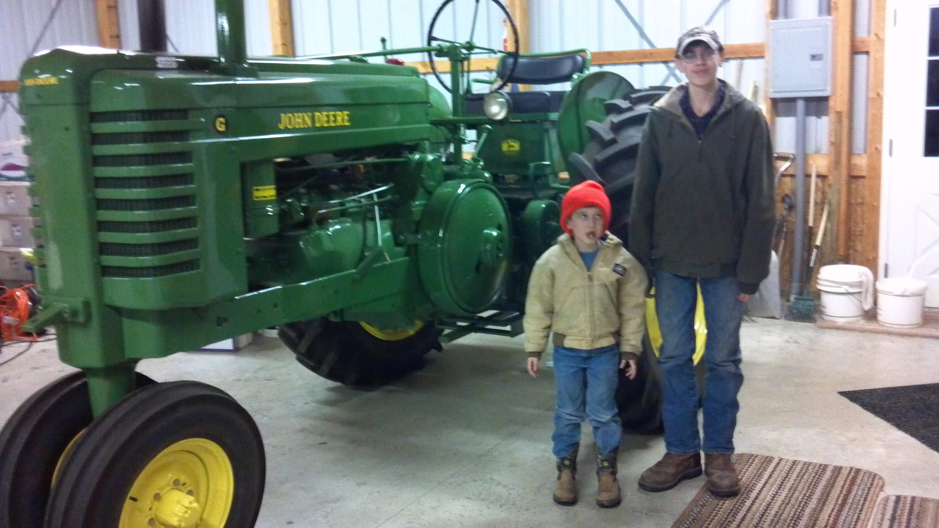

I forgot I had taken this pic of my wifes uncle's tractor a while back. I did the engine work on it before it was painted a few years ago. Its a phone picture so not the greatest.
It had a cracked head. It has been bored out .125 and they put M&W's pistons. She definitly pops!:D
