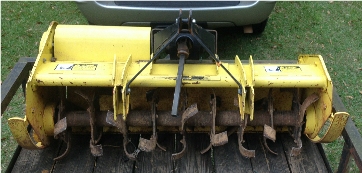

Wondering if any one has Copies, Scans, PDF, Etc. of any an all manuals for
what I am told is a model 48 Tiller or "model number of the tiller is *M02902X525303"
Thanks, Bill

A pic would help. Did JD make a model 48 tiller? The only reference I can find is your post here and another web site.
   / John Deere Model 48 Tiller Manuals

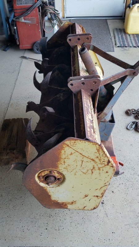

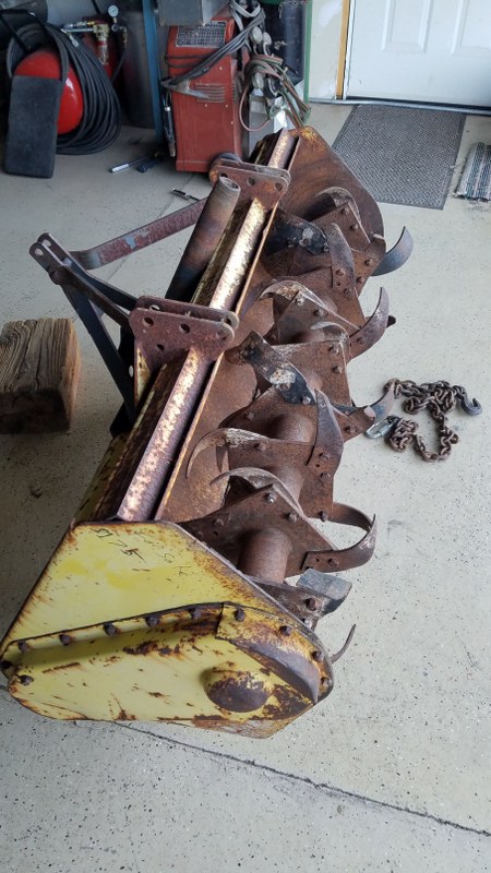

I just got it home today, that was what I was told it may be, after having it at home I found a S/N plate
Not sure if the F035D is a model, a quick search did not turn up anything
I found a parts listing on the JD Website that looks to be identical for ....
48-Inch Rotary Tiller (for 318, 420 and 430 Tractors)
20170921_143739_1280x720.jpg 20170921_181300_450x800.jpg 20170921_181157_1280x720.jpg
20170921_181208_450x800.jpg 20170921_181215_450x800.jpg 20170921_181243_1280x720.jpg

Note that the drive shaft end is a male/spline.
The model number of the tiller is *M02902X525303.
If it helps, the grooming mower is a model 260 and has the same male drive shaft end.
The driveshaft has to be turned CCW to drive the blades correctly (looking from the tractor
toward the mower). Both implements are marked as 2000RPM.

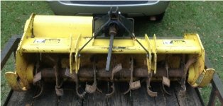

It's a Model 48 Tiller and fits the JD 420 or JD 430 Garden Tractors.

What you have is the Model 35 tiller for a John Deere 400 Garden Tractor. The John Deere 400 had a weird pto speed of 840rpm. The later 300s, 420 and 430 all had 2000rpm rear ptos. So, the only thing the 35 will fit is a John Deere 400. That is, unless you change the gearbox on the tiller. That would not be cheap. If the 400 pto is like the later ones, it turns opposite the standard 540 systems. They are heavy duty tillers. I have a 48 for my 332.
